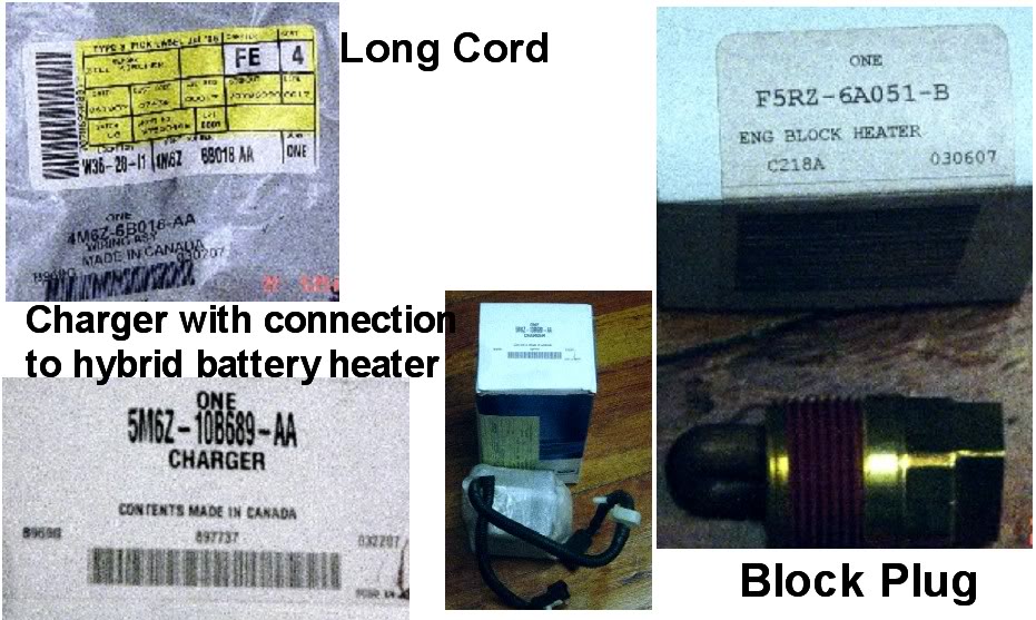

This is the parts installed in my FEH:

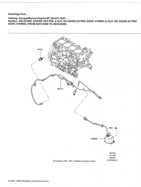

The diagram by Lone Ranger in #78 is helpful.
Just note, you are looking at the back, or firewall side of the engine facing you. This is not a point of view you are used to.
The big blocky thing at the lower-right on the drawing is the 120v AC to 24v DC transformer for the battery heater. It is located on the passenger side, near the windshield washer fluid tank.
The cables go over the top of the engine, top of radiator, and down the front of the car between the radiator and the plastic grille. The plug should end near the front license plate.
