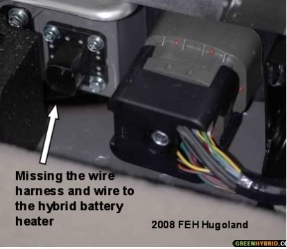

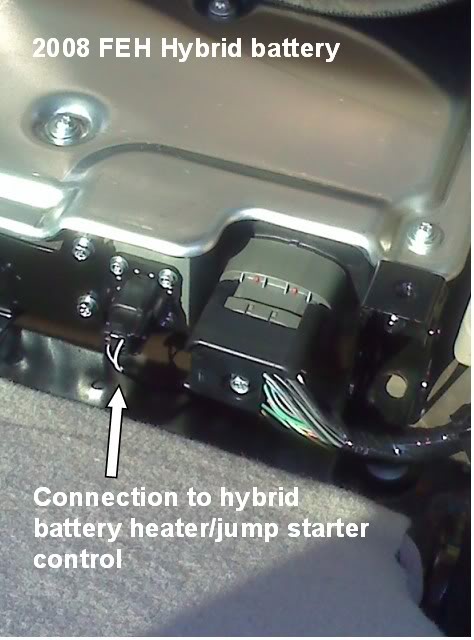

Is this the only way (and best way) to get an engine block heater on the FEH? I have a 2008 and am looking to install one. I just don't know if it is worth it when morning temps in the winter months only get into the low 30s and high 20s.
Please pull the carpet from your cargo area and look to see if you have a connection to the hybrid battery heaters:
This 2008 vehicle does not have the connection:

This 2008 FEH does have the connection:

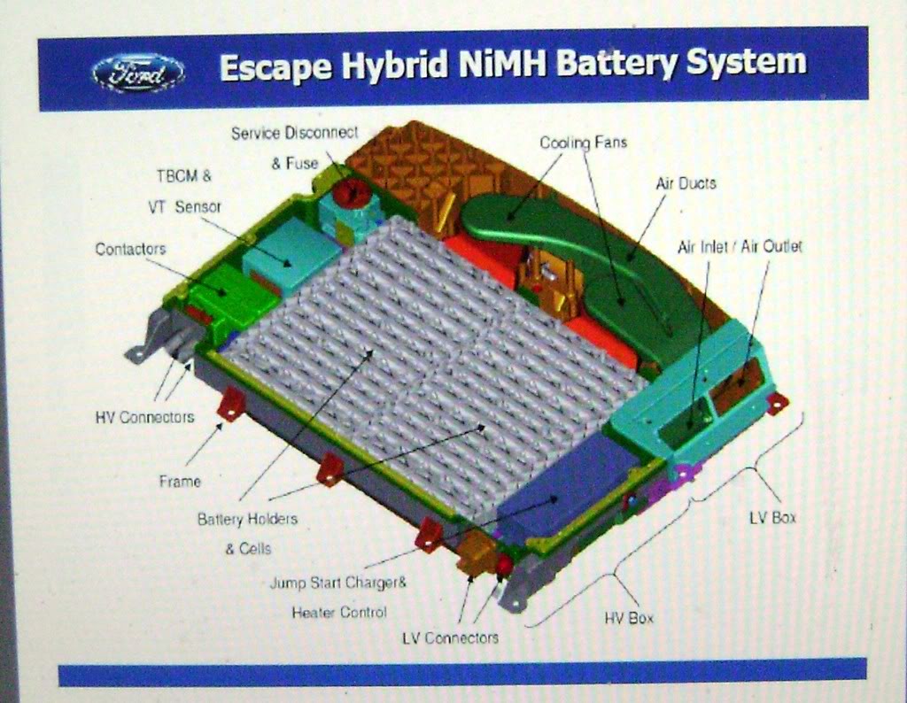

This is the internal view of the hybrid battery:
Hope this helps.
