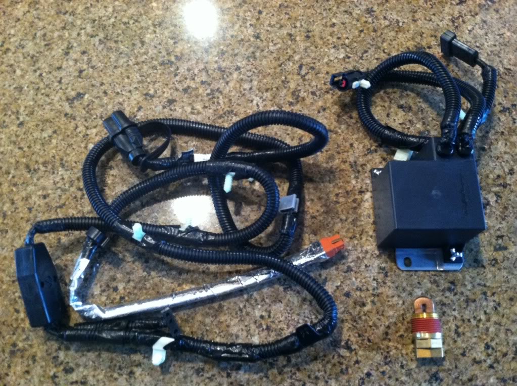

For reference, here is a picture of the three components:
