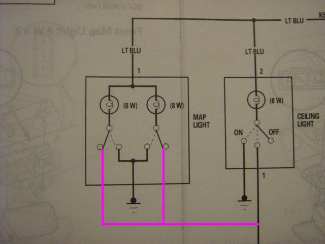

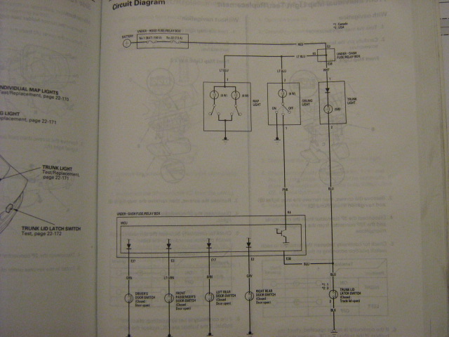

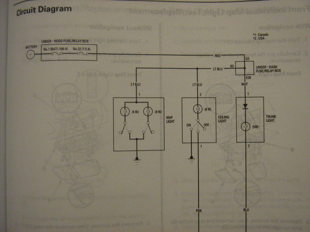

I am also going to add an "upgrade" to your upgrade. I'd like the map lights to also light up and "theater light dim" in concert with the dome lamp.
Note the 3 attached photos...Another DIY: Honda Homelink-img_9626.jpgAnother DIY: Honda Homelink-img_9625.jpgAnother DIY: Honda Homelink-img_9627withmod.jpg
As detailed in the last picture, I'm going to tap the map lights "off position" into the ceiling light "pink" ground wire....

I have completed the map light/dome light interconnection modification alluded to above. I shall start a new thread to explain same.
