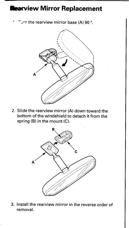

The following describes how to remove/replace the factory mirror:
DIY: GENTEX MIRROR for Homelink-rearview_mirror_removal.jpg

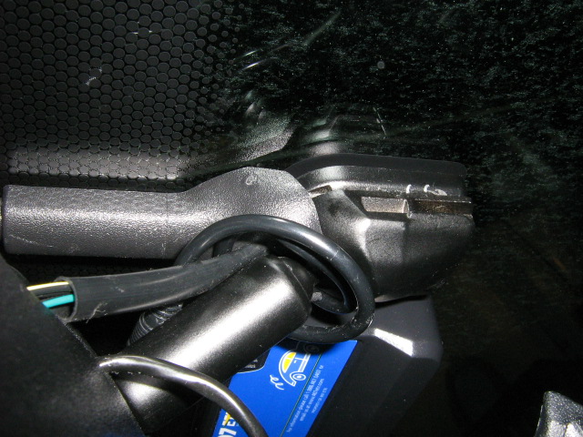

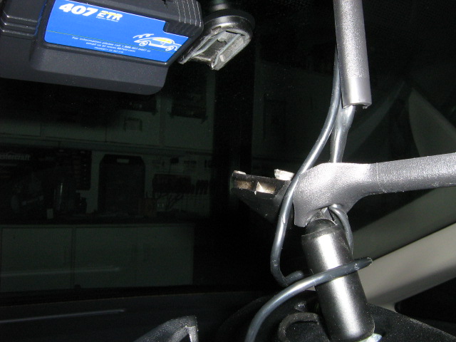

My hold-up is how do I remove the existing auto-dimming mirror (i.e. what is the magic trick?). I just cannot get my unit to loosen without risk of damage, so I need the trick to somehow "unlock" my mirror from the windscreen.

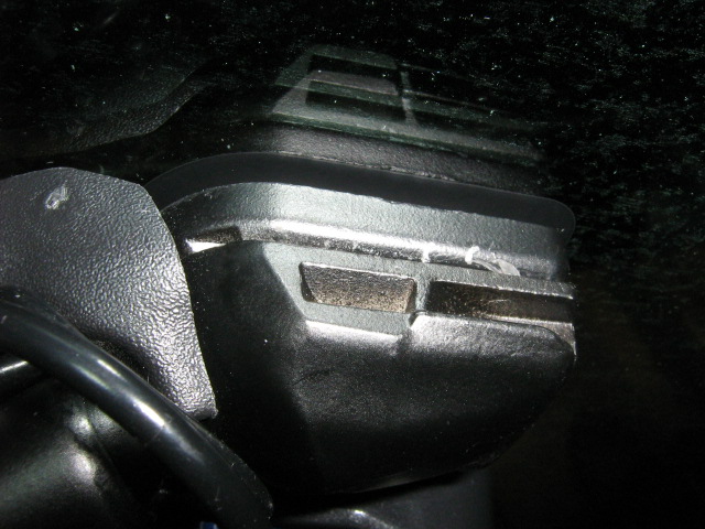

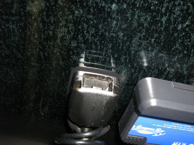

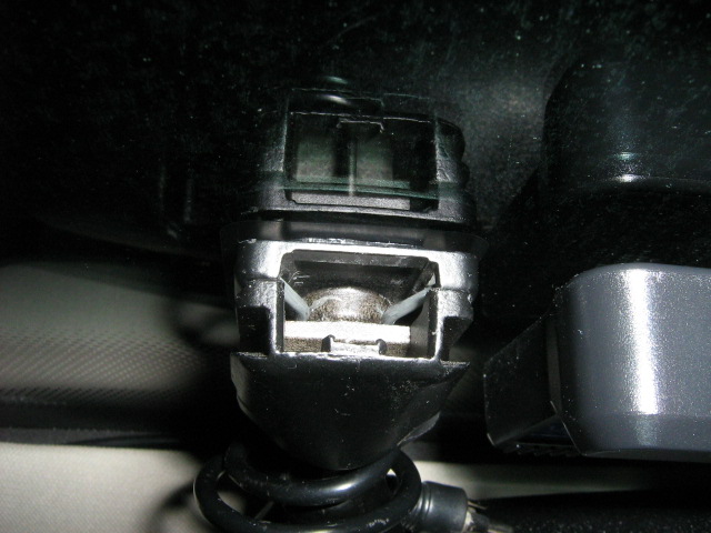

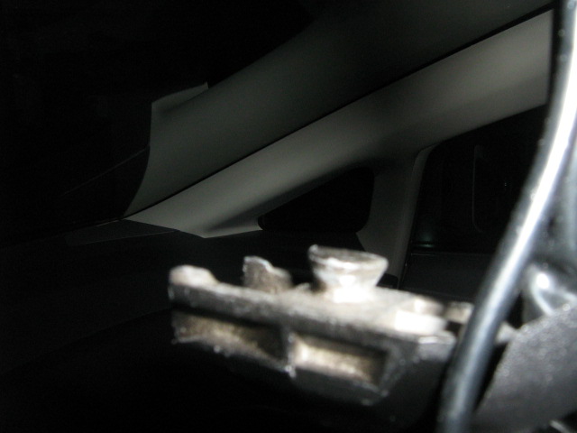

These are close-up shots of what I believe is a cam-lock of the mirror I now have. The 2 wires you also see in the photos: Wire 1 is for the "external to this mirror" compass sensor. Wire 2 is what feeds power to my GPS....
Attachment 1361

page 3 of these instructions show how to turn the mirror to get it off you will need to remove the black wire cover from the roof to the mirror first - it pushes up from the window mount.
http://www.handa-accessories.com/civ...bridmirror.pdf.

Did you do a close-up check of the 4 photos of the mounting used for my auto-dimming mirror? Does this mean all I have to do is turn my auto-dimming mirror 90 degrees and it will come out?
I have tried to turn this thing and it just does not want to move. Any chance my auto-dimming mirror was somehow "slid" on from the bottom?
Again, I apologize for being obtuse, but I don't want to break anything
Mike

Just unplug the mirror wires and remove the black cover and then turn the mirror 90 degrees like the pictures in the instructions show and it will move and not break the mount. The wires have to be moved out of the way first on the autodim mirror. The wire cover usually can be just pulled up by hand.

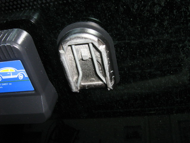

Well, I just went and did a "Give'er". We lived.
OK, here are the after pictures:
DIY: GENTEX MIRROR for Homelink-img_9711.jpg
DIY: GENTEX MIRROR for Homelink-img_9712.jpg
DIY: GENTEX MIRROR for Homelink-img_9713.jpg
Now my next question: the chap selling the mirror I'm looking at says I need a $10 wedge. Since I already have one of these Gentex mirrors, can I not simply "plug and play" the new one (mount wise)? Or do I need the widget you refer to here (from E-Bay)?

Honda mirrors use a unique mount and you need an adapter to fit the real gentex or donnelley mirror to the honda windshield - I had to get an adapter from wembleysells to attach my homelink mirror to the civic.
Theirs will allow the black wire cover to work with the new mirror.

Honda does not use the standard mirror mount that all homelink mirrors use - they use the honda mount - you can try to remove the mount from your current mirror and put it on you new mirror but it will droop down as once you remove it it becomes loose and there is no tightening it.
All homelink mirror use the Ford/GM/Nissan windshield mount which the Wemberlysales converter allows you to connect a Ford/GM/Nissan mirror base to a honda windshield. - honda turns 90 degrees to mount - the new mirror uses an allen screw to attach - not the same.
