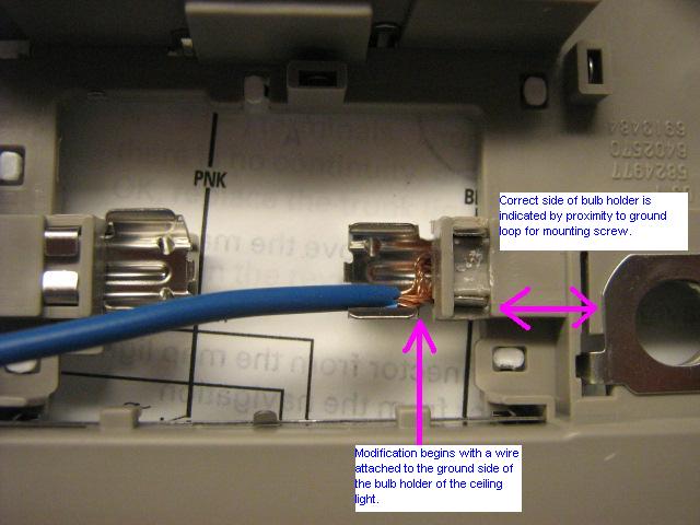

Step 4. Prepare the dome light assembly as depicted:
Another DIY: connect map lights to dome light-img_9630withmod.jpg
See photo above. The striped end of the wire (from step 3, above) will be attached to the GROUND side of the light bulb holder. The GROUND side of the light bulb holder can be identified by its relative proximity to the assembly ground loop around the mounting screw hole.
My technique for attachment was to unfold the 2 tabs holding the GROUND side light bulb holder to the plastic base. I then fed the wire between the metal of the bulb holder and the plastic base.

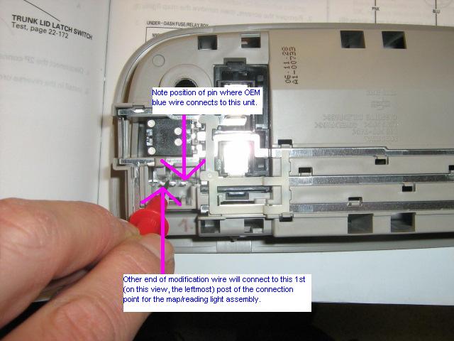

Another DIY: connect map lights to dome light-img_9637withmod.jpg
See photo above. Electrical testing confirmed that the modification wire must attach to the first pin on the left in the depicted photo.

Very nice. An alternate method to connecting a wire to each bulb is to use the 3rd (unused) pin on the electrical connector to the map light assembly to run the ground lines.
The map light bezel is already set up for using the map lights as additional dome lights, all that is needed is to connect ground lines to the connector that plugs into the bezel.
