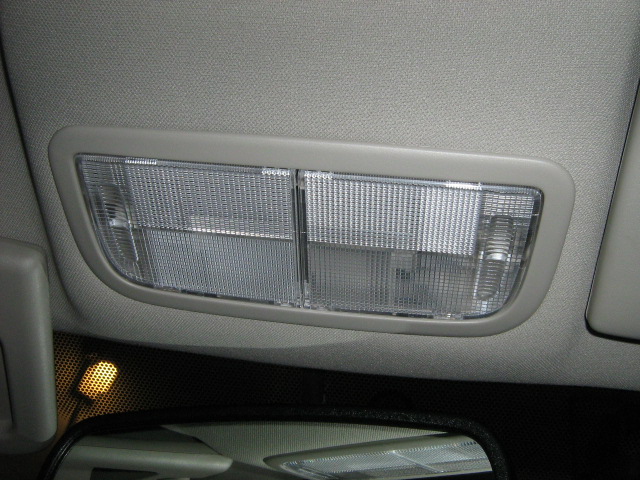

After reading this thread, I'm all primed to do this project. I took a photo of the map lights that I have.....
I have an '07 with the grey/silver headliner theme.
I do not have a built in Navi system (unavailable in Canada).
Q1: How do I pop off those lenses?
Q2: Since I need not worry about a NAVI Mic, is all that is required is 12V and ground and a connection to the headlamp system (for the LED)?
Q3: Will any recent (2005?-today) Honda Homelink module fit into my 2007 map light unit (please see photo)?
Much thanks

Old Nov 10, 2009 | 09:05 AM
  #36
Default Re: Another DIY: Honda Homelink
to answer your questions, the homelink modules are pretty much the same. The one I got came from an Odyssey.
To remove the lenses, simply stick a thin screwdriver between the lens and the bezel at the pivot point, and pop out the lens. The instructions for this should be in your owners manual.
I'm not sure if the bezel from your light will accommodate a homelink module, once you have the lenses off, you can see if there is a cavity in the center of the bezel that will fit the module.
Old Nov 10, 2009 | 04:51 PM
  #37
navguy12's Avatar
Joined: Nov 2009
Posts: 210
Thanks. I got the lenses off. The center has some thin walls running thru it (not a show stopper), but...
Looking at the nibs that hold the full length lenses in place, the pattern is different than the photo on page 1 of this thread. Bottom line, I'd have to buy a map light frame as well as the 2 smaller lenses. Something to shop around for....
Old Nov 10, 2009 | 05:25 PM
  #38
Yes the base is a different P/N for Navi and non-navi interior lights. A Navi interior light base is $24 and the lenses are $5 for the pair. All you need to add is a homelink module like this one for a $100. Once you have the parts, just follow my install DIY, and you are Golden.
Old Nov 11, 2009 | 06:47 AM
  #39
navguy12's Avatar
Joined: Nov 2009
Posts: 210
OK, looks very straightforward. Too bad the E-Bay link item does not ship to Canada, or I'd be there in a flash.
As for the Navi interior light base and 2 lenses, since these are not available in Canada, I'd have to buy these over the counter at a Honda dealer in the states. Having said that, can you confirm the correct part numbers for the light base and lenses please?
Much thanks
Cheers
Mike
Old Nov 11, 2009 | 07:46 AM
  #40
I'm not sure what color of bezel is used with a grey headliner, so here are both parts numbers.
Interior light base
34404-SNA-A31ZB BASE *YR327L* TAUPE/IVORY
34404-SNA-A31ZD BASE *NH556L*BLUE
Lenses
34401-SDA-A21 LENS, R.
34402-SDA-A21 LENS, L.
In addition here is a mail order parts dealer that might ship to Canada.
