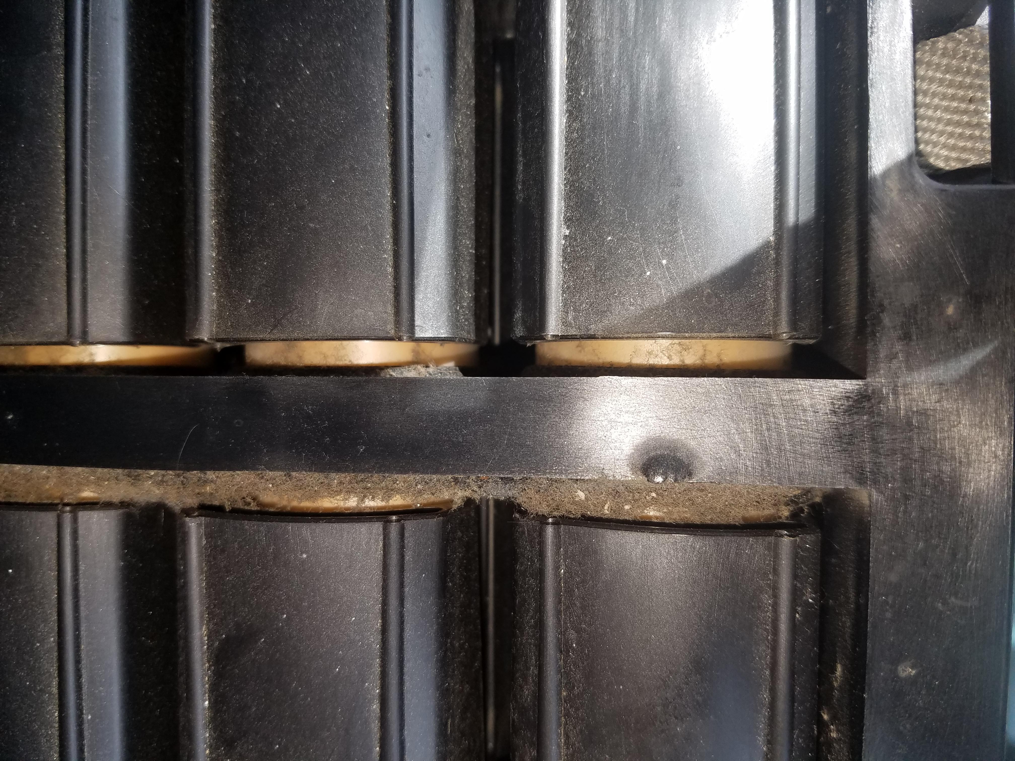

Yellow
Attached Thumbnails Resurrecting a 15 year old, 4 month out of service battery pack!-1505231551881420054257.jpg
Old Sep 12, 2017 | 08:54 AM
  #73
Posts: 5,222
Default Re: Resurrecting a 15 year old, 4 month out of service battery pack!
Most Chinese sticks are green. IIRC, king kong uses blue. I'm nearly convinced you're seeing orange through translucent white, which gives it a pink hue.
I recommend discipline in this situation. I assume you want to do this as infrequently as possible - conduct exactly the same reconditioning cycles and testing you did on pack B.
IIRC, you only did one cycle on this pack due to time constraints.
Old Sep 12, 2017 | 08:55 AM
  #74
Posts: 5,222
Given the grime I see in that picture, I recommend you blast the pack with compressed air.
