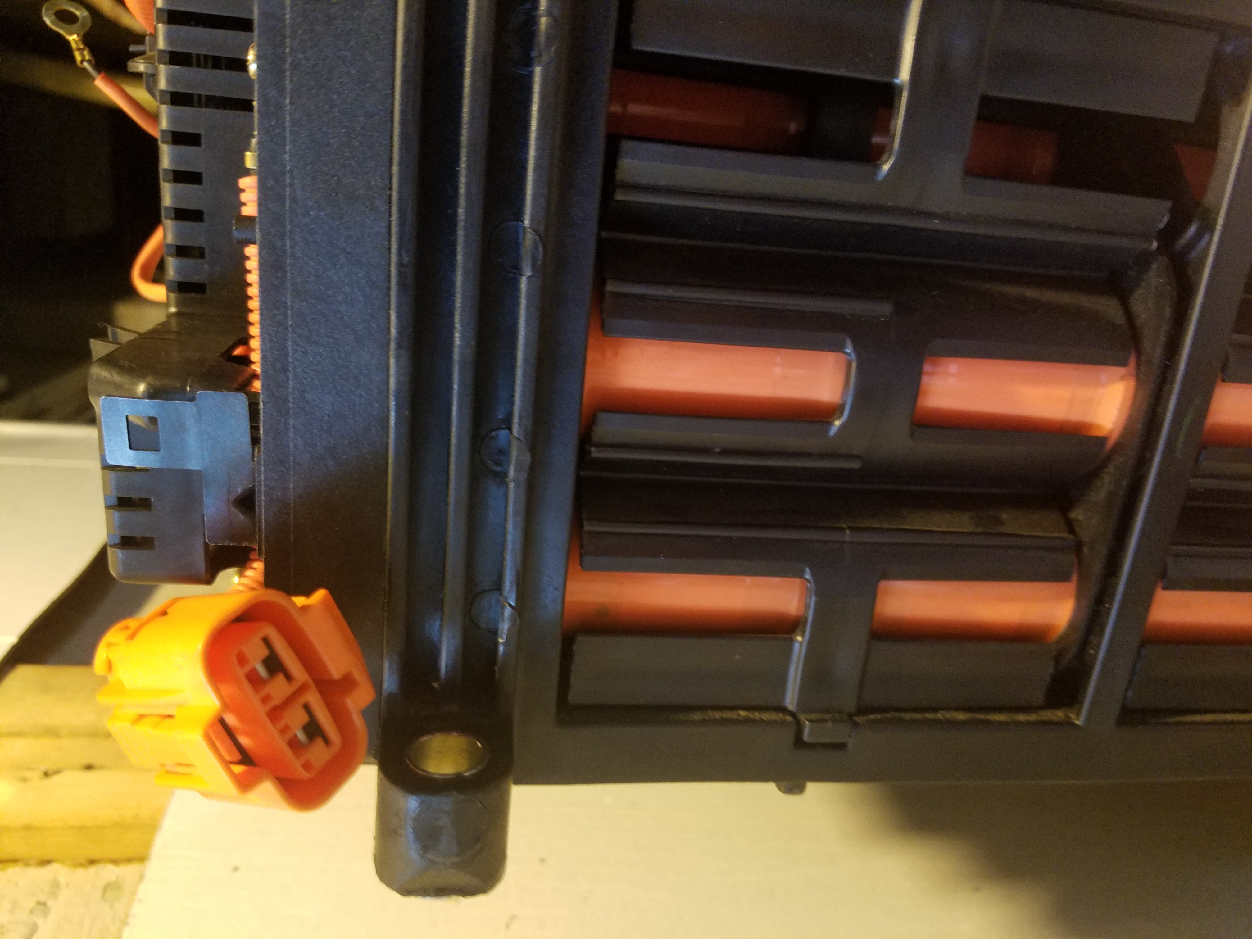

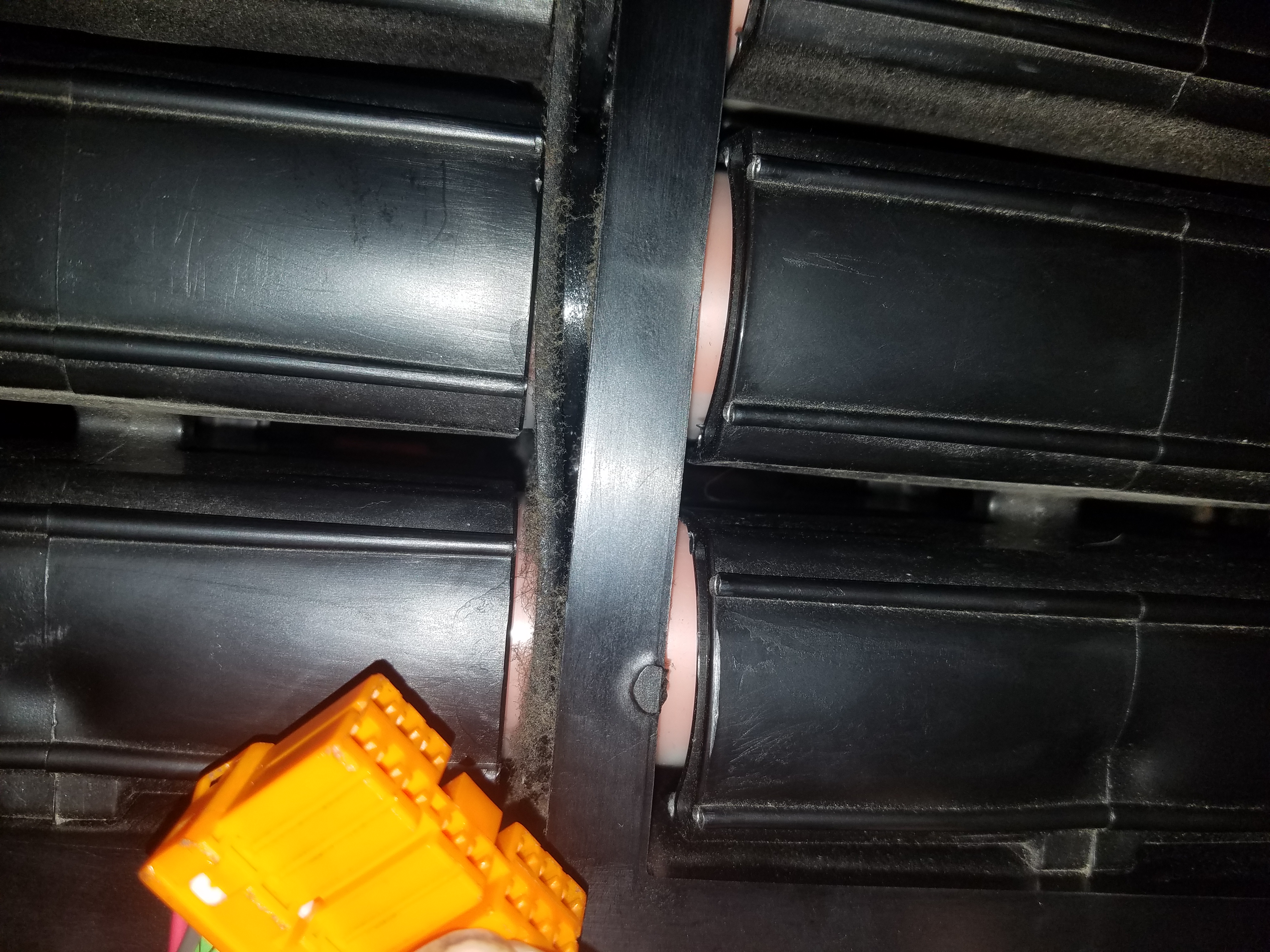

This is concerning... I really thought that other idiot who had the car before me just grid charged and called it a day...
I got like a pink set of sticks on one side and orange on the other in pack A
before i thought it was a heat shield or something obscuring the view of the sticks.
I got volt taps all over mostly 13+/-2. And one at 8.
Considering just disassemble this and checking resting volts to find the obvious dead one and load test the ones sitting at 7+
other pack sat a month after grid, this one probably sat a month in car unused.

pictures please.

Pictures with known orange items for contrast.
Couldn't find the manage attachment button on the mobile site, had to refresh desktop view
Attached Thumbnails Resurrecting a 15 year old, 4 month out of service battery pack!-15052304133821147579006.jpg   Resurrecting a 15 year old, 4 month out of service battery pack!-15052304302351230428080.jpg

Both of those look "orangish" to me.
Orange sticks were originally used in the Insights and are generally accepted to have higher internal resistance by design when compared to the typical yellow HCH1 sticks. I have seen them mixed and matched on several occasions.
There are translucent plastic tubes over the 3 sticks at the top of the pack when installed. They may make orange look pink.
You're about to see another of those occasions.
The second photo sticks looks rose colored IRL. What color does king Kong use?
