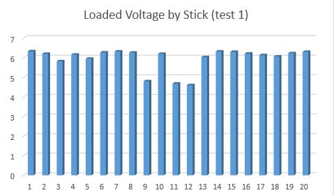

FYI, my numbering scheme for these is as follows:
From the right side (without all the components), where the empty slot is I numbered 0. The colorful graph shows how I numbered.
Wow, if not for the 6.2 under the 5.82 I would say obviously this thing wasn't cooled well enough!
Now I'm very curious to load test the one in the car...after I rehab it from it sitting. Looks like I got 10 here above 6.2V

I find the graphical depiction very useful. Even at a glance you can see the 3 stick out like a sore thumb. By narrowing the vertical axis to a minimum of 3 or 4V, other sticks start to look like outliers. Those are the ones that need a little more scrutiny.
3, 5, 13, 17 and 18 likely require some scrutiny. If their intrastick cells have no more voltage deviations than the strongest sticks, they are likely suitable for use. This can be delayed until after you've reassembled and grid-charged the pack as intrastick imbalance after a couple of weeks of driving is going to be more telling than after a 7 day rest and load test.
I think it's fairly safe to say that 9, 11 and 12 were what took this pack out of service.
Reassemble, grid charge and swap it out with pack A. Repeat everything you did to pack B on pack A. In the end, you may have enough good sticks that you don't have to worry about intrastick cell measurements.
