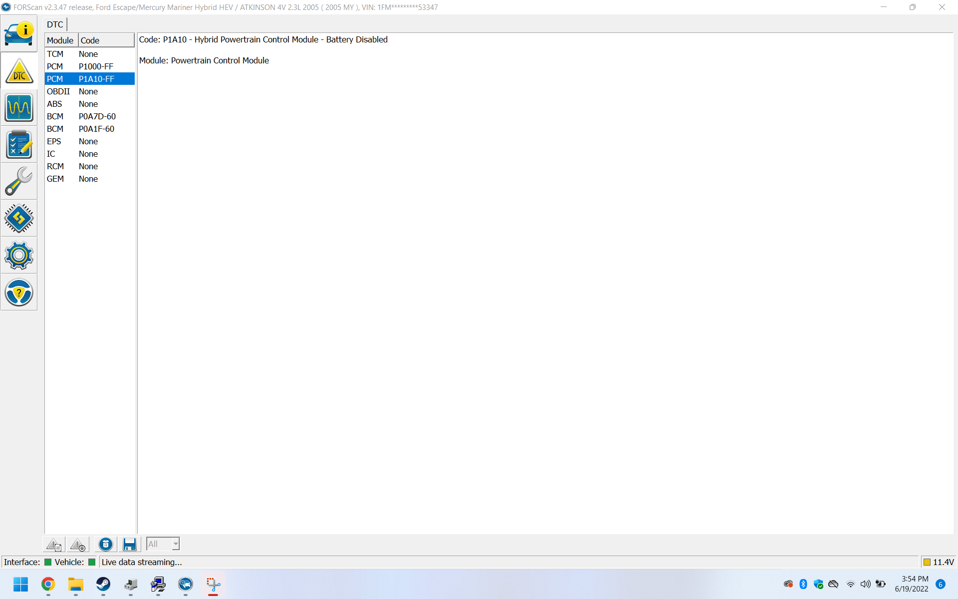

Question though. Is there any hope for my 2005 Ford Escape?
Old Jun 19, 2022 | 08:44 PM
  #264
Default Re: HV Battery Jump
DEL_MOD_V of 1.75 is potentially discouraging, but your voltage is way too low.
Jump start the 12V the traditional way with jumper cables and the jump vehicle running. Use the HV jump starter with the jump vehicle running. Do it twice. The cycles are about 8 minutes each.
Attempt to start. If it starts, allow to run for up to 20 minutes or until SoC reads > 40%.
If your A/C isn't working perfectly, you will need to fix it.
