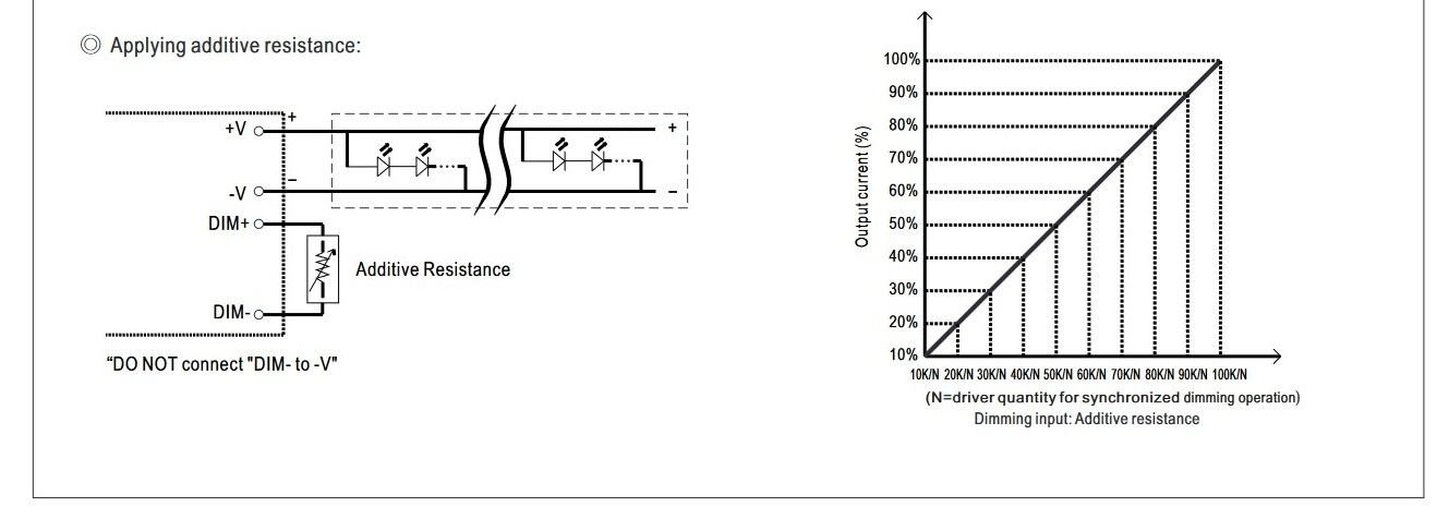

Keith,
Thank you for your reply.
I think there is something wrong with the multi-meter. I dial from zero (no current) then it rising up when I dial. After mid-point, the current was going down not as the manual showed that is should be up.
I used the following potentiometer at Amazon:
Amazon Amazon
I connected the Dim + and Dim - to 2 and 3 and ground to 1.
After connection, I did measure the resistent, it is from 0 to about 95kOmh.
But after I connect it to charge the battery. It is a weird bell curve not a line. And the maxiumum is only 33mA. I will measure again.
But the voltage is up. 30 mins it is 322, one hour it is 328, two hour it is 332.

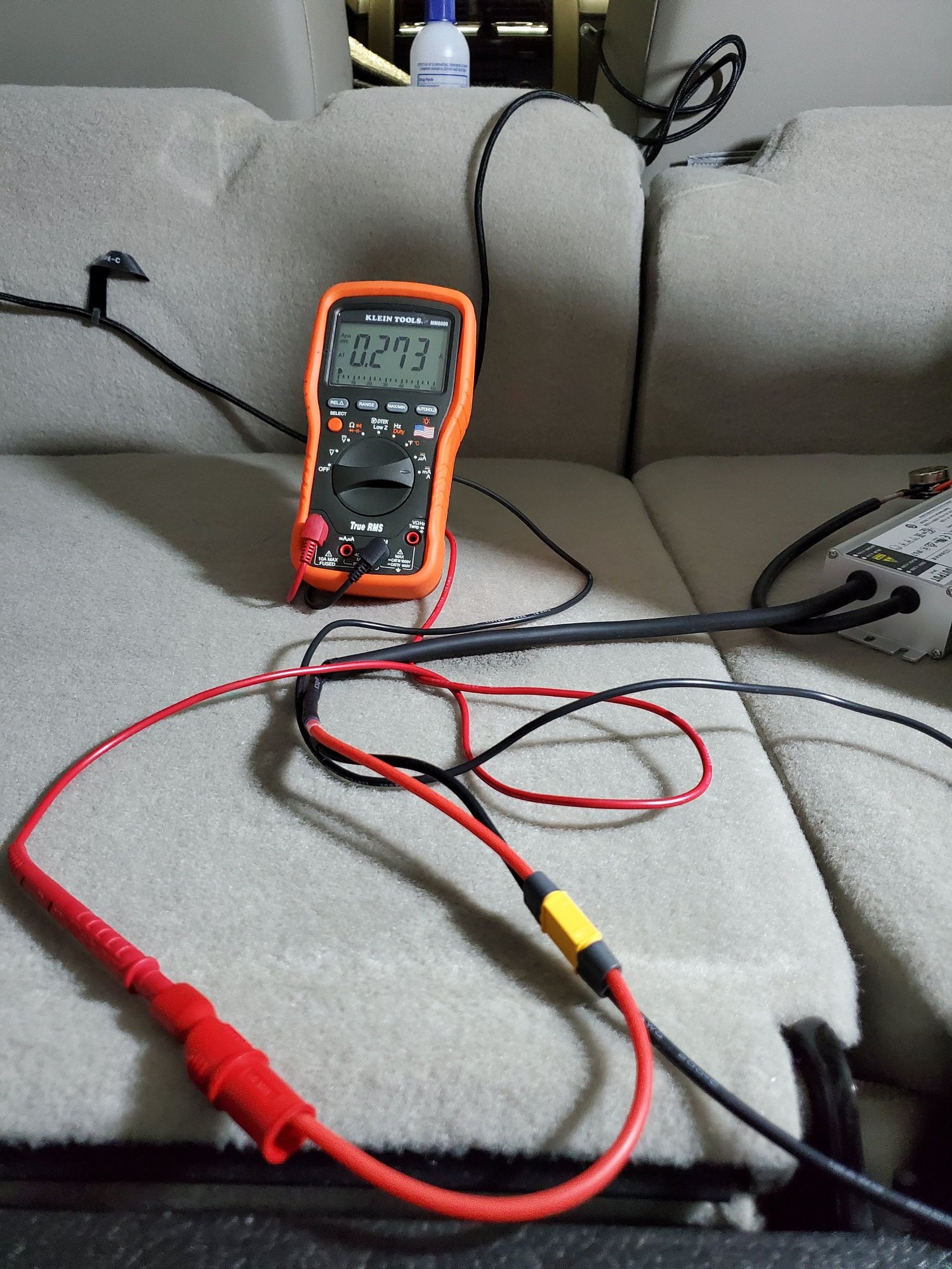

Keith,
My bad. When I relook the picture, I found it is measure the AC current not DC current. That explain everything. The sin curve of the maximum.
Now, I set it to DC, the maximum current is linear but not 350mA as it said, I dial all the way up, it is 273mA. So I guess I need 5.1h to reach 1400mAh.

I want to leave the multi-meter in but I later found out after certain time, the multi-meter will wen to sleep. So I must skip it but connect the charger to the harness directly. At least now I know it is charging. I am wondering if I just cut-out the potentiometer (resistance infinity), what will be the current.
Old Dec 8, 2021 | 07:29 PM
  #246
Default Re: HV Battery Jump
I believe we're dealing with user error. The multimeter is measuring AC current, hence the ~ on the display. DC is represented by a horizonal line with 3 dashes below it. I believe the orange button toggles between modes.
Given the rate of voltage increase, you are likely pushing the max power. I believe if you leave those pins disconnected, you get infinite resistance and thus max current.
I just cut the potentiometer and the current went up to 365mA. So the potentiometer is not useful. Now I can use less time. I hope this will not overheat the battery. I did put a fan to blow it.
