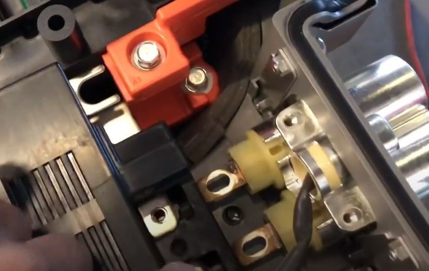

Default Re: HV Battery Jump
If you've put the relay cover back on, then I've got nothing for you besides cutting in to the charger wires on the battery side of the diode to check voltage. Exercise extreme caution if you do this.
It might be best for you to just use Forscan with ignition on (no start). You will see voltage, but the current number won't be accurate/meaningful.
Would the prongs that are attached to the high voltage plug on the right side of the battery at the back of the relay be a good voltage testing point? The ones that look kind of tarnished in this photo. Those must be hot while the service plug and relay are in right?
Old Nov 15, 2021 | 08:06 AM
  #230
