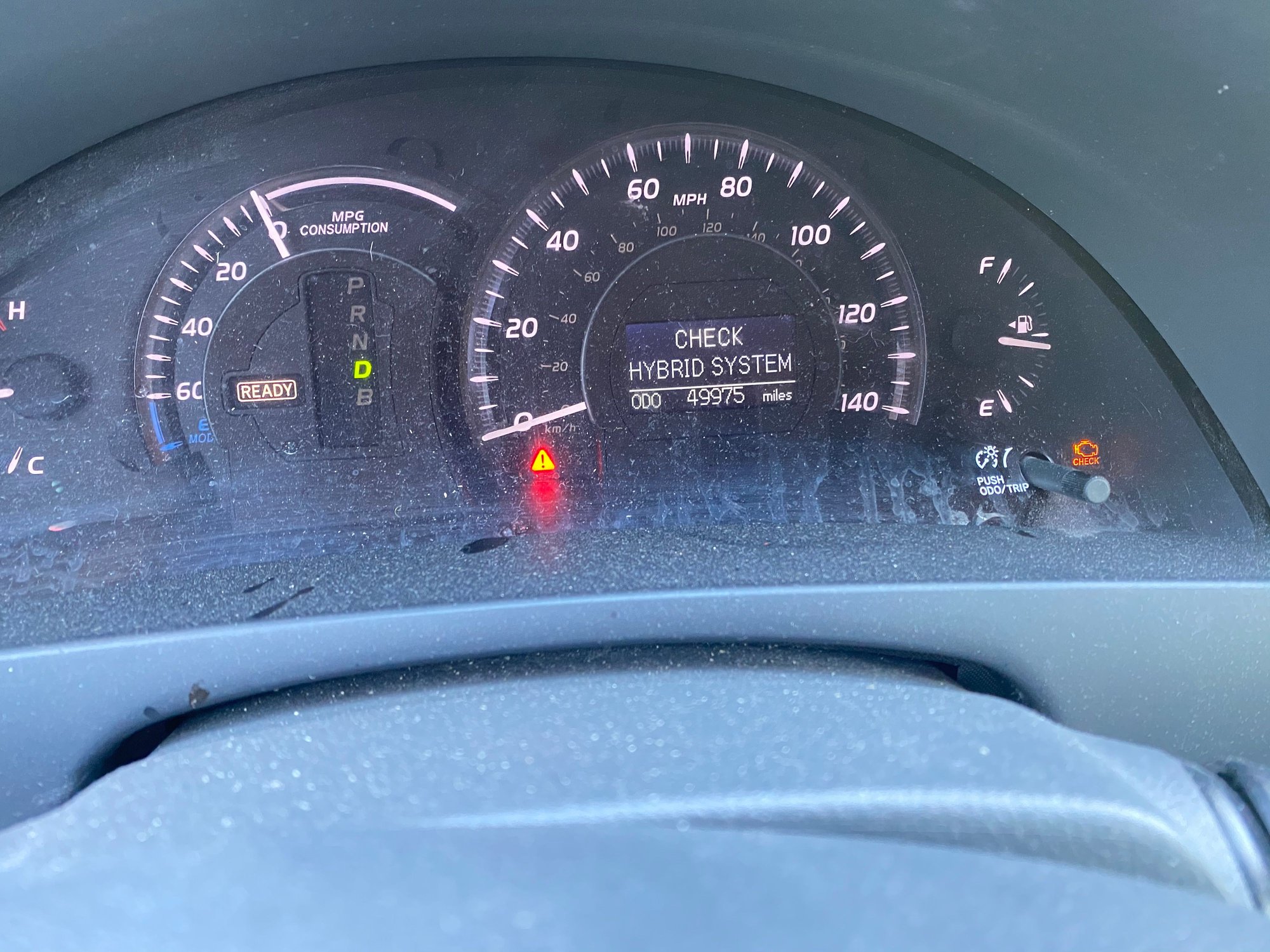

07 TCH warning lights, what to do?

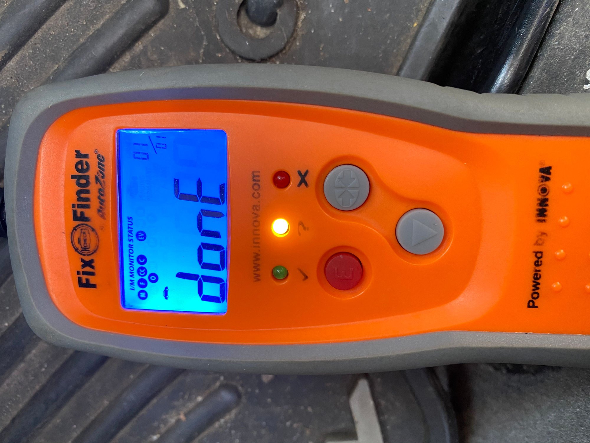

Update:” I just went to Autozone store. They lent me a code checker and taught me how to use it. I took a pic of what I saw and the print out they gave me ” Pls check below
I still don’t see the warning lights on today . I am in Chicago Illinois thanks. Do I have to have the warning lights current and on to be able to detect the problem with the code checker? It came on few days ago but the lights didn’t come on yesterday . I will drive now and check if the lights or cooling fan sound comes on in the back.
