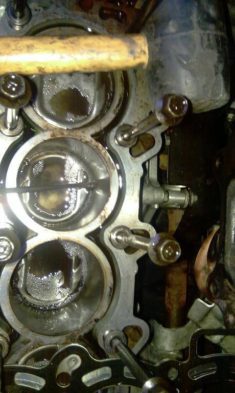

Just recently. i change the Exhaust valve. it had a Hole on the #2 Cylinder Valves.

Thanks for the excellent pictures and letting us know about this problem. First valve issue that I am aware of? Hope your FE improves. I am sure it will. Did you purchase from a Dealer? Looks like something dropped into the top end if that is possible? H

Indeed it does and looks like that valve was running like that for quite some time according to the erosion around the hole. I'd say there was a small crack in the valve and it eventually became that ugly hole after a few thousand miles. With over 2k moving parts, something's gotta give eventually. Sorry yours was only at 132k miles though =(
