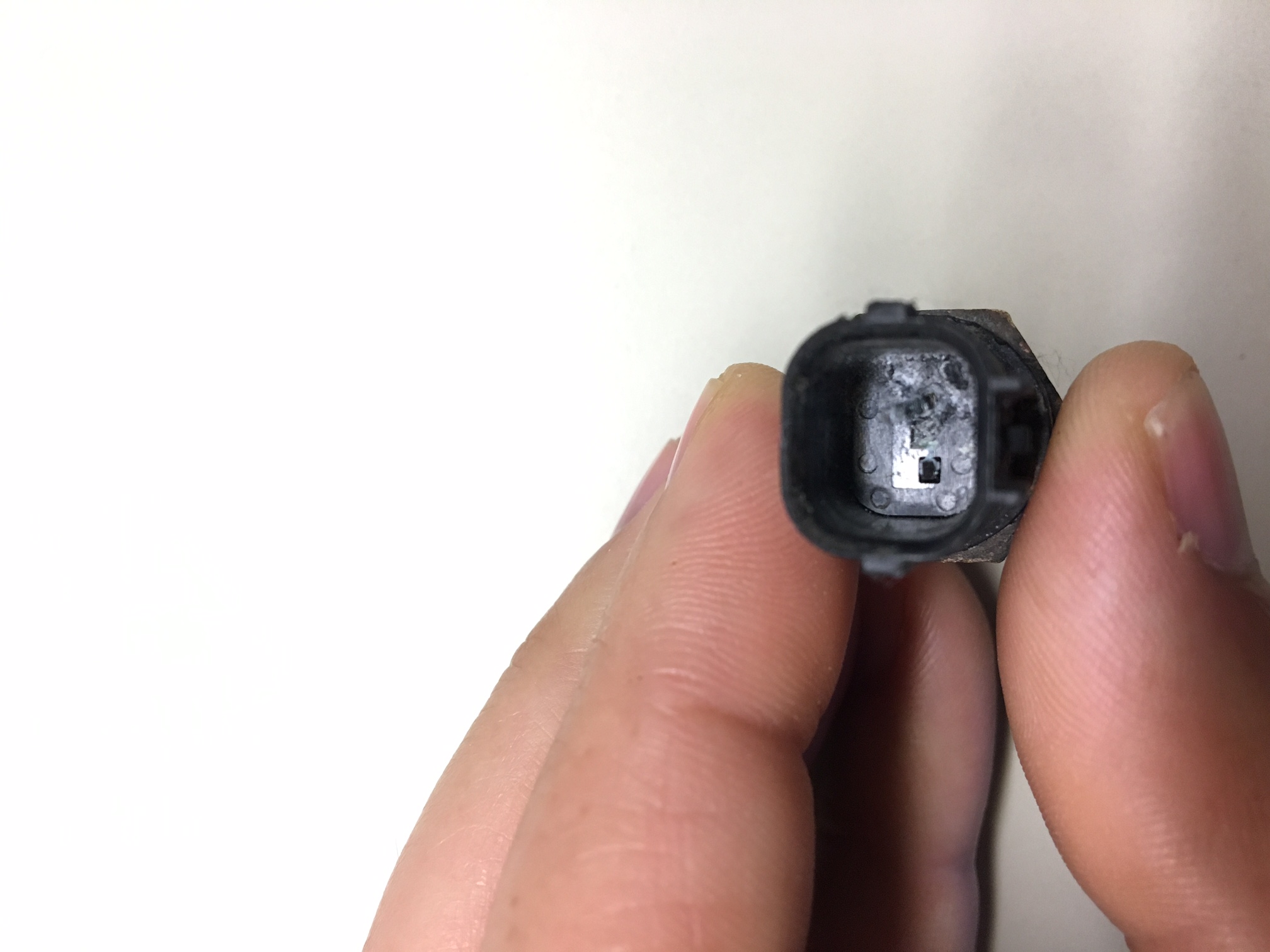

Its running good for almost a week now. Had the coolant changed and a new sensor put in under the radiator. Old one had a broken & corroded pin. The mechanic I use said he drained the coolant and replaced the sensor. I left him 2 gallons of coolant but he only needed 3/4 of a gallon to fill it back up he said. Is that normal? I did add some more to the reservoir to get between the min & max level when i got home.

Default Re: Engine Hesitation around 3000RPM - HCH II 2006
That certainly looks like your problem.
Cooling system capacity is 1.25 gal
Reservoir capacity is 0.11 gal
I would ask him why he only needed 0.75 gallons given the above.
