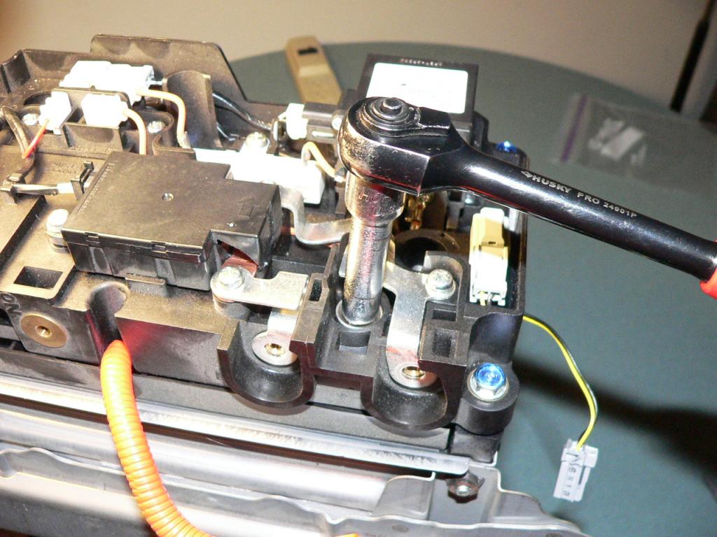

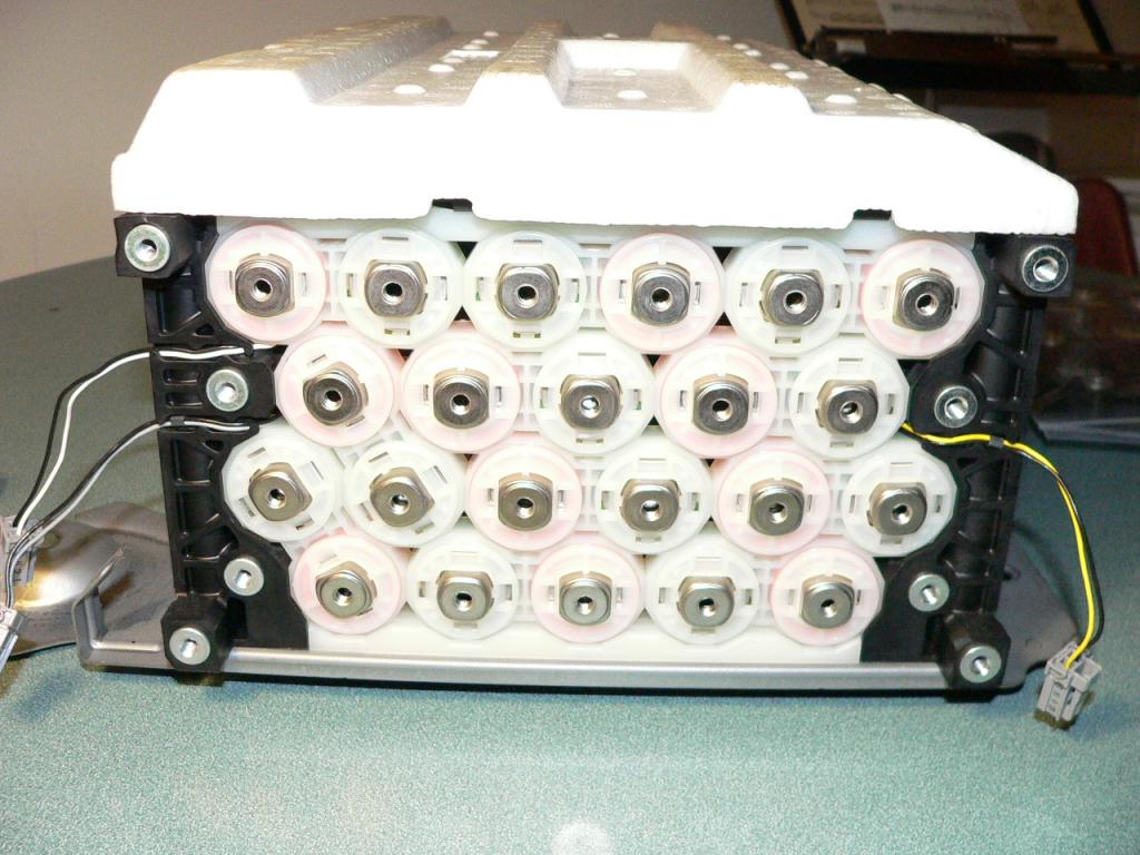

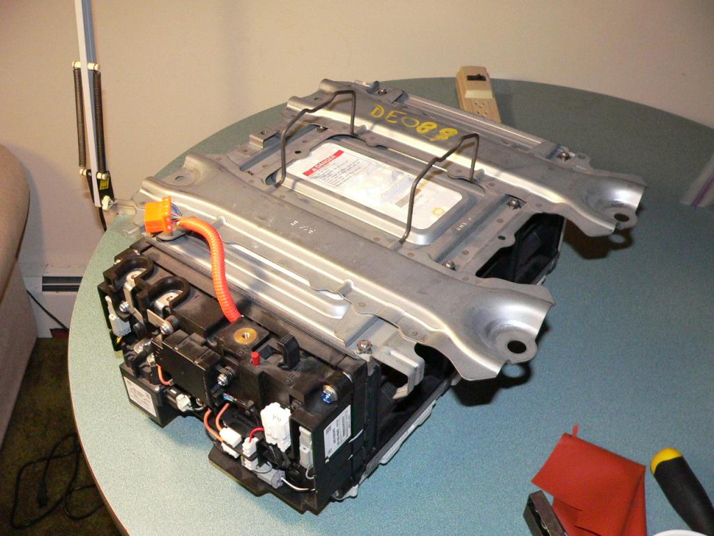

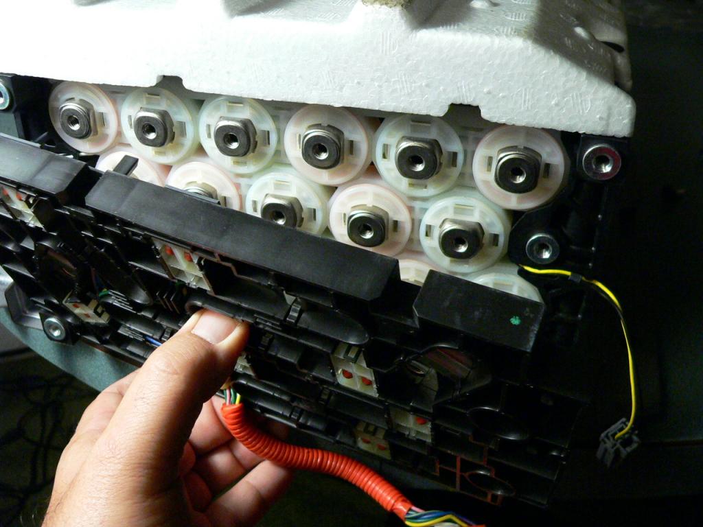

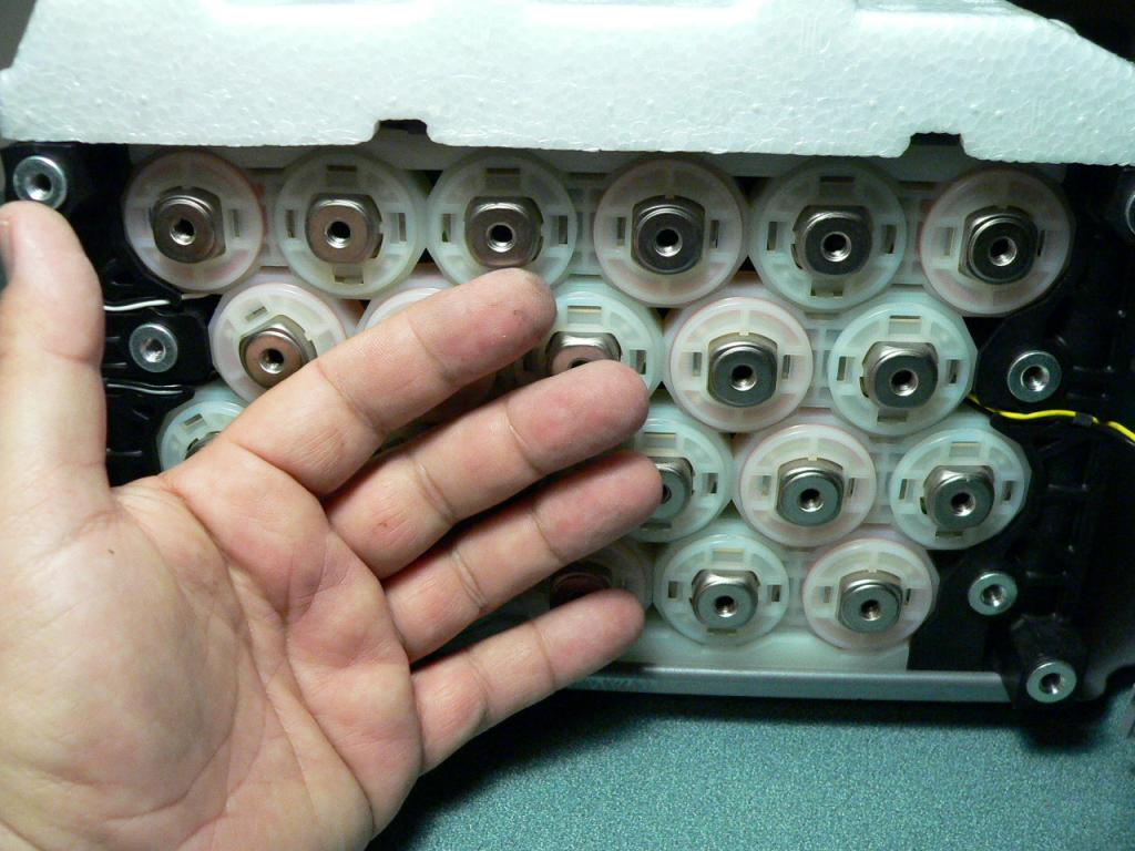

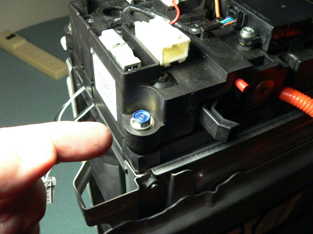

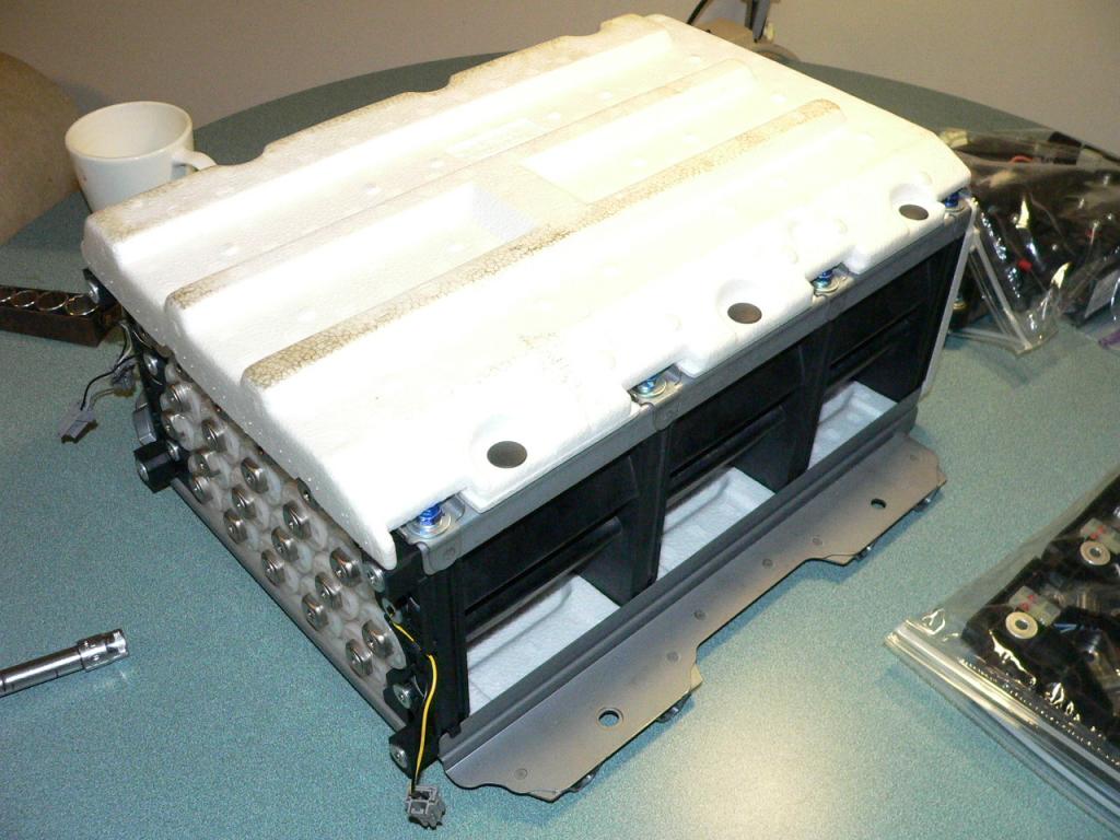

Styrofoam on. Note, the pack is still very safe to touch.

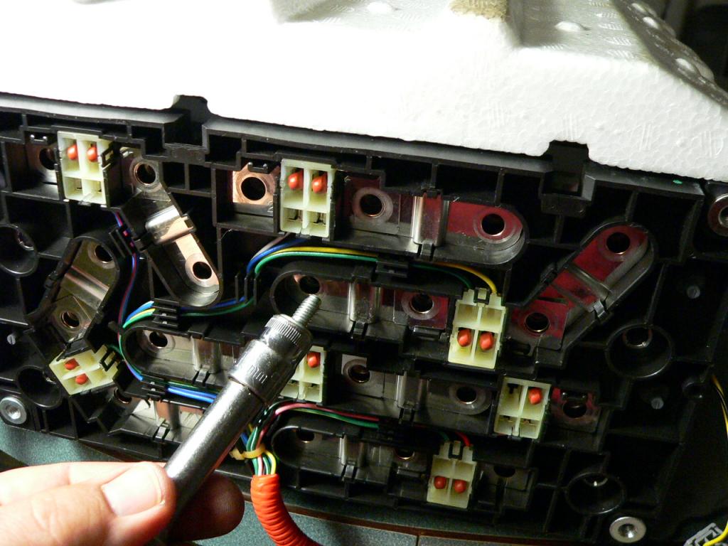

The next component changes the game a bit. This is where we start connecting the batteries together with this "hat" assembly. I'm not touching two metal components at the same time any more. I'm using a socket wrench that is un-insulated. I don't recommend it. To be sure, I am very careful as I bolt each battery to the assembly.

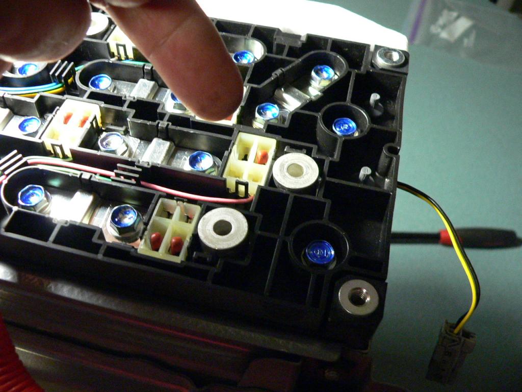

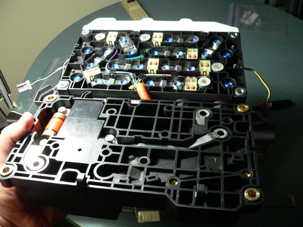

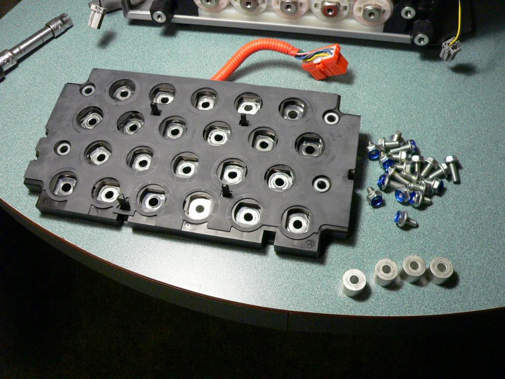

The hat going on. Checking wires so that they aren't pinched. I flipped the pack up on end to make it easier to bolt up.

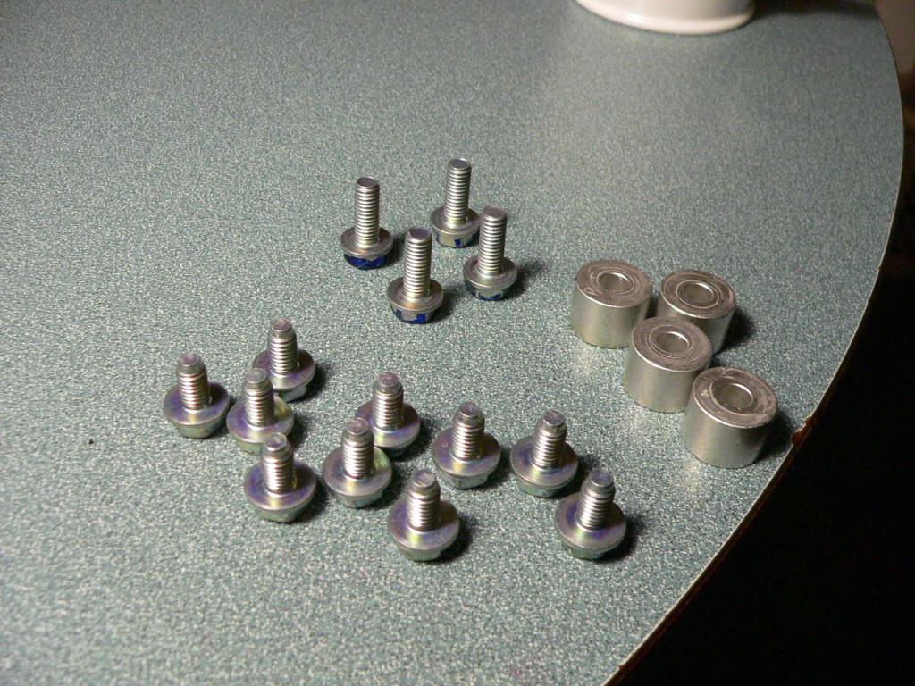

I checked and double-checked the bolts to be sure they were tight. Electricity doesn't like loose things! Aluminum spacers have to go in... four of them. Then the hat gets a hat. A second hat assembly lines up over the first. Four bolts around.

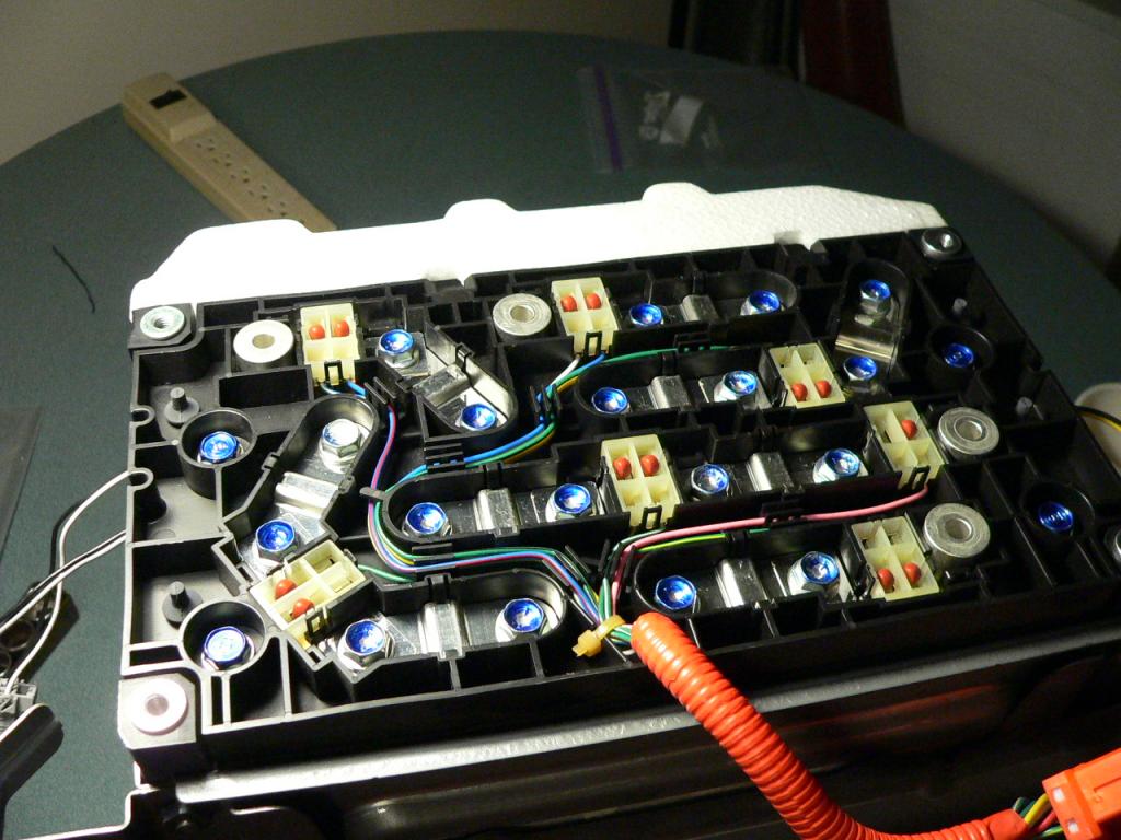

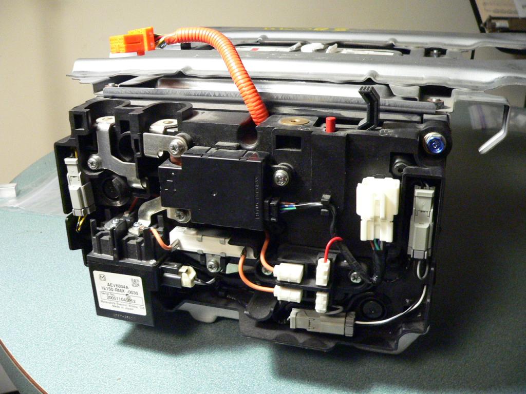

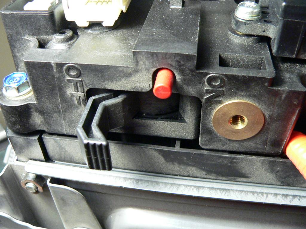

I forgot to mention the switch above. The switch should remain off while working on the pack. It splits the pack voltage, basically putting a disconnect halfway through the pack. It doesn't guarantee you won't get shocked but it helps. I'm still very aware of the danger of electrocution here. No desire to test it.

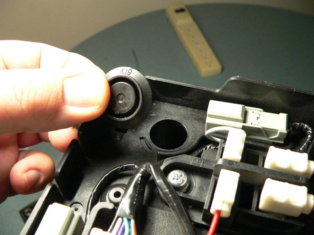

Next we are bolting up the electrodes. There are two in particular that make me cautious because Honda took the time to put caps over the holes. I don't know about you, but that sends a signal to me. Extra care required. Let's not touch anything while we bolt that one down.

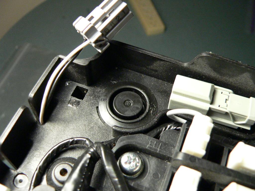

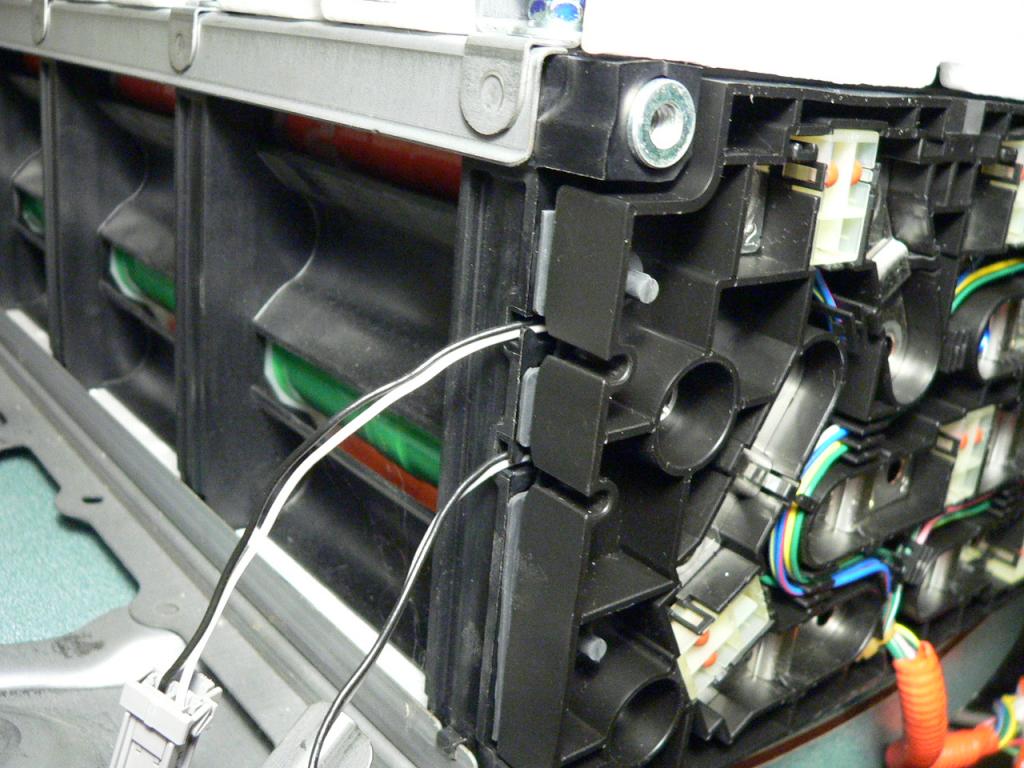

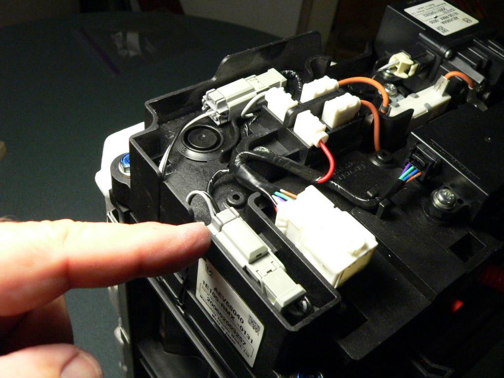

Don't forget to hook up those temperature sensors. Nice grooves in the plastic hat assemblies to run the wires through. Very clean and neat.
Pack complete!
