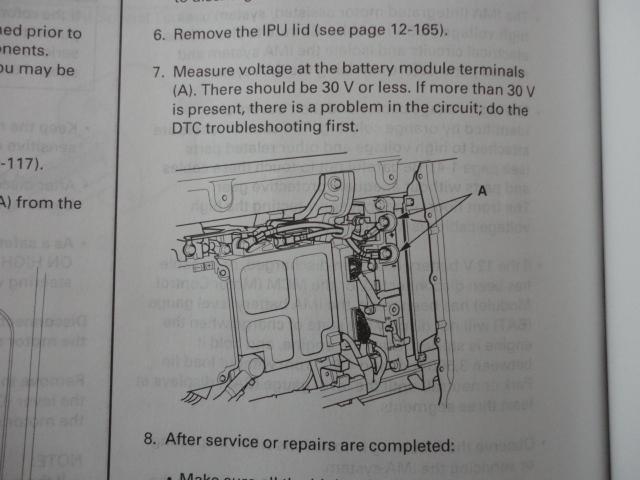

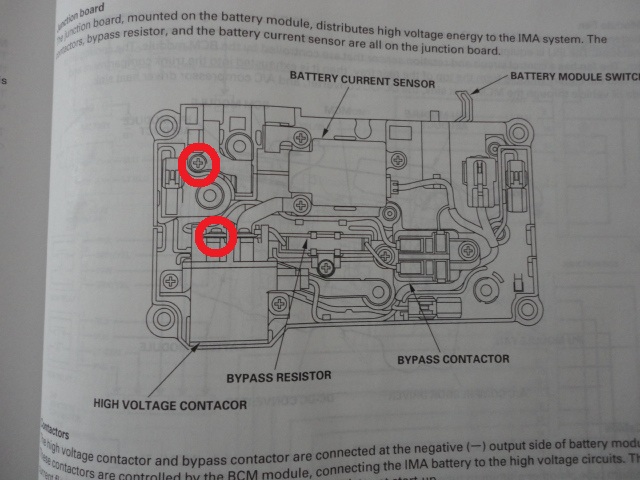

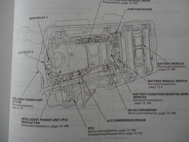

Ross:
I also have a picture of a couple of wires in my hand with red electrical tape over the ends. This is an external connection I made to the battery pack that allows me to trickle charge the battery from a charger I built. It's a very slowwww charge that should not hurt the battery pack but allows me to do a full charge and hopefully balance the pack. More on that later.
Your addition of the 2 wires with diodes has piqued my interest (for long term battery health).
I'll not touch my IMA system until it if off warranty, which based on my driving habits will be in about 14 months (at 130,000 kms).
Then, I would like to become familiar enough with your set-up and with your experiences with same to hook something up as well...
I have a couple of shots of the cable I made to charge the pack. It's wrapped in spiral wire-wrap for an extra layer of safety. The closeup shows the connection to the battery terminals. These terminals have full pack voltage even with the car key off. It allows me to trickle charge the pack. Also note the bulges in the shrink wrap next to the connections. I have two diodes in series with the connections. Diodes are like one way check-valves for electricity. They allow electricity to flow in one direction and not the other. As long as I feed a higher voltage into the pack than the pack voltage itself, I can push electrons (current) through the diodes. But the pack can't push current through the other way. That keeps the other ends of the wires safe (I wrapped them in electrical tape anyway) I intend to get a connector for the loose end. Someday.
Assume I know nothing about electronics, recharging, etc. Sounds like if one can 'trickle charge' the IMA battery when the car if 'off', one can add life to a used IMA battery.
First, to confirm where you connected your upgrade, I attached some shots out of the shop manual to clarify for myself:
The 3rd shot I have circled what I believe you have connected to.
No there aren't any fuses in the wires I attached to the pack. Just the two diodes. The diodes are power diodes and beefy with a breakdown voltage much higher than the pack voltages but I didn't put fuses in and probably should have. The trickle charger is limited to about 50ma of current so I could have used bell wire to do the job. I opted for rugged 12ga wire with a layer of spiral wrap for extra protection. That's actually why I don't have a connector on the end... nothing I had fit the dad-gum wire I picked! :-P
The diodes, or one way gates if you will.....do both 'gates' allow flow only to go from the charger to the IMA connectors? Again, I'm out of my depth on this one (perhaps a circuit diagram would clear things up?).
If one were to buy the units you used, could you identify them from this site please: http://ca.mouser.com/Search/Default.aspx
Since one will trickle charge a 158V Ni-MH battery with your upgrade, what sort of charger will you use?
Sorry for all the questions on a minor sidebar to you main project, but having the ability to 'balance' a used Ni-MH battery whilst it remains in the car (i.e. trickle charge over night, use car in day, etc) really sounds exciting.
Mike
Attached Thumbnails Battery refurbish in process - IMAX B6-dsc00045.jpg   Battery refurbish in process - IMAX B6-dsc00043.jpg   Battery refurbish in process - IMAX B6-dsc00044.jpg
