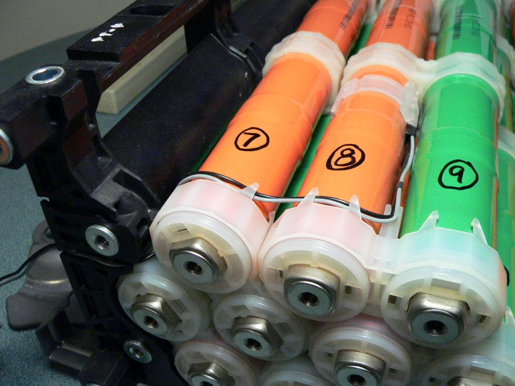

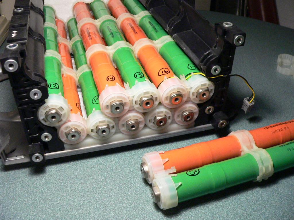

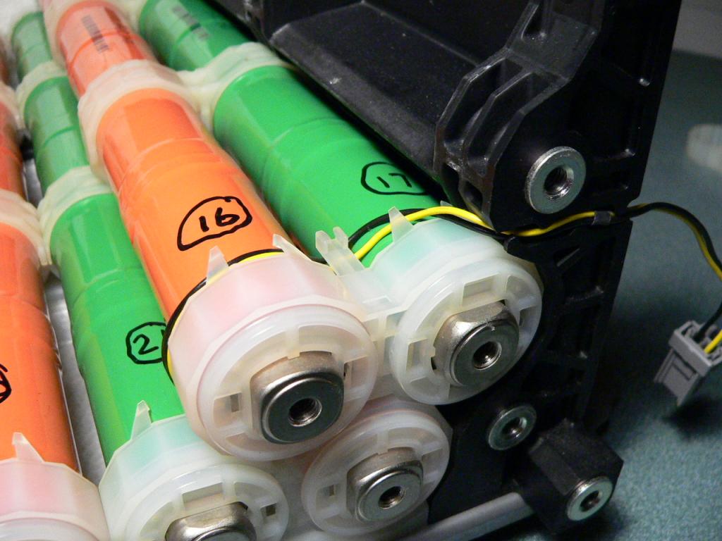

Ok! Lets start getting some pictures up!
The first picture shows an empty pack. This is what it looks like with the batteries removed.
Then we start putting in batteries. They stack in there filling one layer at a time. All tapped ends facing you. This is how the batteries are attached later. The pictures show how the temperature sensor wires are run to the outside to be connected later.
Each double stick of batteries makes 12 cells in series. Voltage adds in series so each 1.2 volt battery adds to the next giving a total of 14.4 volts.
Here's a quick electricity lesson: (I love to hear myself talk)
Voltage can be thought of like pressure. Pressure pushes water through a pipe, voltage pushes electrons through a wire. The higher the voltage, the more the pressure. Why do we need pressure? Because things resist the movement of these electrons. There is resistance in the wire and other electrical components just like there is resistance to flow of water in the pipe. The more voltage (pressure) you have, the more current (electrons, water) you can push through the wire (pipe).
So... current is how much. Current is the amount of electrons that pass through a conductor in a given space of time. The unit of current is the amp. Most all of our electrical appliances have labels that tell it's voltage and the current(amps) it requires.
Ok... that's enough. Now how can we apply this knowledge?
We (humans) resist the flow of electricity. But if enough voltage is used, then current can be pushed through our bodies and it can hurt! So... how many volts does it require. Generally it takes over 24 volts to start to feel current (to start feeling a shock of electricity). If you've ever touched a bare wire plugged into the wall, you have 120 volts of pressure pushing current through you. Yeah... you felt that!
Now let's get back to these batteries. Each double stick is about 14.4 volts. That's not enough to push much current through us (it's well below 24 volts). Current can pass through us but it's not generally enough for you to feel it. But sometimes, you can feel it. If you've ever touched your tongue to the battery posts of a nine volt battery, you felt that. Your tongue is sensitive and the posts are close together.
But these battery sticks alone are low enough in voltage to be safe to handle.
When we start bolting them together, they the voltage starts to add up. When one pair of sticks is bolted to the next you get 28.8 volts and that's sitting at the safety threshold. Anything more and you have to be careful and respectful of the energy stored in these babies. When they're all connected there's 158 volts of pressure waiting to push electrons through something. That's a LOT.
Thank you for listening.

Attached Thumbnails Battery refurbish in process - IMAX B6-p1160817.jpg   Battery refurbish in process - IMAX B6-p1160818.jpg   Battery refurbish in process - IMAX B6-p1160819.jpg   Battery refurbish in process - IMAX B6-p1160821.jpg   Battery refurbish in process - IMAX B6-p1160824.jpg

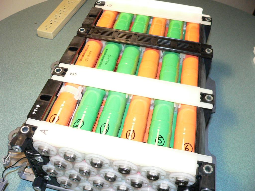

More shots of the pack going together.

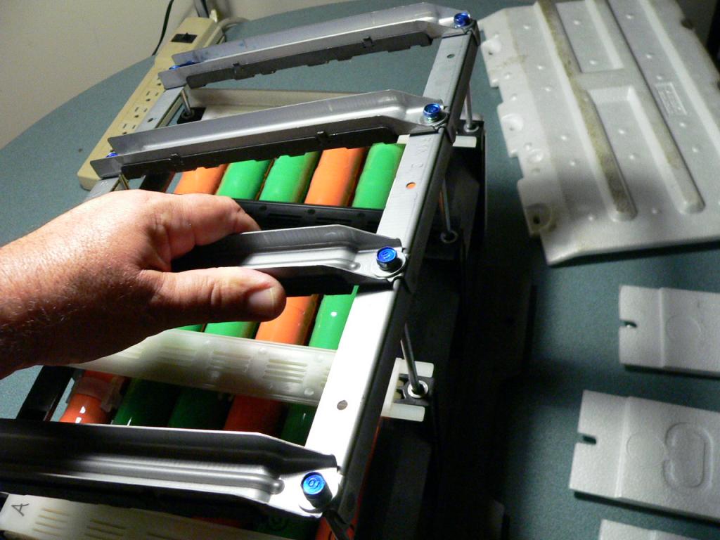

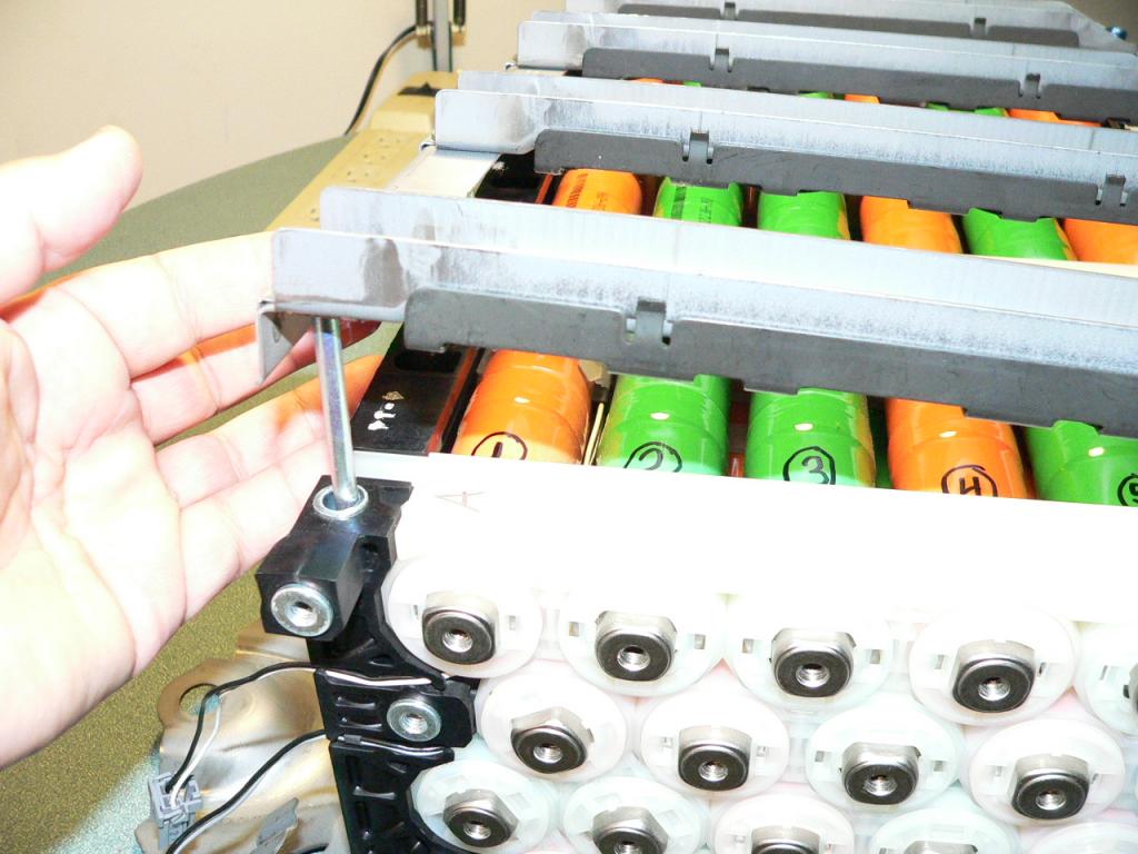

Plastic spacers go on next across the pack. They fit in like part of the jigsaw puzzle, locking the battery assemblies in place. Then the metal frame drops on with long bolts. Everything gets bolted up tight.
Attached Thumbnails Battery refurbish in process - IMAX B6-p1160840.jpg   Battery refurbish in process - IMAX B6-p1160836.jpg   Battery refurbish in process - IMAX B6-p1160841.jpg   Battery refurbish in process - IMAX B6-p1160843.jpg   Battery refurbish in process - IMAX B6-p1160848.jpg

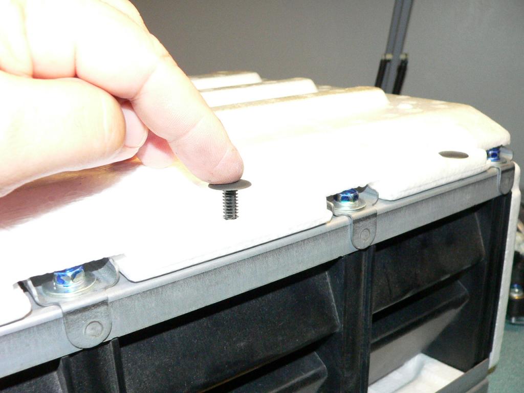

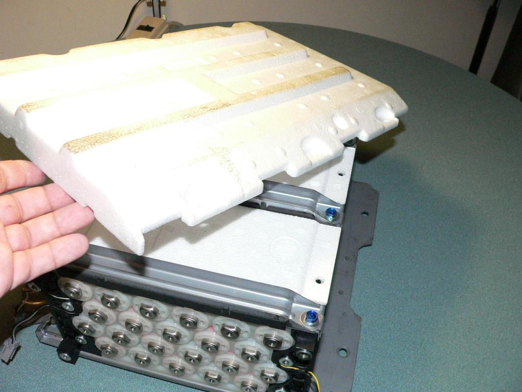

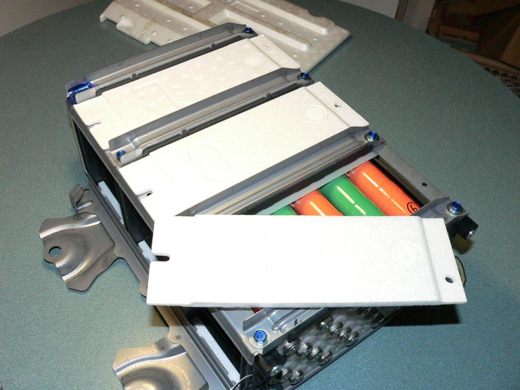

Next we put on the styrofoam pads and top. Three lower pads, then the top. All held in with push fasteners. I believe these help to channel air through the batteries to cool them.
Attached Thumbnails Battery refurbish in process - IMAX B6-p1160850.jpg   Battery refurbish in process - IMAX B6-p1160852.jpg   Battery refurbish in process - IMAX B6-p1160854.jpg   Battery refurbish in process - IMAX B6-p1160856.jpg   Battery refurbish in process - IMAX B6-p1160859.jpg
