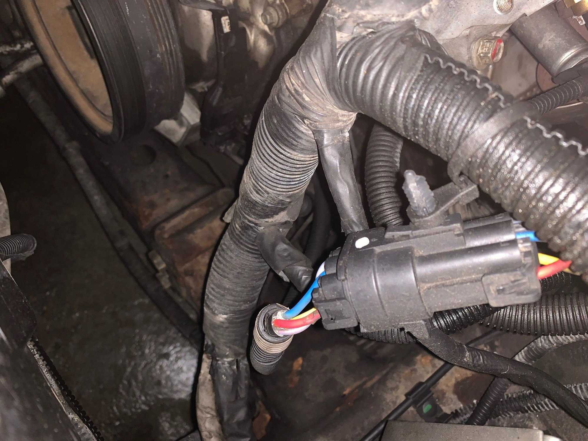

Guys, I apologize for the confusion, the two connectors I referred to in my posts are the ones under the hood, to the right side of battery and under the black control box located there by the radiator and down lower from the 12 volt battery. These pics are from my 13 Denali Hybrid and a bit different than the earlier ones but give you an idea of the area.

This is the Aux Trans Plug on an 09.

YES mine has corrosion on it..... white stuff on the pins I was about to spray HIGHLY flammable stuff near a HOT engine :O i'll wait for the engine to cool off before messing with it....

quick update what a difference this had made cleaning those pins.. probably going to go in and do another cleaning when i have some time I'm going to the smoke shop and get a micro pipe cleaner to get inside the female connector
