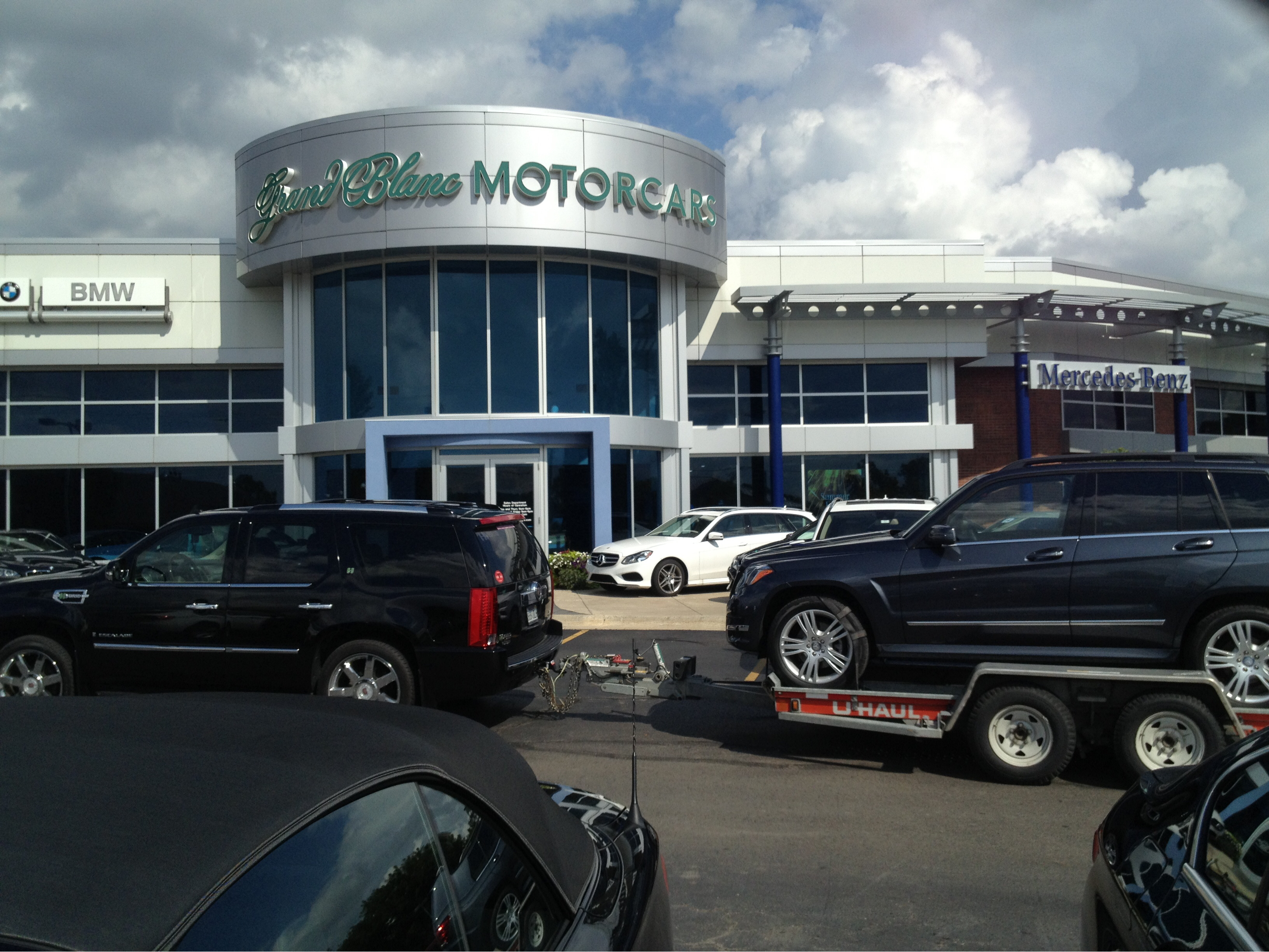

I got 15.9 mpg on my escalade hybrid as well but I was towing my MB GLk 350 4 matic above an auto transporter.
