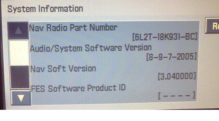

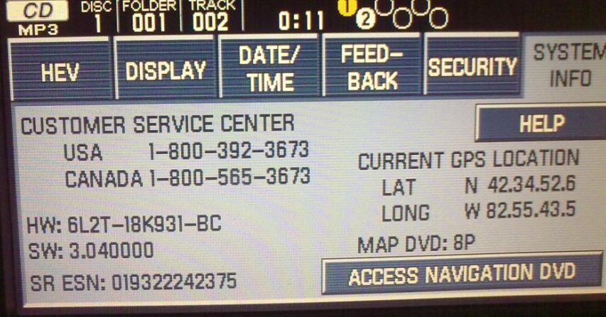

Can you tell us your H/W version? Your nav DVD region (North America vs somewhere else) should not affect your hybrid display.
Was the nav unit added in after the vehicle was built, or was it originally included in the vehicle? Based on the others DTCs present on your display, it looks like it was added after the vehicle was built.

Thank you for your replay, in attached file maybe the infor you ask for,
please accept Kind Regards

Default Re: No HEV display on nav sys
