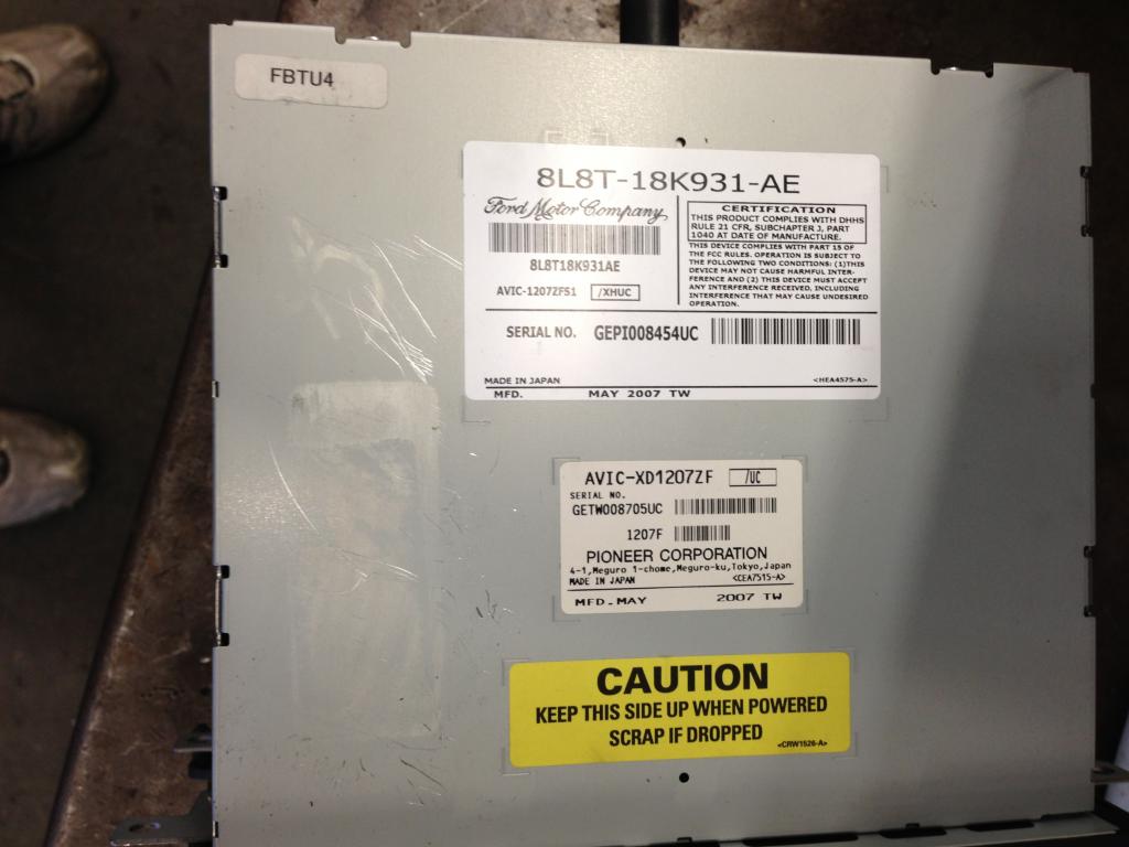

Fully knowing this thread is 2+ years old, was hoping there was still some knowledge floating around here.
My 08 FEH nav system had it's map DVD drive go bad. The dealer swapped out the whole nav unit, however they cannot seem to program it into "hybrid mode". When the 3+6 configuration status screen is shown, it always displays HEV as disabled, and the "HEV" energy flow/mpg screen is missing.
Can anyone point me in the right direction as to how the dealer programs my car as a hybrid? They cannot seem to figure it out. They had the VCM plugged in, but none of the options on their screens had any "hybrid" or "HEV" options.
Any assistance would be greatly appreciated!
Thanks!
Tom

Shouldn't the dealer have this capability? I'm not trying to put sync or an 09 nav in my 08, i'm merely trying to restore the HEV screen on the 08.
Seems like something the dealer should/would have the capabiltiy to do without sending out.
I think Idunno was on to something. The 2008 OEM Ford hybrid nav system was made by Pioneer from what I gather. Pioneer no longer supplies nav systems to Ford. Your dealer might have swapped in a Clarion or other unit from a newer FEH. The newer (2009-12) FEHs have a totally different powertrain than your 2008. Programming tools might not exist any more for the 5+ year old Pioneer systems, and it's doubtful the Clarion units were designed to be reverse compatible for older powertrains like yours.
Old Oct 23, 2012 | 02:51 PM
tas246's Avatar
Joined: May 2007
Posts: 17
From: Newport, RI
Default Re: NAV system for 08 FEH
It's definitely a pioneer unit. See Attached Photo.
You think a dealership would stop supporting a unit only 5 years after a vehicle was released? Seems like they would keep these legacy tools around.
This is becoming an annoyance. I don't want to lose that HEV screen, however it was better than a broken nav like i had. Either way it should be on Ford to make my vehicle like it was when i bought it. I'll keep pinging the dealer.
Appreciate the info!
