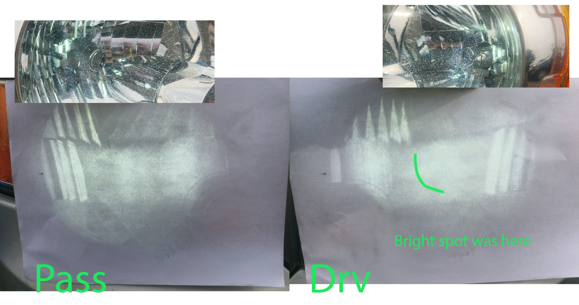

I swapped the lights around. It's not the light, it's the reflector.
That makes a lot of sense. I was thinking it might be a problem with the outermost "glass" on the headlight units but I didn't know what they're made of on a 2009. It makes more sense that there's a problem with the reflector. Nothing is ever as easy as we'd like it to be. And at least they don't have a blue cast. I really dislike those.

Default side beam defeated
I was able to find and fix the light leak. No more side beam.
Covered the lights to find the bright spot. Then bent the bulb shield up slightly until the hot spot was gone and it looked like the passenger side. It still shows up in the high beam, but I can count how many times I used that over the last 10 years on my hand. Must have invented something because no other examples of this on the internet I could find.

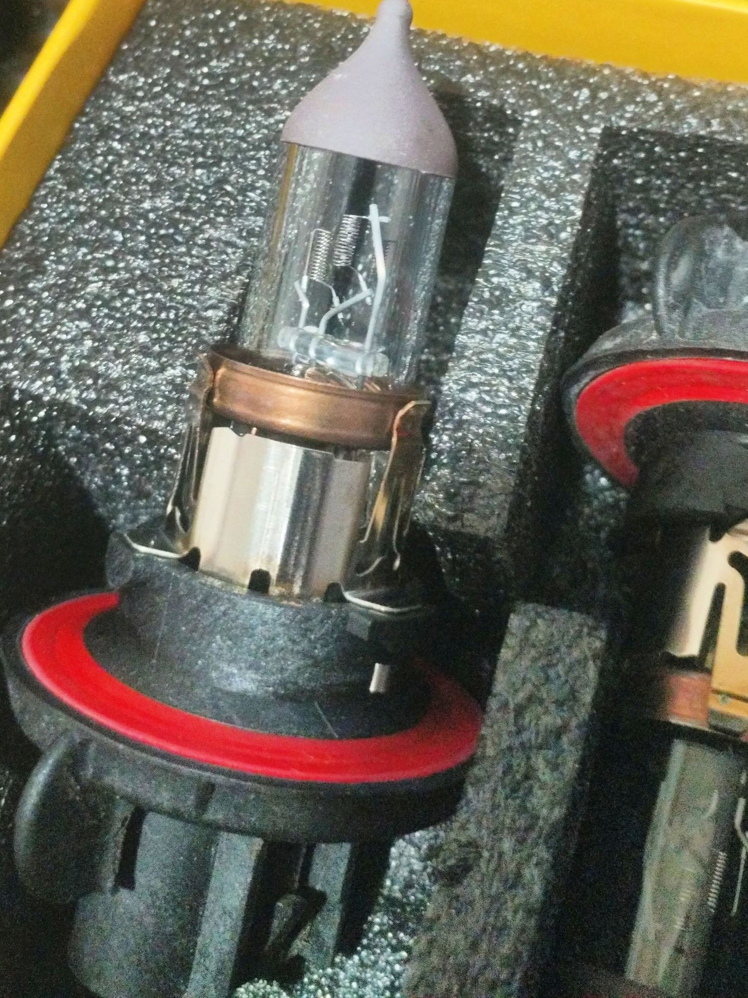

Original Bulb
Check out the melted filament in my original bulb. I hope this really works because my halogen choices are dim & yellow or burn out within the year. The projector housings are sold out and $3-400 or $200 and hack up the wiring/split the beams. Every other car has decent options for a single projector light.
