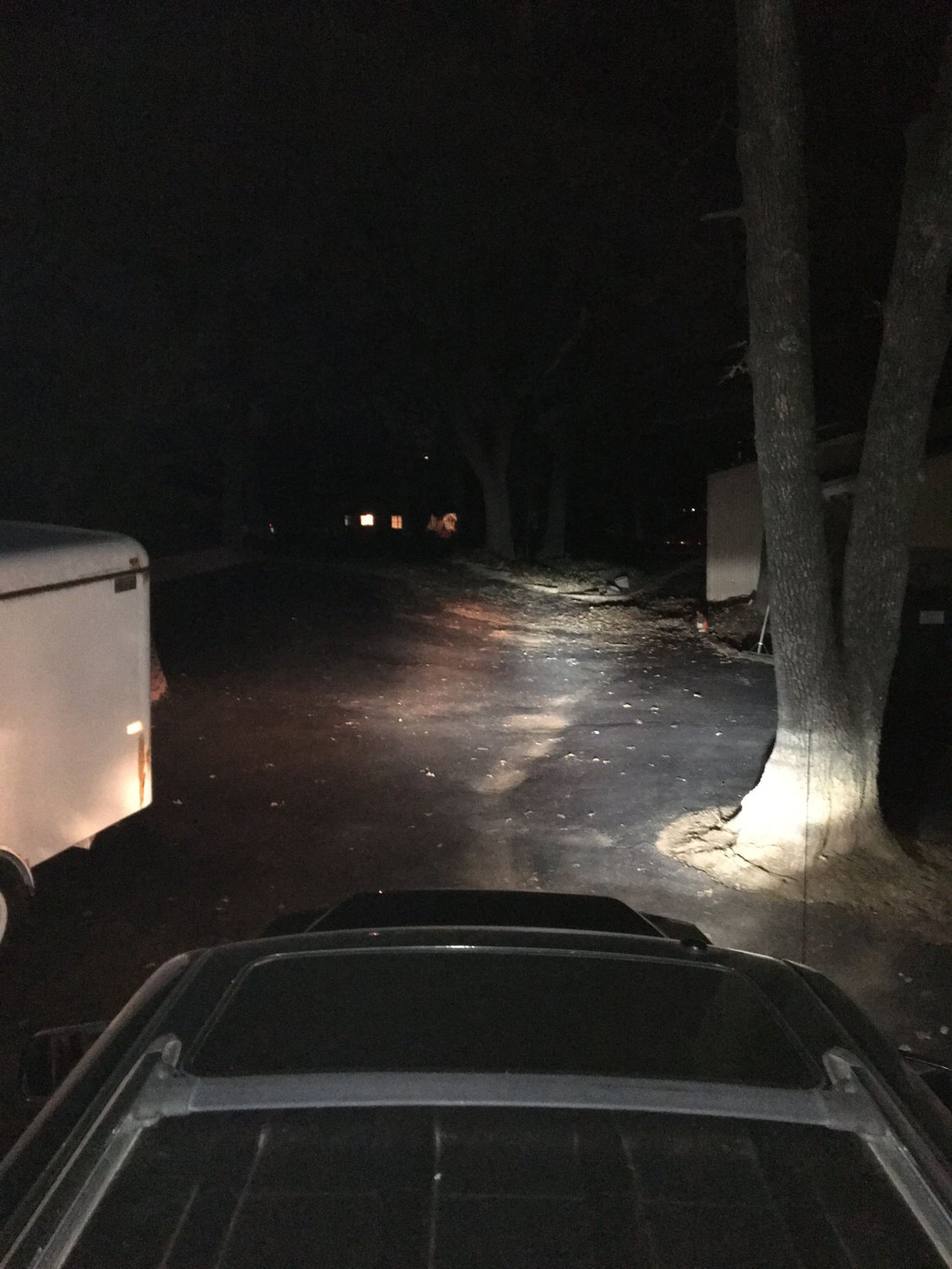

I changed over all but the dashboard lights long ago.
The headlights were $50/pair on Amazon. Amazing difference. Ordered two more sets for my other halogen-lit vehicles.
The clearance lights were easy, just get the right voltage and socket type. Most are the 194-style. IMPORTANT: If it is behind a red lens, get only red LEDs.
The turn signal lights required a resistor to prevent rapid flashing. You only need them in the rear.
Dome lights made a huge difference.
I spent less than $100 for everything.

Headlights https://smile.amazon.com/gp/product/...?ie=UTF8&psc=1
Going on 2 years now.
Seems like the rear cargo area light was a bigger bulb. I might have used one of those rectangular arrays that comes with the correct plug to match the bulb base. Might be a true replacement now. Those panels seem to have less lifespan.

No problems with beam pattern on those? Or anyone flashing lights at you because you brightlighted them? My halogens look aimed already so that sounds like a painless swap.
Old Jun 13, 2021 | 04:34 PM
Rex B's Avatar
Joined: Aug 2016
Posts: 156
Default Re: LED Light Retrofit
No problems with aim, did not touch it.
