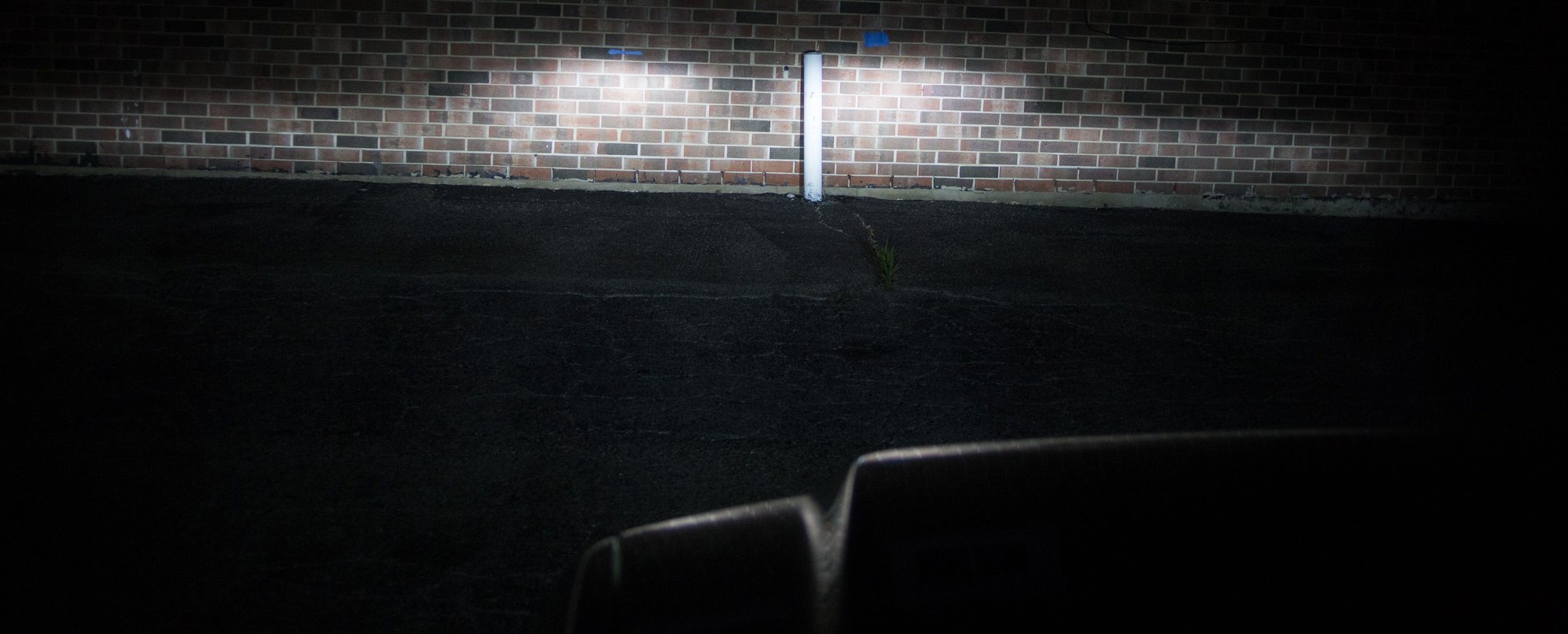

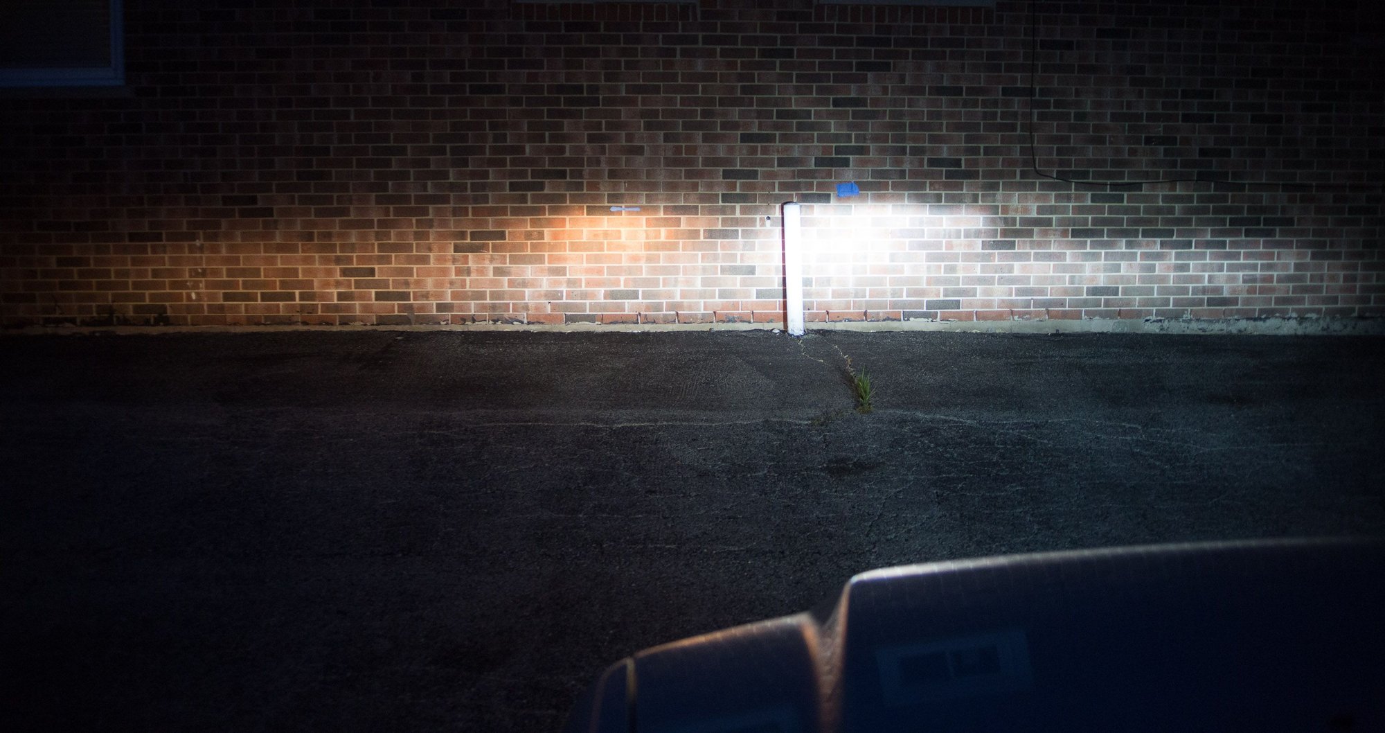

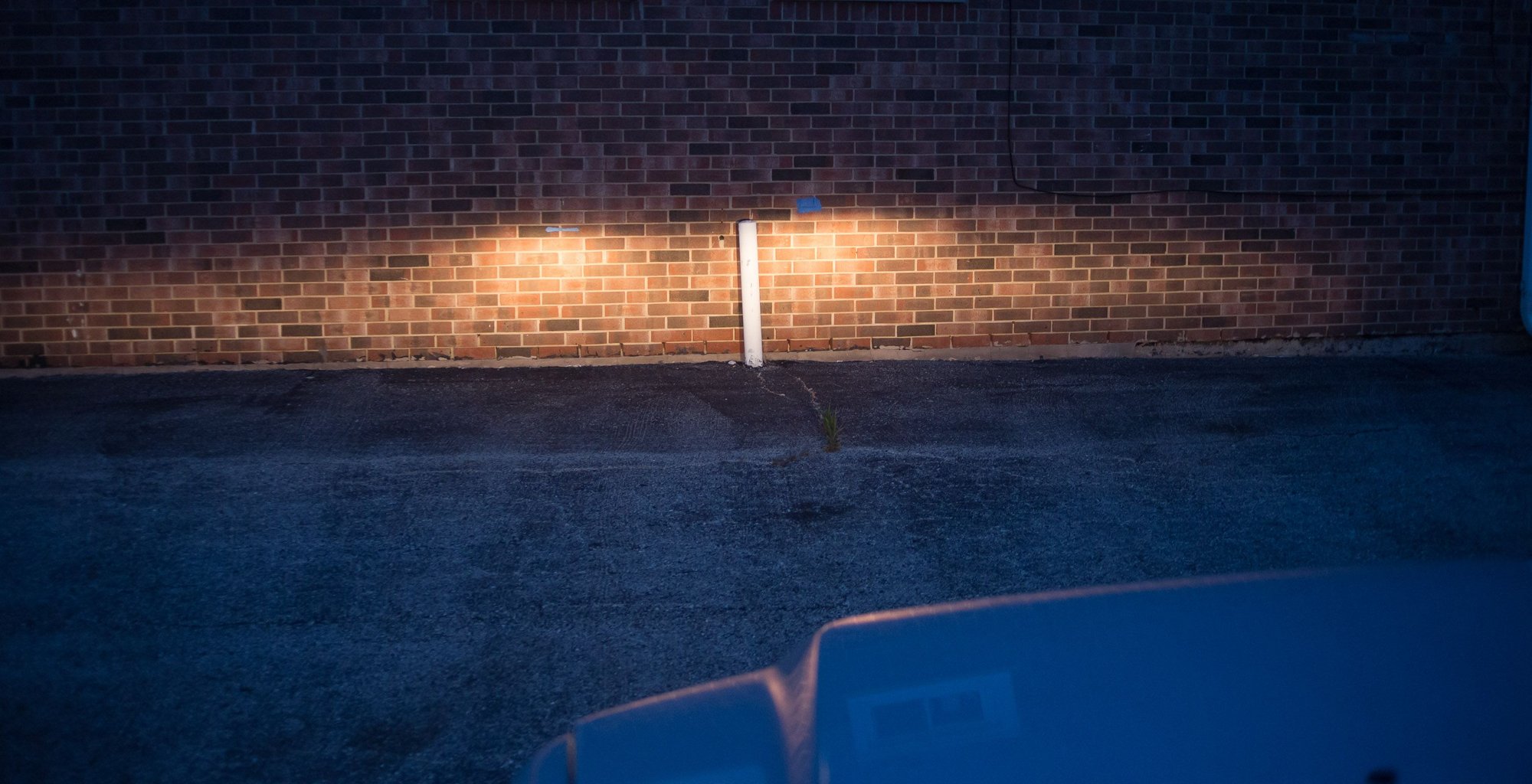

So the lights showed up.
Original Pattern
Side By SIde
Full
Intensity
Turning these lights out was actually a challenge. I think I have original bulbs. I needed to apply tools to get them to come out and go back in.

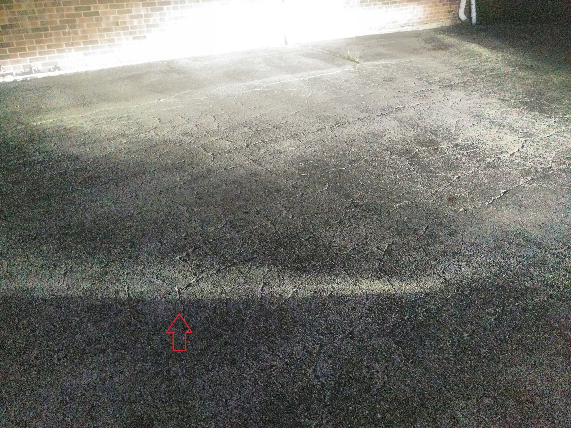

Passenger side has very limited side spill. Only some out of focus ripple towards the back.

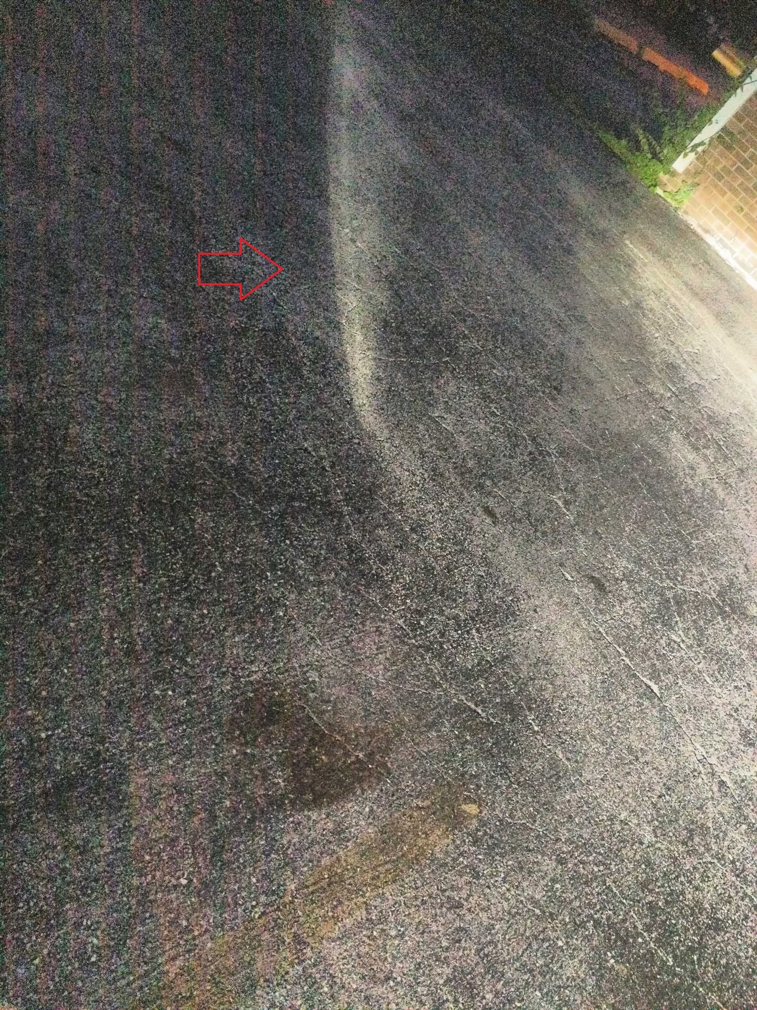

Driver's side has a 175 degree spill in a weird spot. I am lighting up trees and signs in a 6" literal beam. It's only visible absent streetlights. And I tried to see if it was blinding but it wasn't. Still, it's there.
I also drove around, even passed cops. Nobody flashed their lights at me. Noticed a lot more people have white headlights now. Sometimes much brighter than mine and worse aligned. What weirds me out is that horizontal side spill. It's perfect to light up addresses and even signs but it's literally like a crack. Don't know if something is wrong with the reflector or if I should put the bulb upside down, etc. Perhaps it is a feature of the reflector but now the light is more intense? It doesn't happen on the passenger side and it's away from traffic.
Above is my crude MSpaint interpretation of it. Tonight I will investigate further and see wtf is going on. Again, only visible when on a completely dark road, coincidentally nobody flashed me there either. Ever seen something like that?

I swapped the lights around. It's not the light, it's the reflector.
