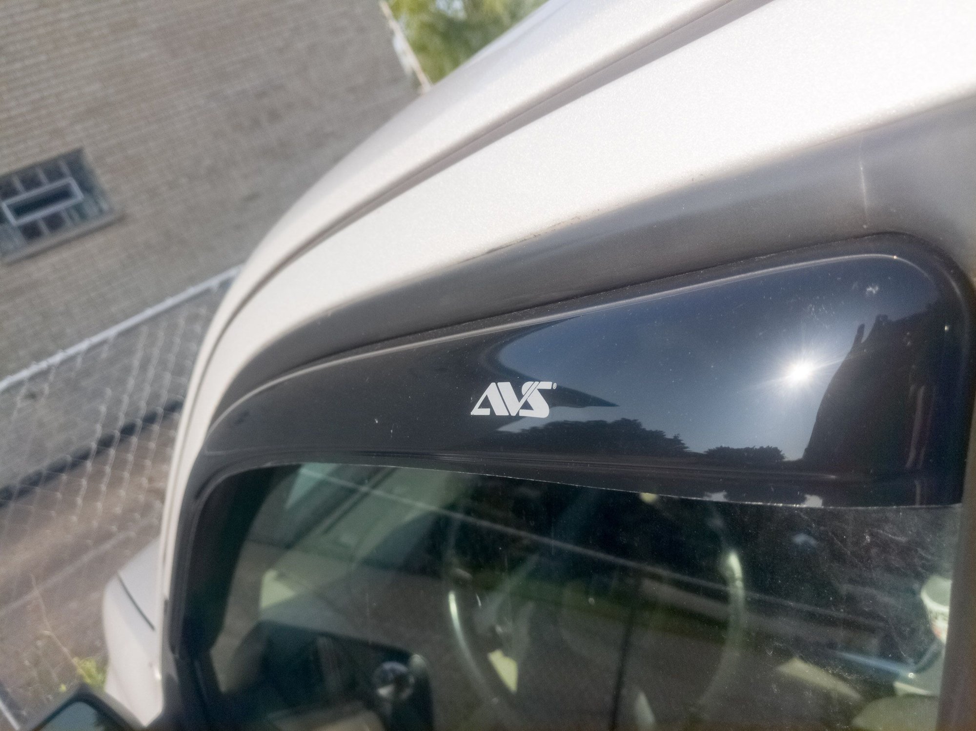

I added some window visors. Hopefully water doesn't drip into the car anymore when driving with open/cracked windows. Wipers pushed water inside too. I don't like how they block out part of your view however. So far so good. Don't appear to impede the window at all. The poor sealing in the door appears to be scratching it, something sharp is in the bottom of the window.
shade outside

Nice with the AVS shades, I concur - I bought a set also, not the in-channel kind like yours, the stick-ons. I also noticed during fitment that they occlude quite a bit of view, so I compromised and mounted mine about 1/4" higher than the recommended position. I can still crack the windows about 3/4" inch but the outside view is a little better and yes, they stop the water ingress during rainstorms which I really wanted. They are a well-made product. PS If you get the stick-ons and want to remove them, I checked removal videos on YouTube - you can run a piece of fishing line between the shade and the body, back and forth slowly until the shade comes off, then basically roll/push the adhesive off your paint by working with your fingers, so they can be removed without damaging the paint, but it will take some work. The adhesive is a 3M part if you ever need to dismount/remount them, and it is *STRONG*. You could stick your hybrid to another hybrid with that stuff and have a two-lane "double parallel hybrid" (badump bump, cymbal crash).
I didn't know about the 2012 "extending" visors, neat-o. Great to hear about the mileage, at the beginning of this saga I frankly doubted you'd ever get it into the 30s but perseverance, knowledge and some $$ carried the day, as they often do. Living in Chicago and having driven there I can recall several times I would have wanted a "pusher bumper" too. Lol. "GET OUT OF MY WAY!!" It's interesting to hear about the difference between the FlexFuel and the regular engine. Too bad someone doesn't offer a remap. service, it sounds like these could be FlexFuel Hybrids pretty easily.
