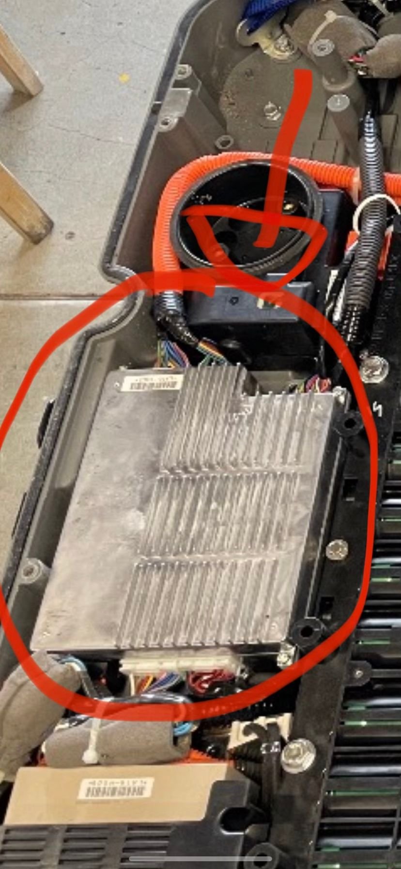

Today I tore down two other cores. One of them was an 08 and the other an 06.
As you Can see in the first photo and from what I’ve circled, the battery computer is square, where as the older version in the following picture is L shaped. The 08 also has the same electronics as the 09, minus the jump start box. I have confirmed that neither of these were opened or tampered with. No broken zip ties or any nonsense.
I have a few more cores to tear apart, and I’ll see if I can get any information to see if this is a consistent electronic difference between years, as I’ve heard rumors that Ford likes to mix and match components between years, only discernible by taking the case apart or comparing serial numbers. More info to follow.
05-07 Square BCM, jump starter included
08 L shaped BCM, jump starter included
09 L shaped BCM, jump starter NOT included

Photos below

Quick update…let me correct myself.
2005-2007 Models contain the Square shaped BCM, a jump starter have a ton more grounds in the pack, different PCB boards configurations, compared to the 08-09. Between 05-07, the only difference I can notice is some of the cable management went from a material that looks like the bristle side of a sponge to some foam. The vent is also a different material between these years. But all electronics are compatible and you will have zero issues installing anything between these 3 years.
2008 Incorporates the Newer L shaped BCM, fewer grounds (noticeably less complicated), but retains the jumpstart module.
2009 has the same configuration as the 2008 without the jumpstart module.
Battery years can be found on these batteries very easily by the label on the top lid, as the first digit will tell you the year made for years 05-09 and you can tell if they have a jump starter or not using my key above, or by looking at the number following “m” in the sequence. Following the M, 64 indicated a jump starter is included, 68 means no jump starter. (Confirm no one has tampered with the pack or the label means nothing)
For example:
6M64
6=2006
M64 means the pack has the jump start unit.
9M68
2009, has no jump starter
So far, I can confirm this by having 20 of these torn down over the last few weeks, several of each year.
I am taking apart a 2010 this week and will confirm any differences in components. I will individually take apart a 2011, 2012, and 2013 to confirm any of these differences. Bottom line is this.
For anyone purchasing a used pack: DO NOT follow any compatibility guidelines on sites like Car-Part . Com or trust any salvage yards. 2005-2009 are NOT compatible. 2005-2007 are one style, 2008 is another and 2009 is another. Again I will update thread once I take these newer ones apart.

Refuse to install a battery unless the A/C is operating to specification. Educate the customer that failed A/C that is not repaired promptly voids their battery warranty.
To the best of my knowledge, YMMV:
All years can take all years batteries/computers.
All years use the same Sanyo (Panasonic) cells in 5 cells sticks.
05-08 have jump starter located in the cavity on the driver's side. 05-08 computer is different than 09+, 05-08 computer may be required for jump starter to operate.
09+ have nothing in that cavity.
Almost had it perfect. Just to clarify one more time because Ford had to be so darned weird. (Thank you for always helping everyone else out on this forum, I have gone a great length to confirm this stuff and you and this thread have helped tremendously)
05-07 same same, square shaped computer, more grounds, more pcb stuff, has jump starter
08 new, L shaped computer (retains jump start unit)
09 same as 08 but with no jump starter
Take it to the bank.

Thank you for your efforts doing this! It's great to see these differences documented and explained. Please take pictures so that people can compare in the future, if you can.
