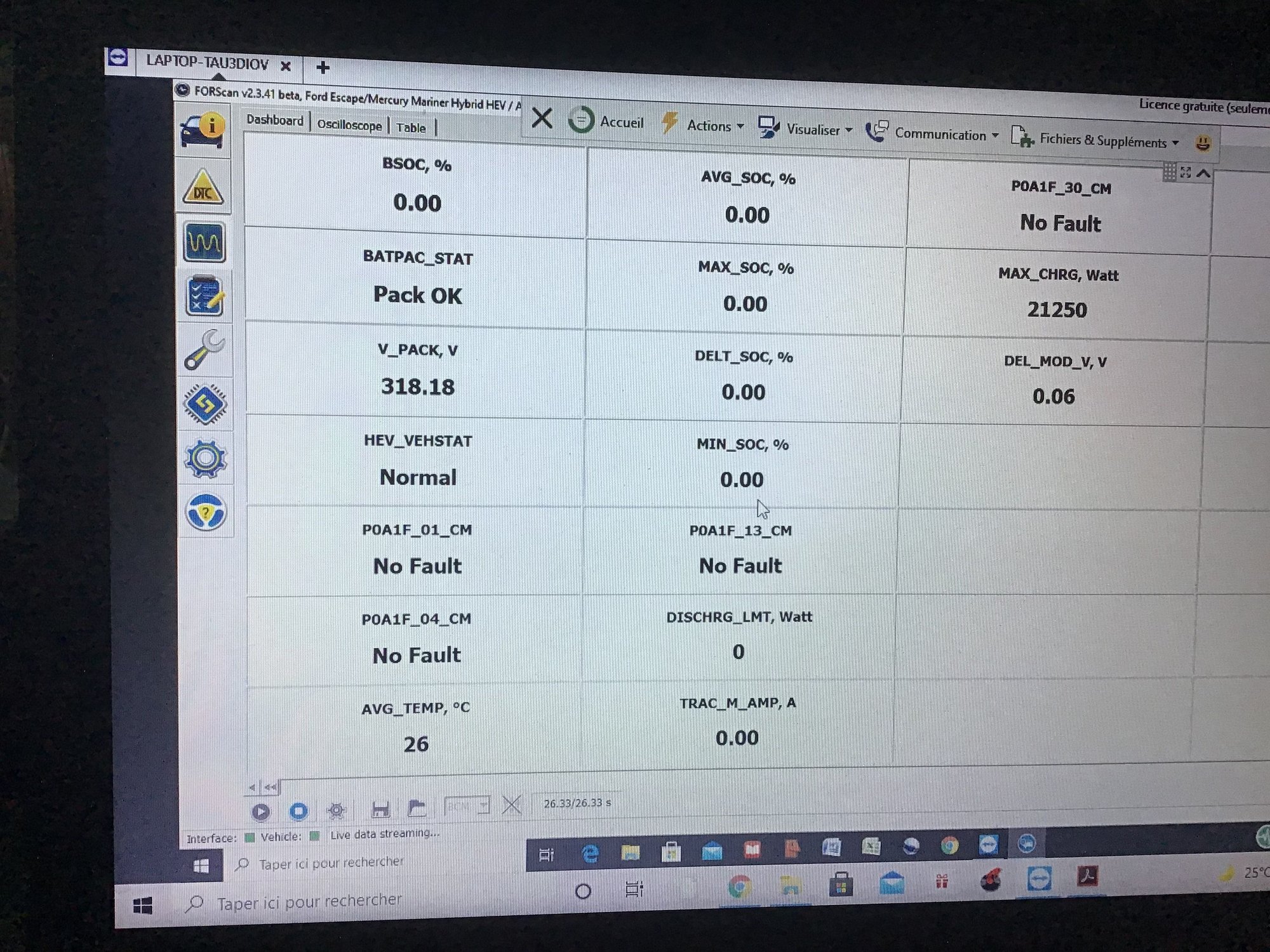

Yes Alex it’s the same one since 2015. I didn’t know about Ford Guinea and don’t think they have technician who know hybrid. I spent a lot of money before I got the forscan. I will change the actuator and see. I use forscan to manage and reset all the adaptions. The del mod v is 0.06v with koeo, when I start the car it goes up and I saw 1.8v

And there you go. That's a hard fault. That value should never be over 0.4V with a healthy battery, typically never over 0.2V except under extreme load/charge. You likely have a failed cell somewhere in that battery. It will shut you down and cause stop safely now.
Since you've built a charger, here's what you should do on the battery:
  1. Open the top.
  2. Place a box fan face down blowing into the cells.
  3. Attach your charger. Input 8800mAh of charge to the battery (25 hours at 350mA).
  4. Try to start again.
If DEL_MOD_V still high under load, battery is faulty - dead cell.
Note that the above is a long shot.
IIRC, you've replaced this battery. If you still have the original, charge per the above and give it a try too.
