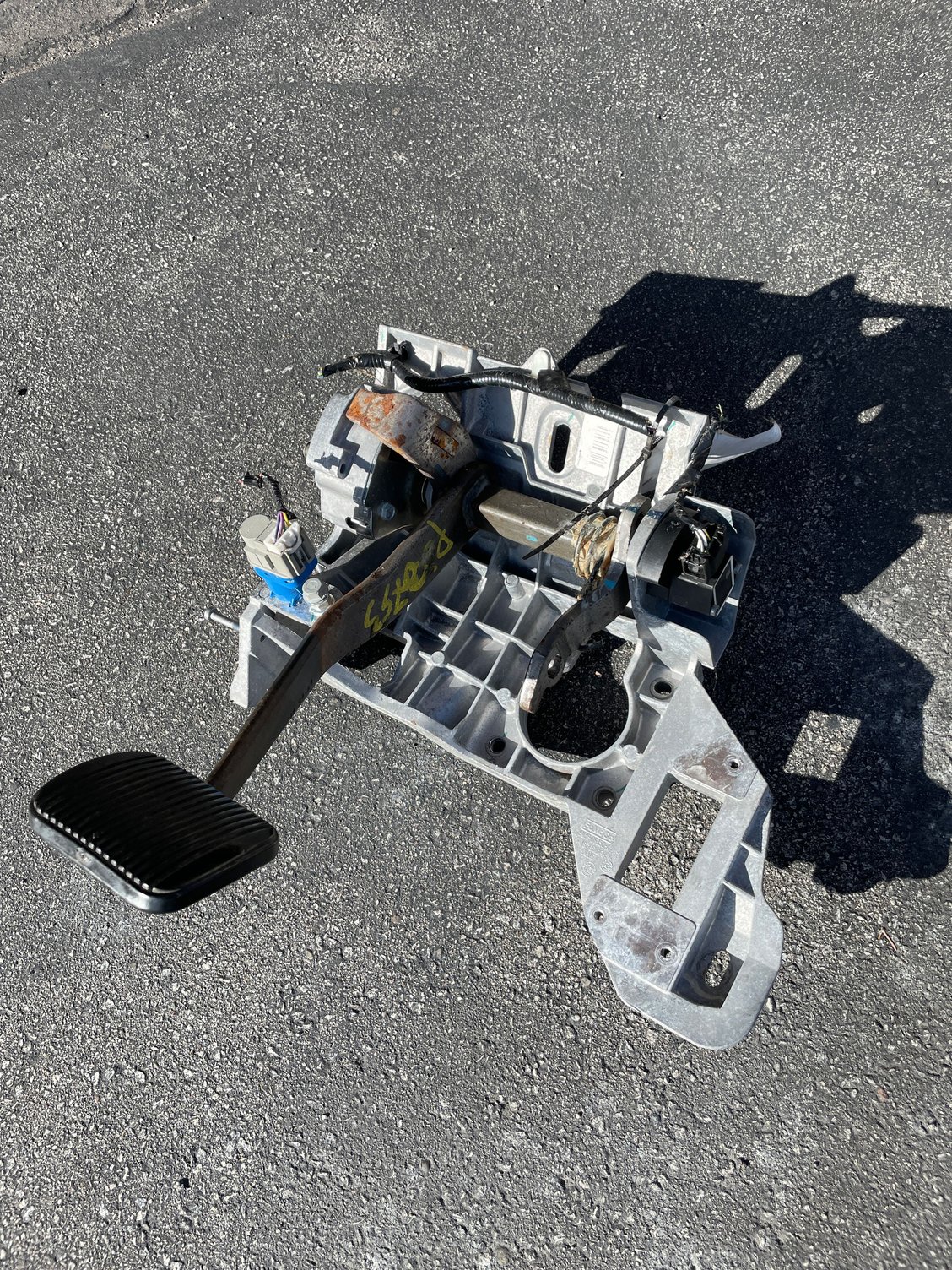

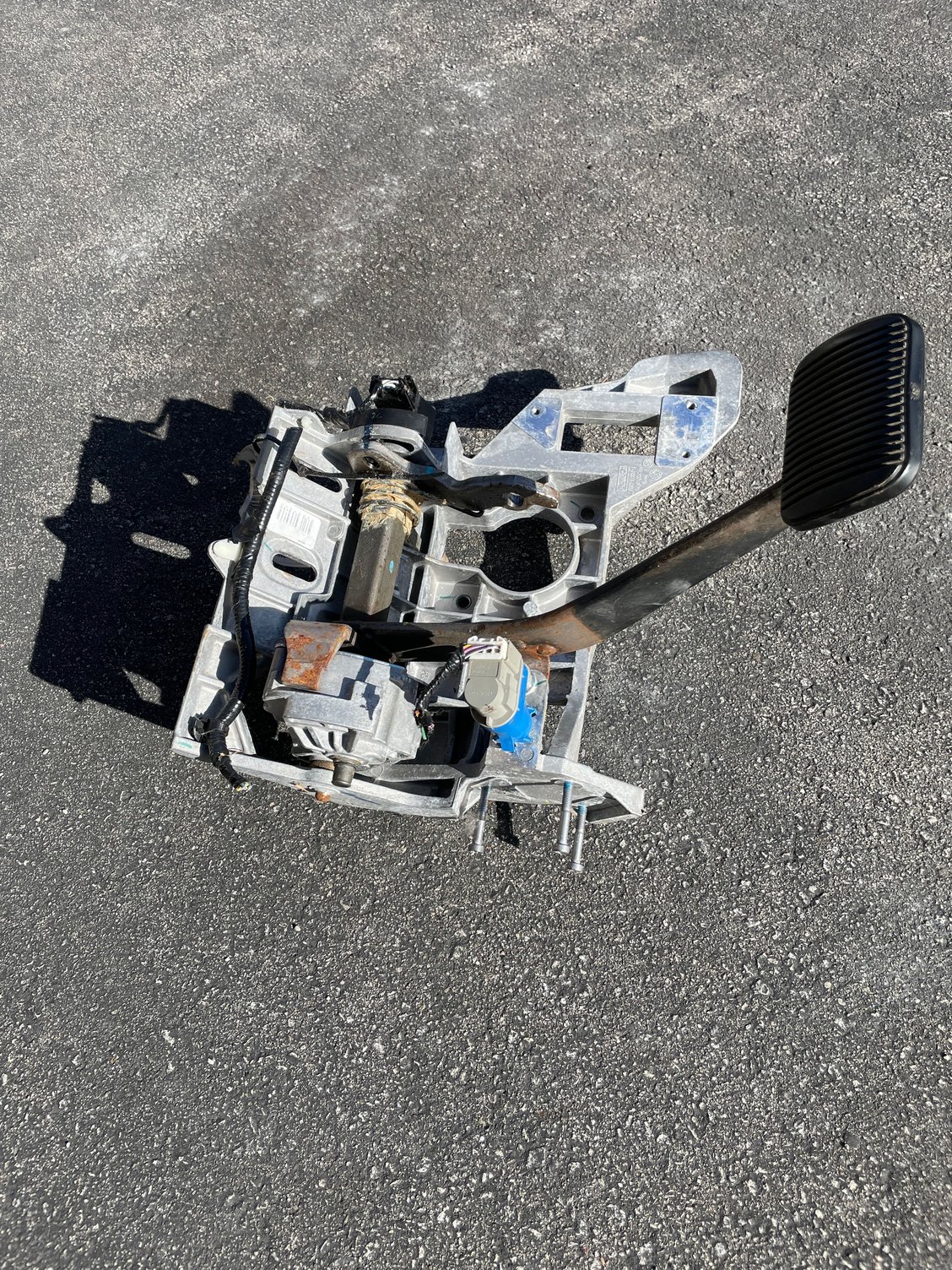

Originally Posted by Hippo the Hybrid
This is a pic of the failed brake feel sensor which was replaced with a good used part.
This is a pic of the failed brake feel sensor which was replaced with a good used part. Lost and now found. On the old bad part above is 9M68-9F856-AF. Also 03.4901-1001.4 plus the bar code with 0191490110011949101389.
The three bolts on the left is where the good used Brake Feel sensor that makes the driver believe that regenerative braking feels like good’ ol hydraulic brakes and apple pie.

It may be the same problem if same code and same symptoms. No power assist but brakes working. This could also be an intermittent issue. If so, I would assume it will come back, Used part still working 2 years later.
