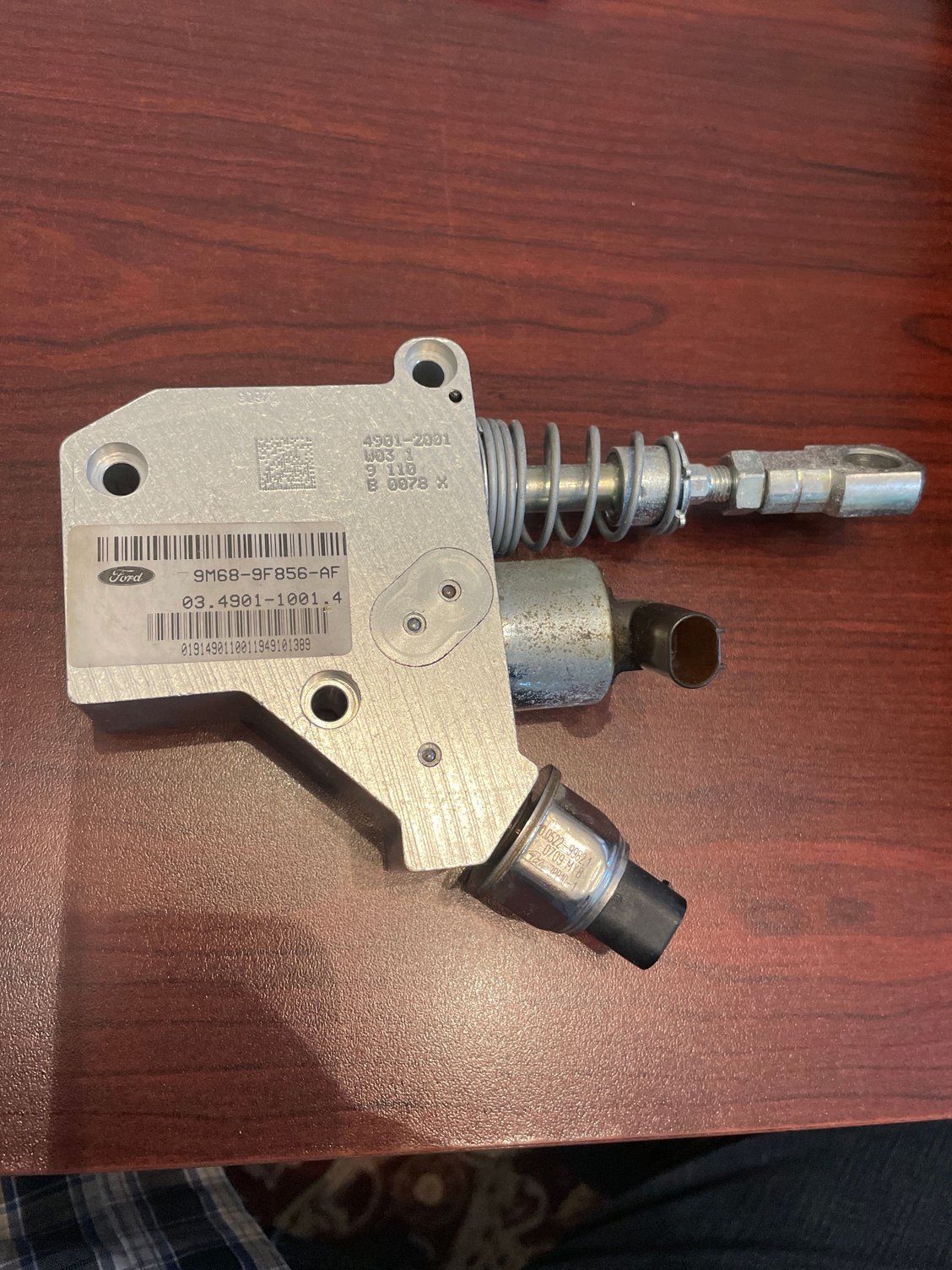

Old Mar 22, 2025 | 02:50 PM
Hippo the Hybrid's Avatar
Joined: Apr 2019
Posts: 186
Default Re: 2010 Ford Escape Hybrid Power Assist Failure C1012 Brake Pedal Feel Solenoid
This is a pic of the failed brake feel sensor which was replaced with a good used part.
This is a pic of the failed brake feel sensor which was replaced with a good used part. Lost and now found. On the old bad part above is 9M68-9F856-AF. Also 03.4901-1001.4 plus the bar code with 0191490110011949101389.

Old Mar 22, 2025 | 04:14 PM
Joined: Apr 2019
Posts: 186
Please see my new post today with pic.
