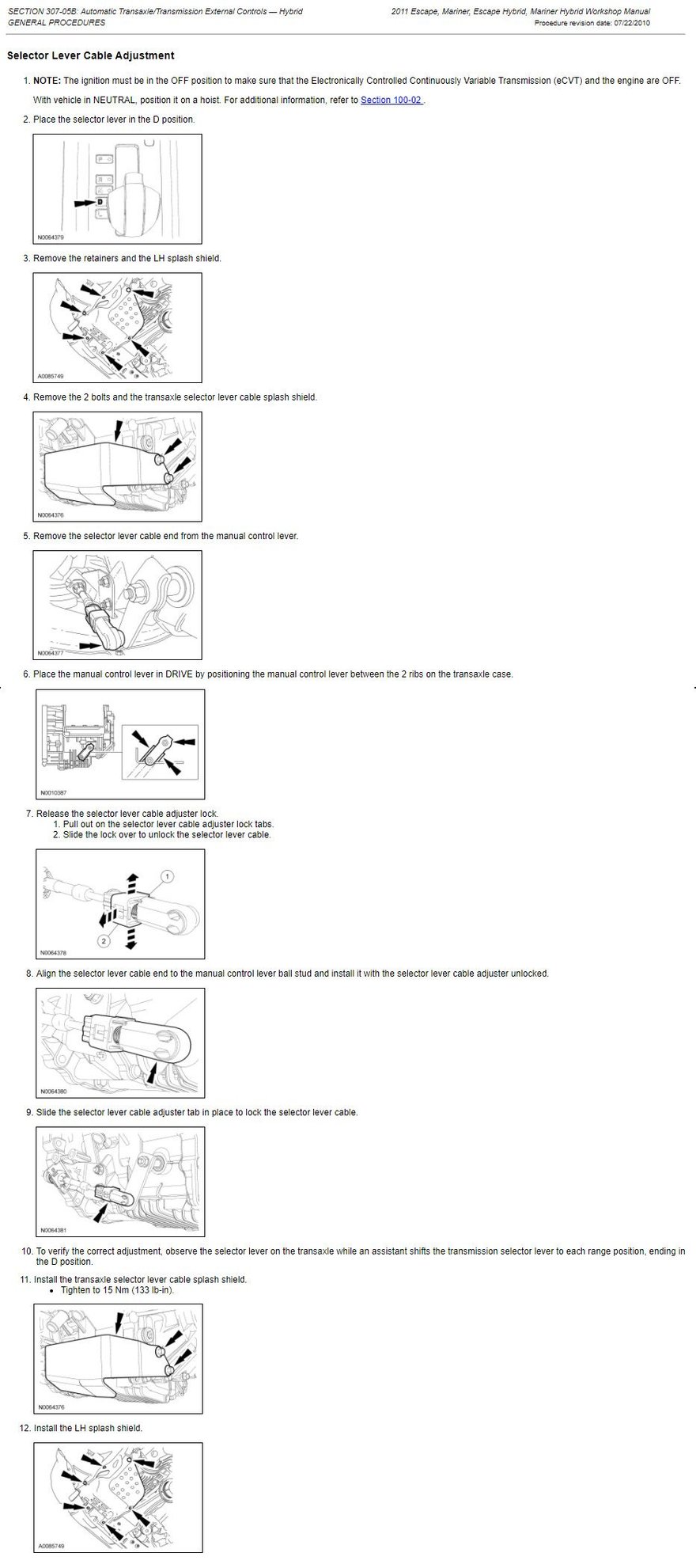

Old Nov 21, 2021 | 10:21 AM
Default Re: 2009 FEH not going into reverse
Also, the cable can be adjusted. This is from the 2011 workshop manual showing the full adjustment procedure. If you want the installation procedure, it is also in the manual but I recommend that you subscribe to the manuals using the Ford Motorcraft site. $24.00 for 72 hours and it gives you full access to everything including the electrical diagrams.
But here is the adjustment procedure:
Shifter Cable Adjustment Procedure - 2011 Ford Escape Hybrid
