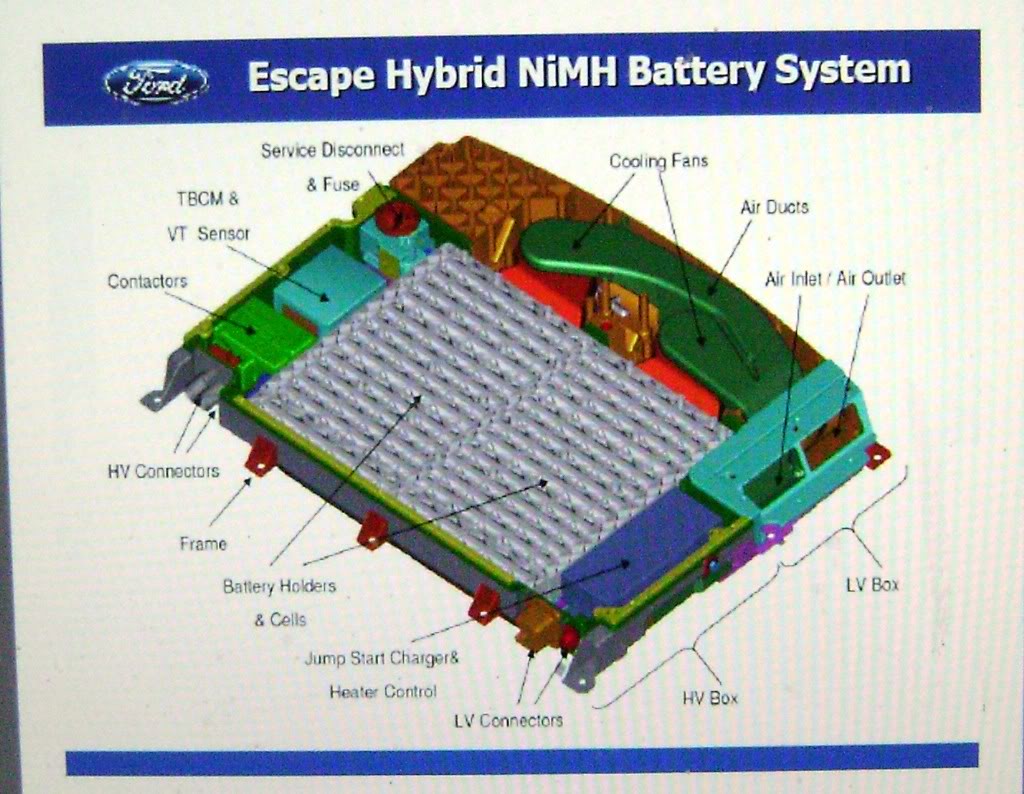

This may or may not help understand the hybrid battery pack:

The small pump is the EV cabin heater pump. It comes on only in EV. The larger pump near it is the MECP that should be running with the key ON.
The radiator fans should come ON only when needed to cool the coolant in the radiator when hot.
The battery filter door is closed most of the time to bring up temperature in a cold battery. It's not a sign of a blend door problem, only a trouble light will come ON for that.
