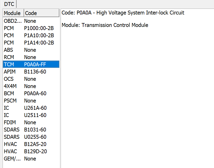

Stop Safely Now 2009 FEH 110kmiles
I built the Charger, Thanks S Keith!
But I am still getting Stop Safely Now.
Did I miss something or do it in the wrong order?

Attached is codes and pic of 12v battery.

Solved.
I unplugged everything. Re-seated everything. Cleared codes and it started. Check your cables kids.
