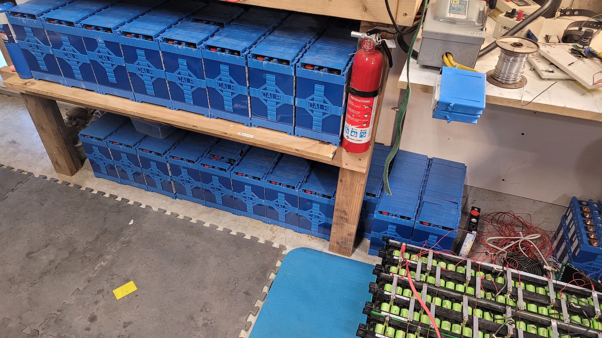

Conversion of a toyota/lexus hybrid to all EV is as simple as removing the engine and connecting a large HVDC battery directly to the inverter. However I also tested a configuration of replacing the OEM NiMh pack with LiFePo4 lithium cells without modifying any of the stock systems. Each module normally operates from 10-14.4v and is replaced with 4-72Ah LFP cells with a voltage range of 10-14.6V when placed in series. Voltage tap points are placed every 8 cells and the systems functions perfectly fine but specific hardware is needed to fool the BMS computer into using the pack at full charge instead of preferring it to sit at a lower state of charge like it does stock.
The 30kWh of LFP weigh about 1000lbs but the additional weight doesn't seem to effect the suspension much. I'm looking into options for air suspension with the EV conversion.
120-72Ah CALB cells with oem tap points at every 8 cells. About 30kWh here.
I extended the battery connection to allow the relay block to sit next to the pack for temp testing
Obviously, this setup is incredibly dangerous and was only used to confirm point of concept, laps around the block, only. Once confirmed functional the pack was dismantled and the entire rear interior was removed.

Curious. Modules are 8S NiMH with a nominal of 9.6V. Absolute peak is very near 13.3V and can operate as low as 8.8V, so I'm not sure where the 10-14.4V range came from. The car is expecting 16S NiMH per block ranging from 17.6V to 26.6V. A 7S block would seem to fit the bill better than 4S.
