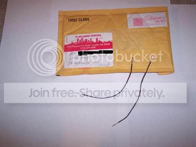

I drove to the dealership today, the "Jumpers" that I was told were sent NEXT DAY by FedEx were not and were sent snail mail but they did come in today. The Service Mgr gave me the jumpers to bring back in tomorrow, I believe he did this so they wouldn't get picked up, lost or whatever at his office... as I posted before he has so much going on.
I am posting pictures of what these things look like. Not much to them, I was told you need 2 for each job/car. He told me others have had issues with Sirius like mine but the customer thought it was the Sirius Sat or whatever. Some stations do it well others do not. I will post tomorrow if this fixed my Sirius/Toyota radio problem as well.
