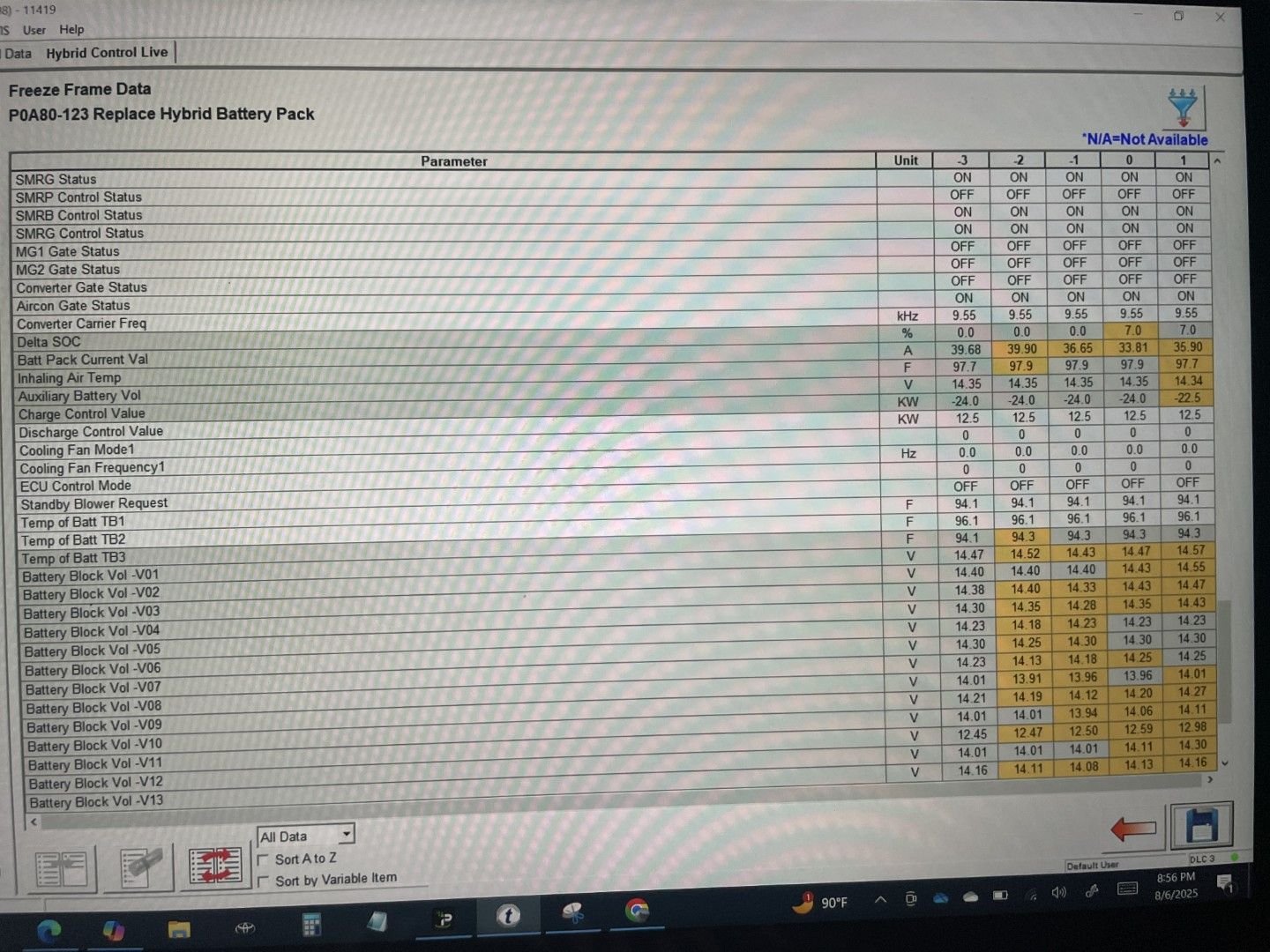

I recently purchased a used 2014 Toyota Camry Hybrid for my son to use while attending college. The car has 146,000 miles. About a month after driving it off the dealer's lot, the “Hybrid System Check” warning light came on.
I was able to use Techstream to clear the code, but after driving around 271 miles, the warning returned. I’ve attached the battery block voltage data. From what I’ve read, the nominal voltage for each block should be around 14.4V (7.2V x 2). However, several blocks are showing significantly lower voltages.
The permanent error code displayed is P0A80 – “Replace Hybrid Battery Pack.”
I’ve done some research and found that replacing the hybrid battery could cost between $3,000 and $4,000. Since we just paid $8,000 for the car, I’m unsure if it’s worth putting in that much more money.

  1. Based on the diagnostic report, does the hybrid battery need to be replaced?
  2. Is it safe to keep clearing the error code and continue driving the car?
  3. What are the risks or consequences of continuing to drive with the “Hybrid System Check” warning active?
  4. Does the diagnostic report indicate any other issues beyond the battery such as inverter or cooling?
  5. Is it worth replacing the hybrid battery in this situation?
  6. If replacement is recommended, are companies like Green Bean Battery or HybridGeek good options? If not, what companies would you recommend for a reliable and cost-effective battery replacement?
Any insights or experiences would be greatly appreciated. Thank you!

P0A80 = Replace Hybrid Battery Pack.
That's what's needed.
Your block voltages are a mess. I wouldn't be surprised if that's not the original pack, but I have seen originals that bad.
It's very likely the dealer was aware the hybrid battery was bad.
1. Yes
2. As long as the car feels safe to drive. There is a risk of the car shutting down, but in almost all cases, it will restart after pulling over and power cycling and/or clearing codes.
3. Decreased performance, mileage, and potential shutdowns. 271mi between codes is low risk of shutdown. As trigger times shorten, performance will worsen.
4. Probably not as there would be codes associated with other systems.
5. Generally speaking Toyota hybrids are solid 250K mile cars is properly cared for (often needing ONE hybrid battery replacement).
6. Consider a genuine new Toyota battery. It will likely be cost effective over the next 100K miles, and it's the only product that will get you those 100K miles without trouble.
All are building low quality batteries quickly and cheaply and can replace them 3-4 times in the warranty period and still come out ahead. Never count on getting a day more than the warranty out of it. You are not buying a product. You are buying a warranty.
For this reason, the ONLY company I recommend is greanbean because they are owned by a very large company and will likely be around WHEN you need a warranty (not IF).
