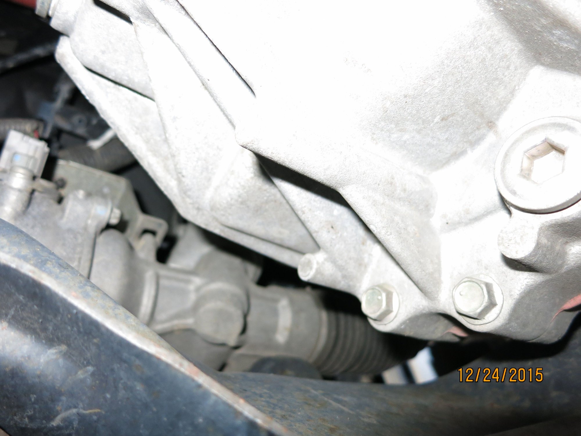

Originally Posted by zan986
Thank you, Replaced the fluid, at 80k Miles, it was still Blackish Red, personally thought the fluid could've of lasted another 30k miles. Replaced 4.25 quarts of Matic W (60$ Total (5qts)). Rigged this contraption with a garden hose. When I was adding the Matic W ATF, it was dripping a little bit from the fill hole, so you have to go really slow. Nonetheless I took my time pouring the fluid in the funnel, it still dripped a little bit. So after pouring 4.5 quarts I had .25 quarts drip in the drain pain from fill hole that I placed underneath the car.
1- eCVT Transfluid fill plug
2- eCVT Transfluid DRAIN plug
3- eCVT Coolant drain
see pictures
