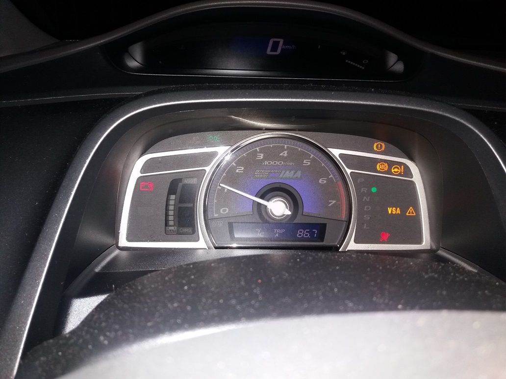

Hello. I recently bought HCHII 2008. Sometimes after starting the engine constantly 12v LED lights up. After turning off and restarting it is already gone. What could be the reason for this? 12v battery to replace, DC-DC converter or something not connected to cable? Please help and greet.

I am far more concerned with the other lights that are on.
7°C is relatively cold for NiMH, and you may be experiencing a restriction on 12V charging due to low temps.
