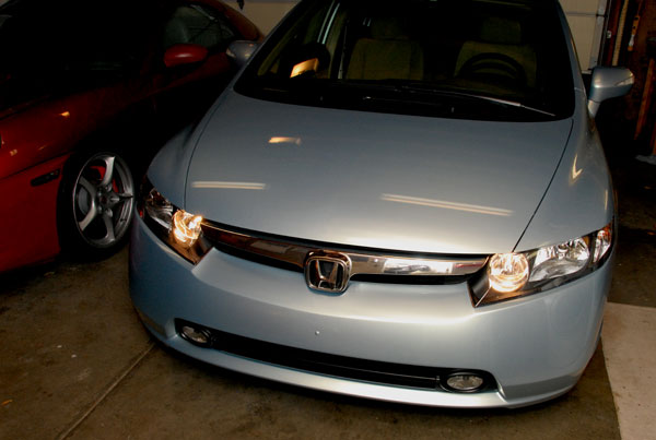

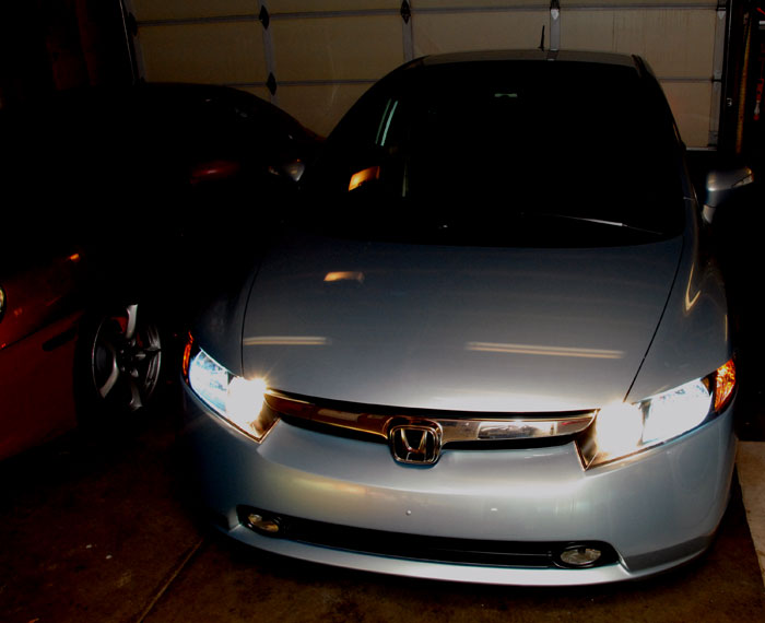

Old Dec 11, 2006 | 07:46 PM
Default DRL photos
Here is what the new DRLs look like and also as high-beams.

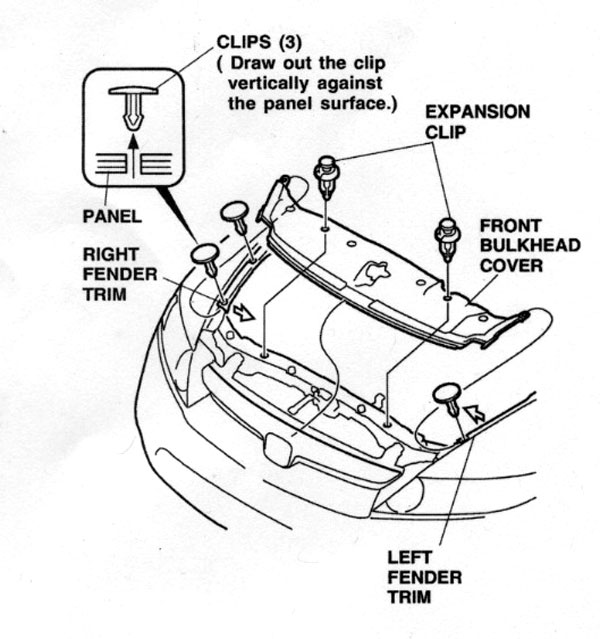

Old Dec 12, 2006 | 02:44 PM
Default Taking the front bumper cover off is easy
It is just held on with a bunch of expansion clips and 2 #2 philips screws. First take off the engine bulkhead beauty cover, then the bumper cover.
I found that a nail puller handle works great to pop out the expansion clips. If you don't have one of those, a small flat bladed screwdriver will work just fine. On both sides of the cover there are clips molded into the bumper cover that hold the cover to the front fenders. You have to give them a tug on the cover to get them to pop loose.
It is also good to have someone help you handle the cover once it is loose so you don't scratch it. Put a big blanket on towel under the bumper so if it falls, it won't get scratched.
