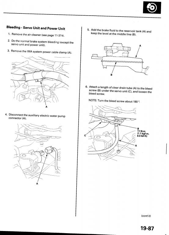

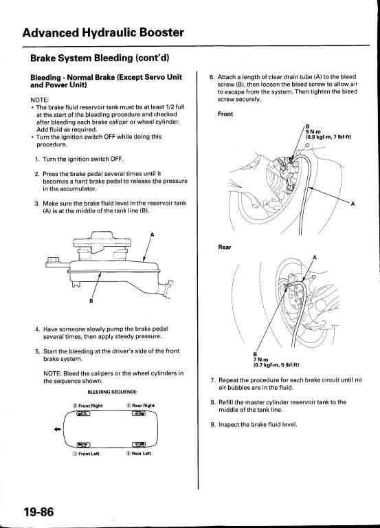

WILCO. I have reviewed the shop manual instructions for same and they are captured here:
My only question in my mind at this point is step 21, "clear the DTC with the HDS, if necessary".
I know when I R&R brake fluid on my 2 old Lincolns, I have to "reset" the brake warning lamp by centering the piston in the master cylinder via use of the brake pedal whilst the ignition switch is "on" (engine off).....
Or conversely, does a Honda dealership only bleed the fluid from the reservoir tank thru the four wheel cylinders versus also the fluid in the servo unit?
Comments?

It is not as easy as it looks. You will throw DTCs because you have to remove the air box and the MAF, and you have to turn the engine on, so you will get MAF and air temp sensor errors. These are easy to clear assuming you have a scan tester. The bigger issue is making sure you do not get air in the lines when you purge out the old fluid. Because the fluid reservoir is so far back under the cowl, it is difficult to see if you have enough fluid in there as you do the bleed, and It is VERY difficult to get the old master cylinder fluid out of its reservoir, especially if you have big hands. Next you have to cycle the purge several times to get the pedal back, etc.
I am fearless about DIY stuff, but this is one that I would rather pay someone to do. Even the Honda service staff had a difficult time doing this
I have an OBD II tester that I used with my '98 Accord. Would this suffice to zero the codes in this ('07 HCH) car? Or do I have to invest in one of the new style scanners as per the banner ads on this site?
Because the fluid reservoir is so far back under the cowl, it is difficult to see if you have enough fluid in there as you do the bleed.
My concept would have my shop partner be responsible for keeping an eye on (and topping up as required the) reservoir tank. I always have two souls involved with any brake work involving brake fluid.
Is this reference the bleed screw (under the servo unit) access space? I'm not familiar with this area as I have not had reason to get into it (yet)....
If the Honda guys in your neck of the woods have a difficult time and Harold "only" paid $CDN 71.00, why do I think that my local Honda dealer will only bleed the 4 lines as per page 19-86?
I guess its time for me to look under the hood and tear out a few parts and see just what the setup is like.

Just off the phone with my local Honda dealer.
After I fed the service manager 2IC a whole lot of technical information and asked the same question 3 different ways, he finally relented and gave me the technical bottom line via one of his shop technicians:
"We only bleed the 4 wheel cylinders. We do not bleed any other screw from, what did you call that, the servo unit? No, we only bleed each wheel cylinder as this will change all the fluid as the whole system is interconnected...."
$CDN 68.88 + HST = $CDN 77.84 gets you a simple bleed thru the 4 wheel cylinders at a Honda dealership in Canada.

If the brake bleed is done as per the shop manual, the first thing that is done is to remove all of the old fluid from the master cylinder reservoir, and to do that requires you to open the drain petcock at the bottom of the master cylinder and then activate the ABS pump by turning on the car. This process is dicy because it is easy to drain the reservoir, and then not not put in enough replacement clean fluid thus inducing air into the system. This is what happened to my car. It took the Honda service guys almost all day to get all of the air bled out of the system.
I would guess that your dealer has a suction pump that pulls the old fluid out through the brake lines, which is just as good, and will probably take just as long. They key is not to let the master cylinder reservoir go dry. Because it is so far back in there, and the new fluid is clear, it is very difficult to see the fluid level through the plastic reservoir.
Well using a suction pump (I have one for brakes) at each wheel cylinder makes more sense to me as one does not open up a sealed system (other than at the wheel cylinder bleed screws).
Come April, I'll do the change myself, using my brake bleed vacuum pump to initially evacuate the system prior to all four corners being bled.
That said, my helper will only be responsible for one thing: ensuring that the fluid level is kept to the top of the reservoir tank with new clean fluid whilst the initial draining (via my suction pump at the front left wheel) takes place......
I'll keep you in the loop once this evolution takes place (in April) with results posted here.
