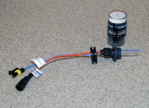

The kit came with 2 Type 9006 bulbs, the igniters and mounting brackets, headlight wiring extensions, and a direct battery/relay wiring harness for if you wished to wire the headlights directly to the battery.
The 8th Gen Civic uses Type 9006 bulbs for the low beams and Type 9005 bulbs for the high beams.
All of the materials were of very high quality, with the exception of the instruction manual. It looks like it was originally written in Chinese and then machine translated to english, and then proof read by someone that did not speak english very well. This is a minor thing, but always good for a chuckle, especially the section labeled "Produce Introduce". Lettuce entertain you....
The 2 main components of the kit are the igniter/ballast and the bulb.
The bulb is in a standard HB-4 9006 base, so it is very easy to install.

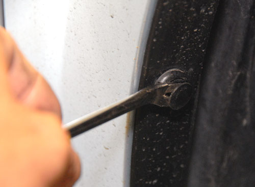

To make it easier to work, I removed the wheel, and took off about 12 fasteners to pull back the wheel liner.
Many of you have said that it is difficult to pull out the fasteners without breaking them. I found a tool that makes the removal much easier.
It is a tack puller, and is available at any hardware store. Simply push the tool under the head of the fastener and pop the head up.
It works just great with both the large and small pop fasteners.

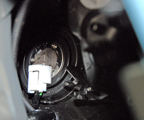

The bulb is fairly easy to get at, and twists counter-clockwise to remove. First remove the electrical connector from the bulb, and then twist out the old bulb. Installing the Xenon bulb is the opposite of removing the old bulb. Make absolutely sure that you do not touch the bulb glass with your bare fingers. The oils from your skin will shorten the life of the bulb if you get them on it. The Xenon bulb's base had a very close tolerance, so it was a little tough to get it to seat completely in the housing. I found by dabbing a little silicone lubricant on the base and O-ring that it went in much easier. Be firm when installing the new bulb, but don't force it.

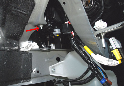

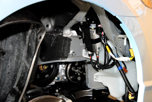

After the bulb is replaced, next mount the igniter/ballast. There are not a lot of mounting places in the right wheel well, as it is pretty compact in there, but there is a bolt thread that can be used to used to mount the igniter/ballast with a 10mm nut.
On the left wheel well, things are a little easier with a threaded nut welded to the front cross-member that allows the igniter/ballast to be mounted easily.
Once the igniter/ballast is mounted, bend the mounting bracket in the right wheelwell forward at an angle so it will clear the wheel well liner once it is reinstalled. Lastly, because the area that the ballast is mounted is very tight, and the ballast may rub on the inside of the wheel liner, I recommend placing a piece adhesive felt on the backside of the mounting bracket.

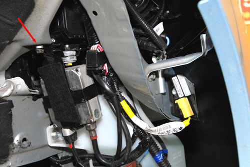

A word of caution on finding other suitable places to mount your ballasts. On the car’s front bulkhead there are 2 airbag sensors mounted outboard and about even with the place where I am recommending your mount your ballasts. These sensors are identified with Torx mounting screws and a yellow cable and connector. Do not mount your ballasts here. If you do, you may compromise the abilities of your airbags to deploy in a crash.
Here is an example of how not to install you ballasts. Complete respect to this installation and the person that did it, but there are 2 major flaws here.
First, the ballast is mounted directly to the airbag deployment crash sensor, which will compromise the ability of that sensor to work correctly in an emergency, and secondly, the ballast connector is pointed up which will allow moisture to accumulate in the connector shell.
When you see cables that have a yellow connector they are for the airbag system. Don’t mount anything on or next to components that have these cables or connectors.
When you see cables or connectors, which are bright orange, that means they have high voltage (158V +) associated with them. These are typically found in Hybrid vehicles.
When you see cables that have a orange connector they are for the hybrid electrical system. Don’t mount anything on or next to components that have these cables or connectors.
Finally make sure that you securely mount the ballast to the cars chassis by bolting it down. Don't use zip-ties to secure it. This is because you need to give the ballast a solid electrical ground for its case to minimize the EMI that radiates from the ballast.
