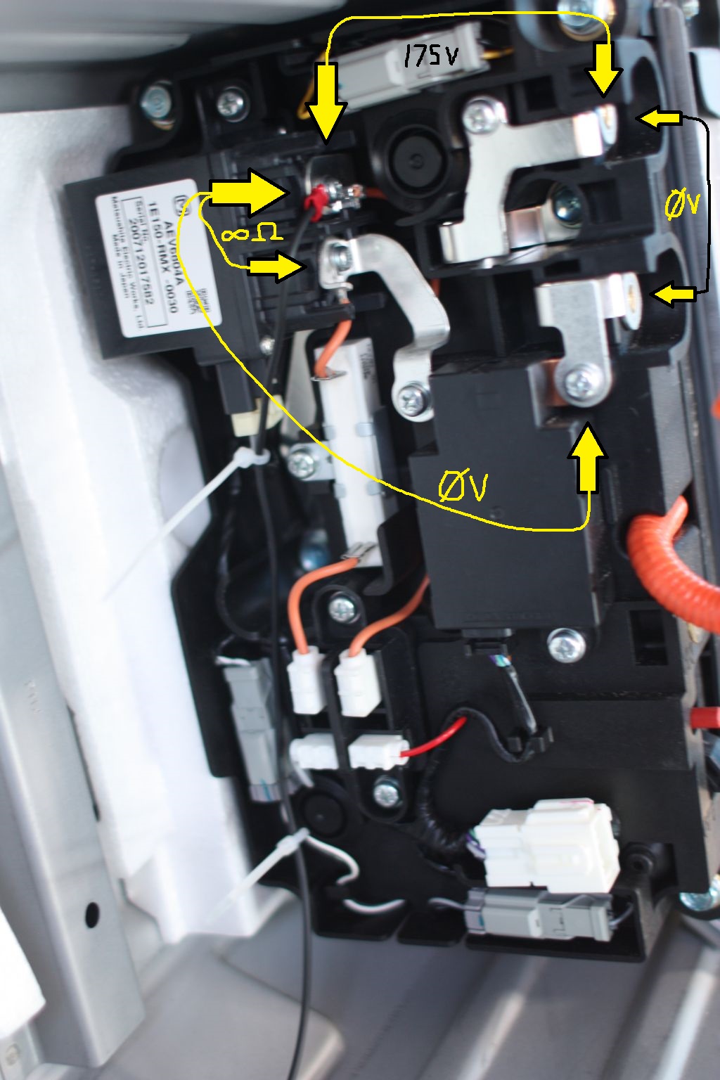

Sorry for the confusion, I should have said, from main relay to the positive terminal is 175V.
Attached a sketch of what I'm getting:
Old Jun 24, 2015 | 07:32 AM
Default Re: IMA dead after reconditioning
Gotcha. That confirms the sticks are installed correctly. I haven't had to troubleshoot anything like this. When you activate the main relay with 12V, do you get full pack voltage at the terminals?

Yes, I put 12V to the relay, heard it click, and got full voltage at the terminals. Reverted back when I pulled the 12V. I haven't pulled the DTC codes yet, but I will this afternoon when I get my new OBD-II reader in the mail
Old Jun 24, 2015 | 07:54 AM
Then it sounds like the car isn't supplying the required 12V. Did you check the output of the connector?

I did not check the output of the connector, since I didn't have a handy way of checking it while it was plugged into the battery. However, I'm pretty sure it's 0V since there is no relay click when I turn on the ignition. The battery terminals read ~90V while car is on, and the voltage varies with engine speed. Switching the battery main on and off at this point did not change anything.
