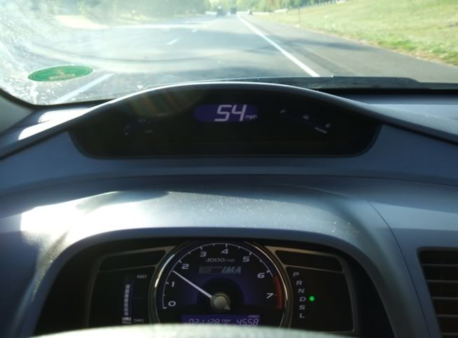

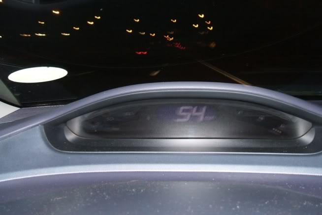

I reported a problem a while back about my mpg display acting odd, showing drops to one blip while in various speeds.
Having the same trouble again now. It always occurs not at freeway speeds of 50+ miles per hour. Happens with greater frequency than before now as well. Whenever I'm in an extended glide, coming down a slight decent, or on a flat surface after a downhill. All I do is feather the gas, keeping a good speed with not valves still closed (no ICE? if I'm using the right term). My mpg display slowly drops down to one blip, and stays there until I either release any pedal pressure and go into regen, or when I press harder and feel the lurch of the ICE or engine using gas.
My first check with Honda, they replaced the tachometer which they said was causing incorrect display functions and errors. Still occurred after. I checked with them again this week. They come back to say there are no electrical errors or mechanical with my car.
I have half a mind to tell one of them to come with me and watch a drive down a bit of I-84
Some pics to show what I mean. (sorry about the poor quality, my 4.1 megapxls doesn't compete with Iphones I guess!) Courtesy of my youngest.

Not sure what’s going on. Honda is wrong and has no clue how to check a hybrid system for errors? Something mechanical? Or am I really just getting really crappy mileage while gliding?

If you notice, you're trip FCD will continue to climb while you are coasting with the iFCD at 1mpg. This is frequently described as the HCHII Samba around here, although I have no idea who originally coined the term. You will notice that it Samba dances it's way from stated 100mpg down to 1mpg, and when you add gas, it dances it's way back up right?
I get it a LOT. Probably 3-4 times over 10 miles lately. It happens more frequenlty with a cold engine and at cruise speed.
If you search, you will find lots of posts referencing this as a "recalibration," although I have no idea if that is something real, or imagined by some Service Advisor. I've read someone who has an 06 that got a firmware upgrade to the 07 version (IIRC) and his dancing stopped, but I haven't pursued anything yet.

hmm If its just a battery recalibration I wonder why it never goes away. Its just annoying more than anything. It's not something they can fix at all?
Added the pics!
Added the pics!
I forget who it was that got it fixed, but if you search for "Samba" or "recalibration," you will probably find the thread.

Checked the threads related to the mentioned terms. They all share the problem where people report the battery charges dropping and engine starts while in AS.
My only problem I see is the display showing zero mpg whenever I'm in a glide. I'm seeing it at slower speeds while coasting as well. Anytime I'm in a glide with no regen the numbers drop.
I don't think its affecting the FE at all. At least I hope not! I would think its impossible to achieve that low a mpg while just coasting along with low foot pressure on the pedal.
Just irritating, I being unable to judge how much pressure to use I often overstep and break a glide early. Still learning but I'm on my best tank at 540 miles with one fuel blip left. Gonna try and stretch it the 35 mile commute monday morning

I also started a thread about this some time ago.
https://www.greenhybrid.com/discuss/...-display-8896/
I am quite confident it is not a calibration. I believe it is a non-linearity in the gauge. For example, I believe that the display shows some value less than 100 mpg when the iFE is actually 200 mpg. I haven't had the chance to "prove" this yet, but I want to get the ScanGuage II in the HCH II one of these days so I can test out this theory.
Anyway, with all that said, I don't think there is anything to worry about. I experience it often in reproducible conditions.
Just because the mpg display is maxed out, it does not mean that the ICE is off. I'm pretty sure your ICE is still on in these situations where the iMPG starts dropping all the way down to 0.
