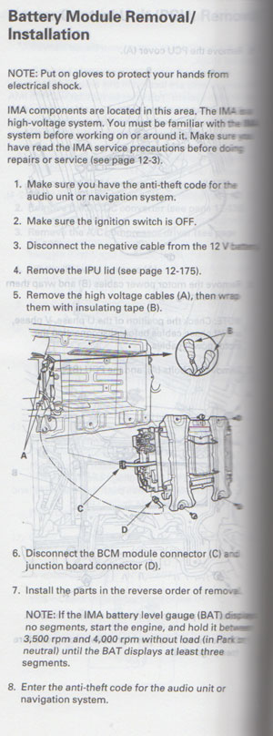

Looking through the Service Manual, I don't see the labour charge being more than one hour. That is a pricey battery.

Replacing the battery pack is about a half an hour job.

Yeah, step 4 ref's to another page, basically taking out the back seat, and turning off the battery on/off switch. Maybe the pro's quote and accomplish this in 1/2 hour. For me I'm sure it would take an hour minimum. Either way it's not a lot of labour. Anyway:
5 grand for a battery strikes me as unreasonable. That has got to come down, likely will, can't be soon enough. Or Honda should sort out some re-build procedure.
