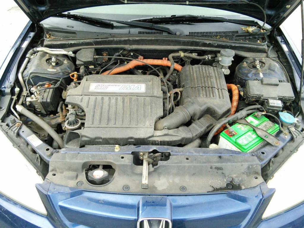

I recently purchased a 2005 Honda Civic Hybrid (noticed from a few threads that they are referred to as HCH I) with just over 81,xxx on the clock. This car was formerly a city fleet vehicle and the interior was quite dirty, but I paid a song (I think) for the car. Got her for $2800.
I did a 15 mile drive home and came up with a list of major to minor issues that need to be addressed, and with a little TLC it should be quite a decent ride.
The largest concern I have is the AC compressor. It is grinding and the clutch seems to be trying to spin even when the AC is off, and doesn't not engage properly when on. I suspect a bad clutch and therefor quite noisy engine operation.
Question is how to go about fixing this, replace the clutch assembly while on the car or replace the entire compressor? Anyone with any experience?
(I should add that I am quite handy with a wrench and am more then comfortable with work, just trying to find the best way about this)
As far as I can tell this is the worst issue that the car has, it seems maintenance was kept up, oil changes, new intake filters, relatively decent tires but they are mismatched - coopers up front and bridgestone in the backs.
One other issue is that the 'dinger' that beeps away when you forget the key in the ignition or the headlights in the on position does not go off. It is silent and therefore difficult to remember (from experience with many other cars) to shut the lights etc.
Another annoying this is the lack of auto headlights... Just saying
Also, I only got one set of keys (key + remote) and from experience should really have a minimum of two sets, is there a key with the remote as a single unit - like I have seen on other Hondas?
So, based on all that, what do you guys think I should look out for/check/change before really putting some mileage on her?

Hey there, It does seem like you got the car for a pretty good deal. I have an '03 that I bought new in '02... it has about the same miles as yours. I haven't had any problems with the AC compressor (other than a faulty relay that was draining the battery), so I don't have any advice there. Regarding the key, none of the ones that came with my car had a remote on the key (i.e., separate remote fob). What type of tranny do you have? If it's a CVT (automatic), you'll probably be experiencing the dreaded "Judder" at some point (it's a jerking/shuddering as you start from a standstill). It's pretty easily addressed through a "burnishing" method, but the fluid is a little expensive (you can search for burnishing to find how to do it). There have been recalls on at least one of the O2 (or CO2? I can't recall) sensors. The biggest thing - I'm sure you've heard this - is the probability of the IMA battery failing. You might want to start putting some $ away for this inevitability. Be warned though, that there have been a lot of false indications of battery failure. Definitely double check any codes indicating a failure.

Looks pretty good. I have an '06, so I'm shooting from the hip. I would agree that it sounds like bad clutch and/or clutch bearing. I would pull the belt and spin by hand to assess.
Honestly, I have no idea if it can be done on-car, but it's worth a try if it's even accessible. Things are tight in these cars.
Given the age and the fact that it's probably been driven mostly in stop-and-go, your hybrid battery is probably at reduced capacity. Keep an eye on your battery meter. Watch for recalibrations (recals).

About that 'judder', I have the automatic and am getting it when accelerating from a standstill and depending on how hard I lean into it initially it gets worse, but on soft acceleration it sometimes would not even happen.
About the AC compressor, I found
and visually it seems to be very similar (if not exactly the same) as our compressors. So in theory it should be also similar. I will report back on how it went for me.
