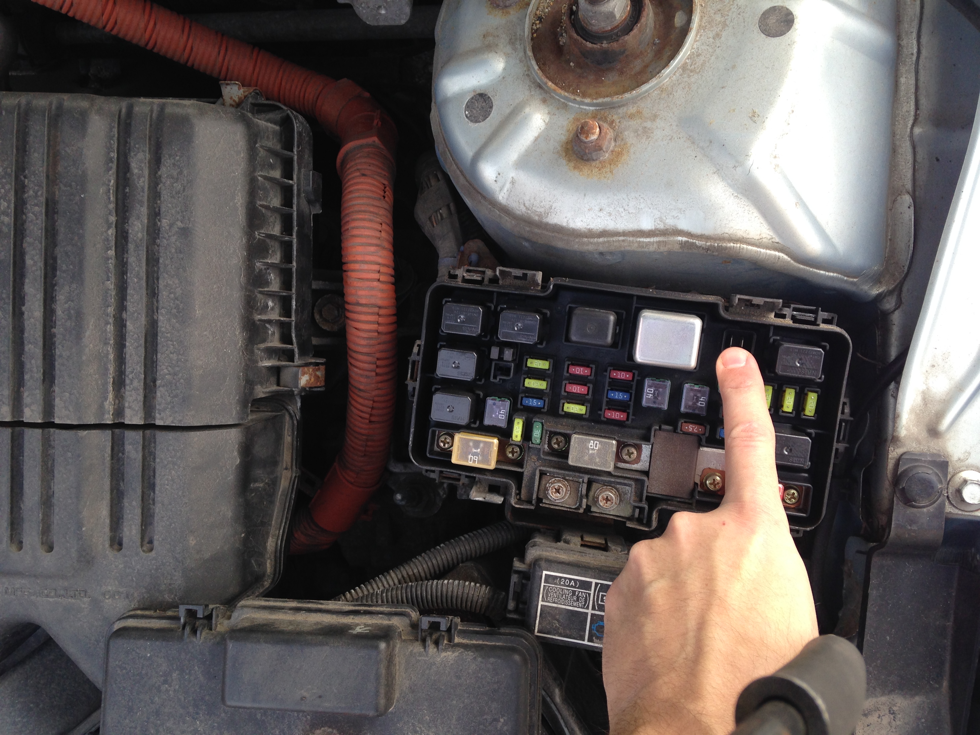

Old Jan 29, 2016 | 09:08 AM
tinsley207's Avatar
Joined: May 2015
Default Re: HCH-1 Rear defrost "auto on"?
Update. I located the fuse and pulled it and the behavoir goes away. The rear defog does NOT come on. Put it back in and the problem comes back! So I'm thinking at this point its a stuck relay? I'll investigate further and repost. Here is the location of the 30 amp fuse, it's in the main fuse panel, under the hood, right side.

Old Jan 29, 2016 | 09:11 AM
I stand corrected. Good work.
