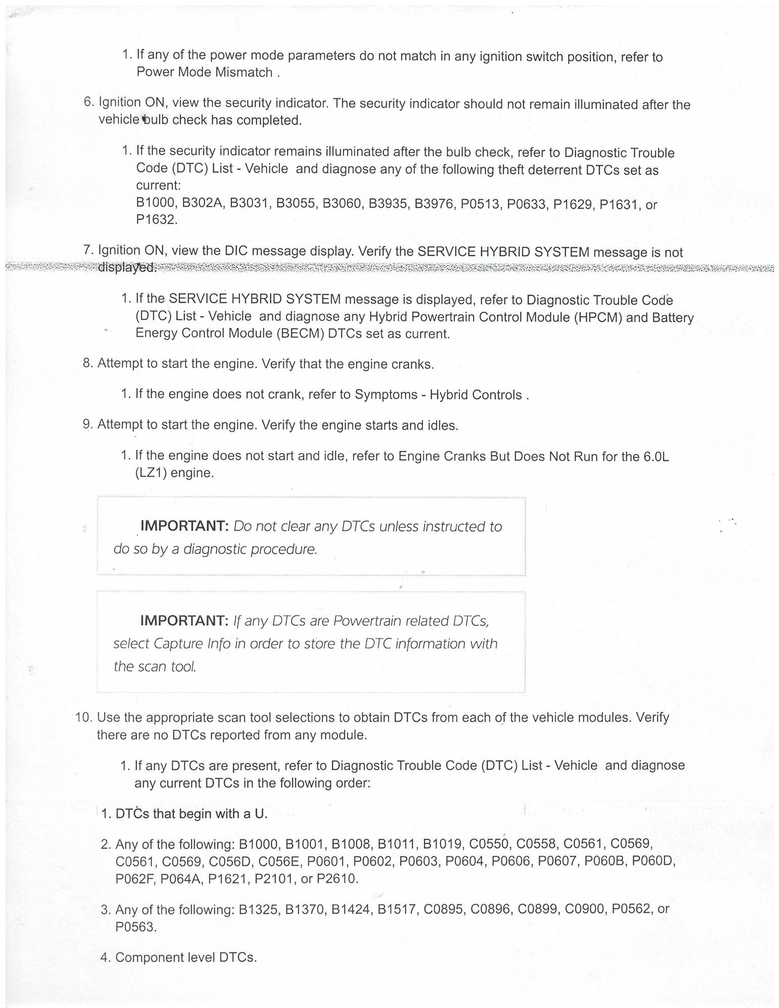

I have a diagnostic walk thru if you'd like to see it. pm me an email or something and I can try to send it.
Keith, these might be good for a sticky in this forum if that's allowed. since there's a lot of no start posts. it's a walk thru of enabling the high voltage side.

try this zip for the code.
hmm, Keith would know better, but count from the fan side to the #11 module. 2 cells per module. I think 11 might be the one that has wires on the back that connect to the orange safety plug to complete the loop? atleast that's 11 of my truck. but I have a little different setup.
