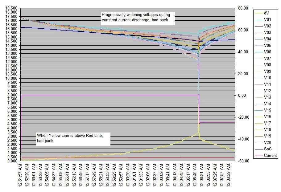

S Keith, Can you take a look at these battery stats?
Bank 9,10,11 have single samplings with huge drops with 4 to 7 volts.
It was to cold today for the AC to kick in so mostly defrost and headlights and fans. I couldn't get down past 42 without the autostart recharging.
Would it help to put a charger on the 12V during this testing to delay the autostart to charge the 12V?
Should I replace the cells in banks 9,10,11 with known good cells (Anyone have a good source they recommend?)
My Total Voltage isn't appearing in Torque Pro, should that work? I imported the PID list at the beginning of the thread.
Thanks in advance. Chasing the Service Hybrid Message with subsequent stall after autostop.
Pete
File Type: csv
Old Feb 6, 2022 | 04:09 PM
  #56
Default Re: Torque Pro Custom PID and Battery Test Results
Bad pack. Auto-start is not caused by 12V but because of the horrific HV battery condition.
If only 9, 10 and 11 needed to be replaced, you would see all 17 of the others tightly bunched with those three out. Since you see a "fan pattern" with all blocks spread somewhat uniformly from min to max, your pack is the typical **** pack at the time of failure due to horrific GM battery management and cooling system issues.
Replace all 40 modules. Not kidding. No other option. Any attempt to replace less than 40 with known good modules will result in a short term solution.
