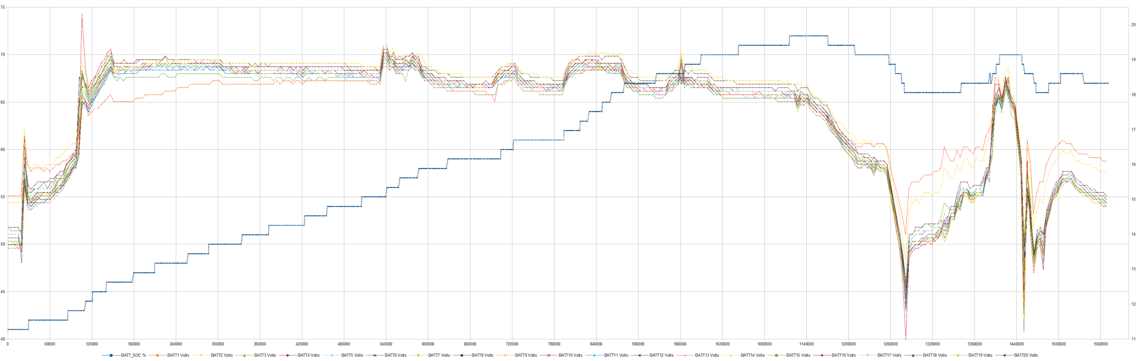

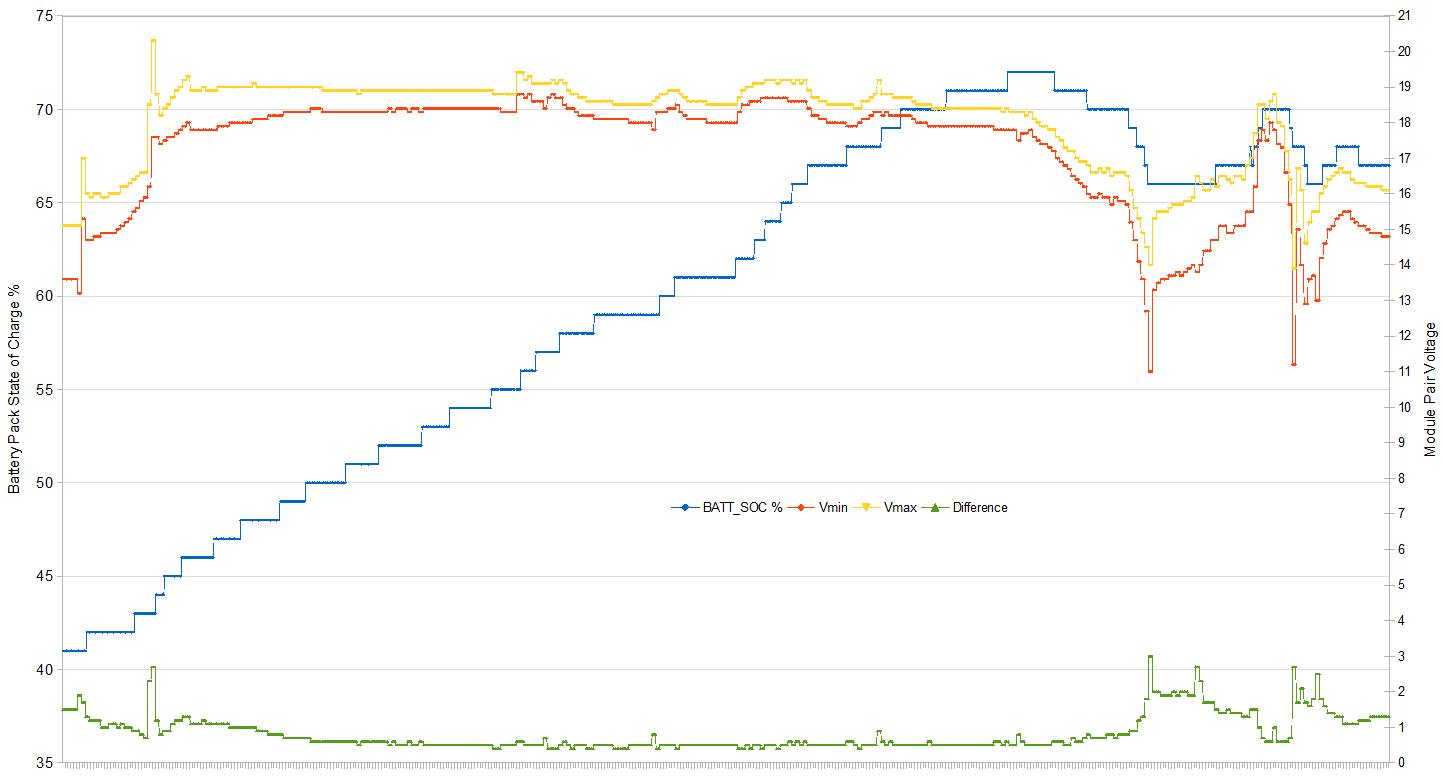

I took some voltage readings from the 20 battery module pairs in the battery pack to confirm that the battery pack is bad.
It started out at 41% state of charge and the Tahoe did not go into Auto-Stop mode until it reached 72% state of charge. I revved the engine during the charging as you can see by the voltage spikes as the State of charge rises. Once the Tahoe went to electric only at 72% SOC, I drove it slowly up a long, slightly uphill, driveway. Then the gas motor turned on and I put the gas pedal to further down to use the electric power assist during acceleration.
How does it look to you? The largest voltage difference between the minimum and maximum module pair voltages was 3 volts at one point. Does this confirm a bad battery?
I don't have GM specific experience, but given that the pack is manufactured by Toyota, and it uses the same internals and the same voltage monitoring methods and presumably at least a variation on the same battery management as every other NiMH-based hybrid, I would conclude an absolute yes, your battery is bad.
Generally speaking, even under heavy currents, the deltaV between min and max is typically less than 0.6V. Under low currents, <20A, less than 0.3V, and at rest, < 0.2V but tpyically less than 0.1V for a truly healthy battery.
Do you have current data, and can you provide access to the raw numbers?

The 3 volt delta is not good. It should be down where S Keith said
Old Mar 30, 2017 | 10:11 AM
Default Re: Please review my battery pack data
In short, if that voltage data is correct, your pack is bad or severely imbalanced.
Generally speaking, that's one of the messiest group of block voltages I've ever seen, and I've seen some **** shows, which kinda brings the data into question.
Block 1 swings from the minimum to the maximum by a large degree.... almost certainly a sign of a failed cell.
Near constant voltage with climbing SoC from 45-60 is weird.
Voltages plummeting to the 11-12V range with deltaV exceeding 2V and small drops in SoC is very irregular.
Causes:
Bad battery.
Sensing issue (block voltage harness)
Bad data.

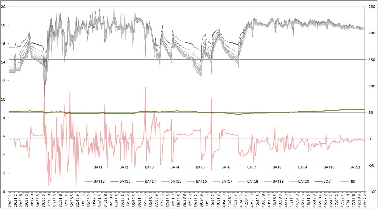

I took some more data today. This time I used Torque Pro on a tablet instead of ScanXL.
I am not 100% sure about the battery current equation I used since the one I had found online was not correct (was giving obviously bogus data with current values over 3000A) and I modified it. I ended up with current values that seem more reasonable.
The attached line chart only shows data from Rows 1324 to 2017.
Also, I don't know if it was a coincidence, but as I was capturing the data, the check Engine light turned on and the P0BBD DTC was recorded.
P0BBD = "Hybrid battery pack voltage variation exceeded limit"
Attached Thumbnails Please review my battery pack data-module-voltages-current.png
Again, if your data is good, your battery is bad.
The code would seem to confirm it. There is no reason to think it's a coincidence.
ALL
data presented thus far says your battery is bad.
FWIW, it's the worst battery I've ever seen - by an almost unbelievable amount, which keeps bringing me back to the accuracy of the data.
It's like this.... There's like a big bucket of bad batteries. The best of them settle on top with the worst on the bottom. Yours is in the outhouse under a weeks worth of excrement.
It's so bad, I find it hard to believe that the battery management system would even utilize it to any significant degree. If that Toyota battery were in a Toyota car, it would essentially be disabled, and you'd be in permanent limp mode if the car would start at all.
All of the above again leads me to question the accuracy of the data. Additionally, I see a current value of 211A. I'm pretty sure that's not possible.
Concerning the chart:
When you look at 0.5V spaced gridlines for the Y axis, it's pretty rare that they stay within that range even with very low current.
At the beginning of the chart, there is basically a 2.5V delta with almost no current - that's stupefyingly terribad of epic proportions.
You either have bad data or a battery that is so much worse than the worst I've ever seen, it's likely the worst one on the planet. Well, the 2nd worse. I actually have a Gen1 Prius battery that holds that title - the victim of a mechanic thinking he could "shock" the battery back to life with his welder.
